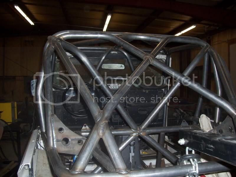

and poetters cage and **** looks blingin & bangin. I like the **** out he windshield from the backside. Whats it look like from the profile?
and bring it with new dodge pics

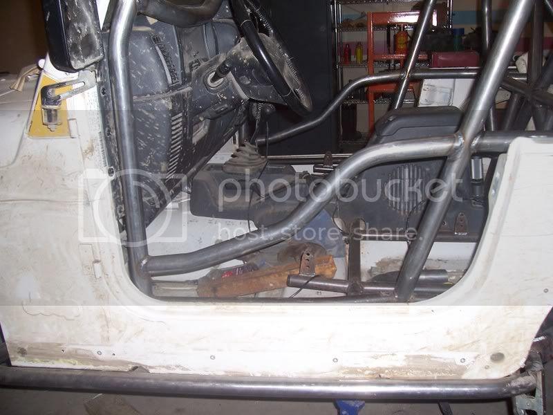

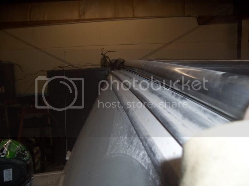

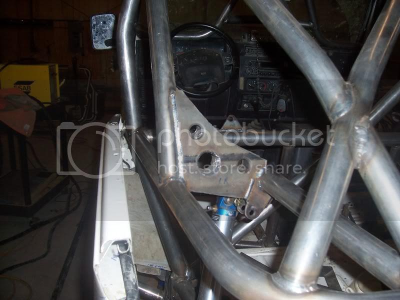

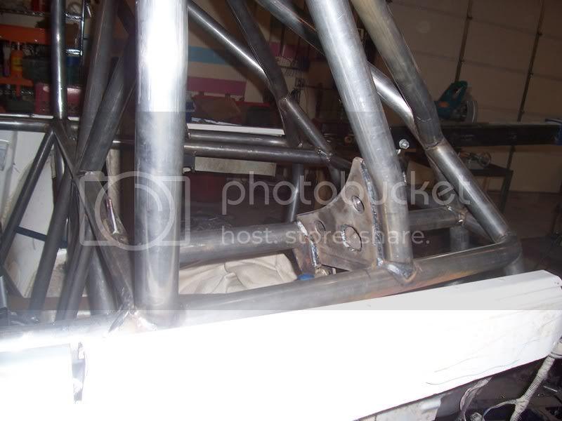

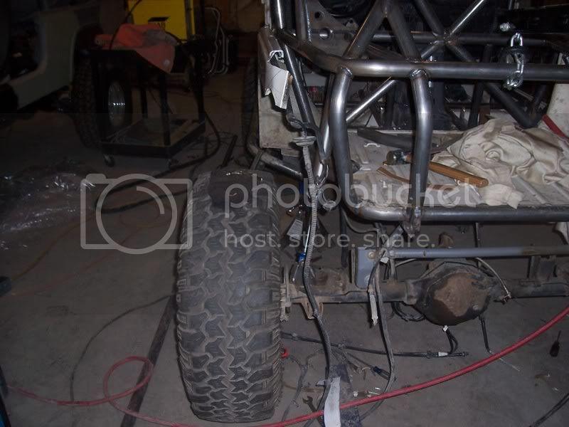

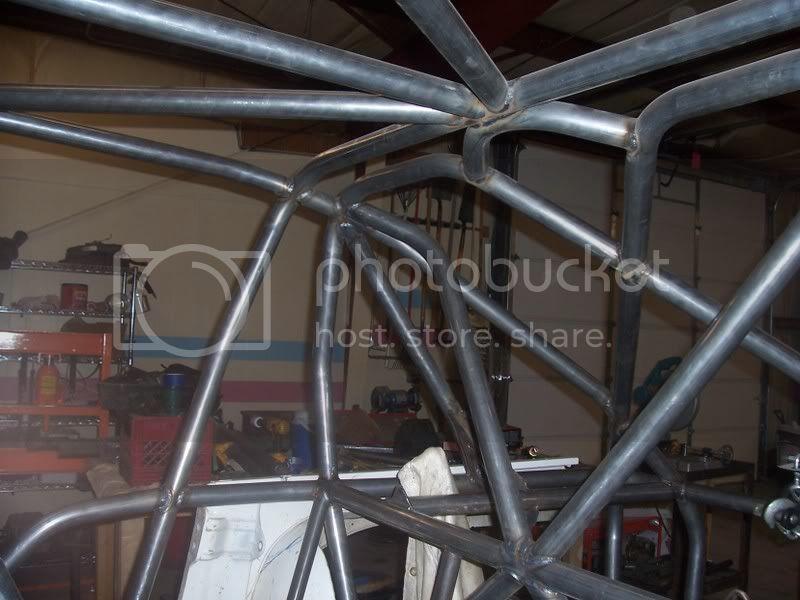

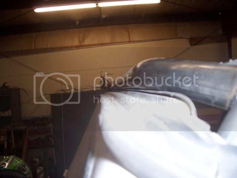

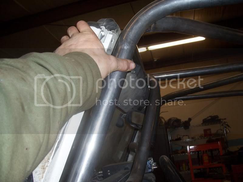

got it finished up (my part) and here are the pics. he still has to skin everything and mount the cell/run lines, all that ****.
the tube in the last 2 pics (brow bar) is just tight enough that the window rubber squeaks when it goes by it and sits behind center of the tube when locked in place. now when the top is skinned it will shed water forward and onto this drip ledge instead of putting the brow bar behind the window and having it piss water on your dash.
