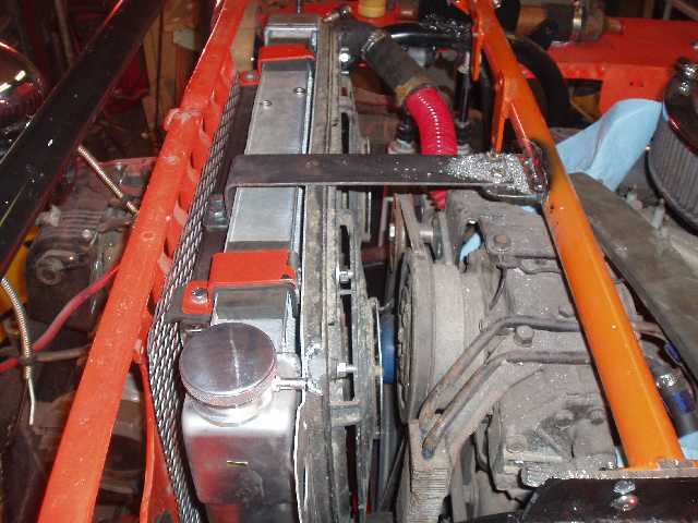

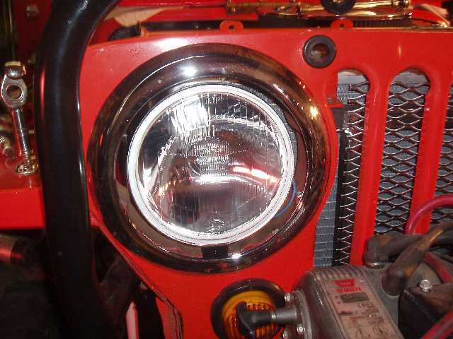

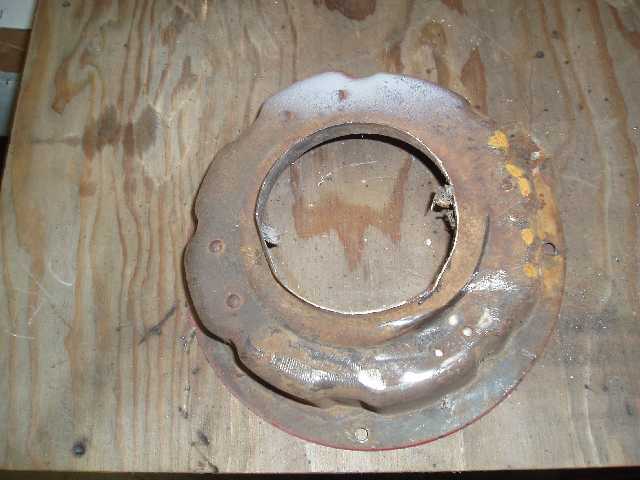

Been working on getting the new radiator mounted which of course meant rebuilding half the front end of the damn jeep :haha: This one fits real nice and I even managed to gain a little more clearance from the AC compressor:D But of course by moving it forward now my headlights dont fit so I picked up a pair of thin hellas and made them work. Came out looking ok. Just finished taking it all back apart again to gett all the pieces painted up purty then I get to put it all back together again...... Really hated to cut up the headlite buckets as they are damn hard to find but oh well :booo:
