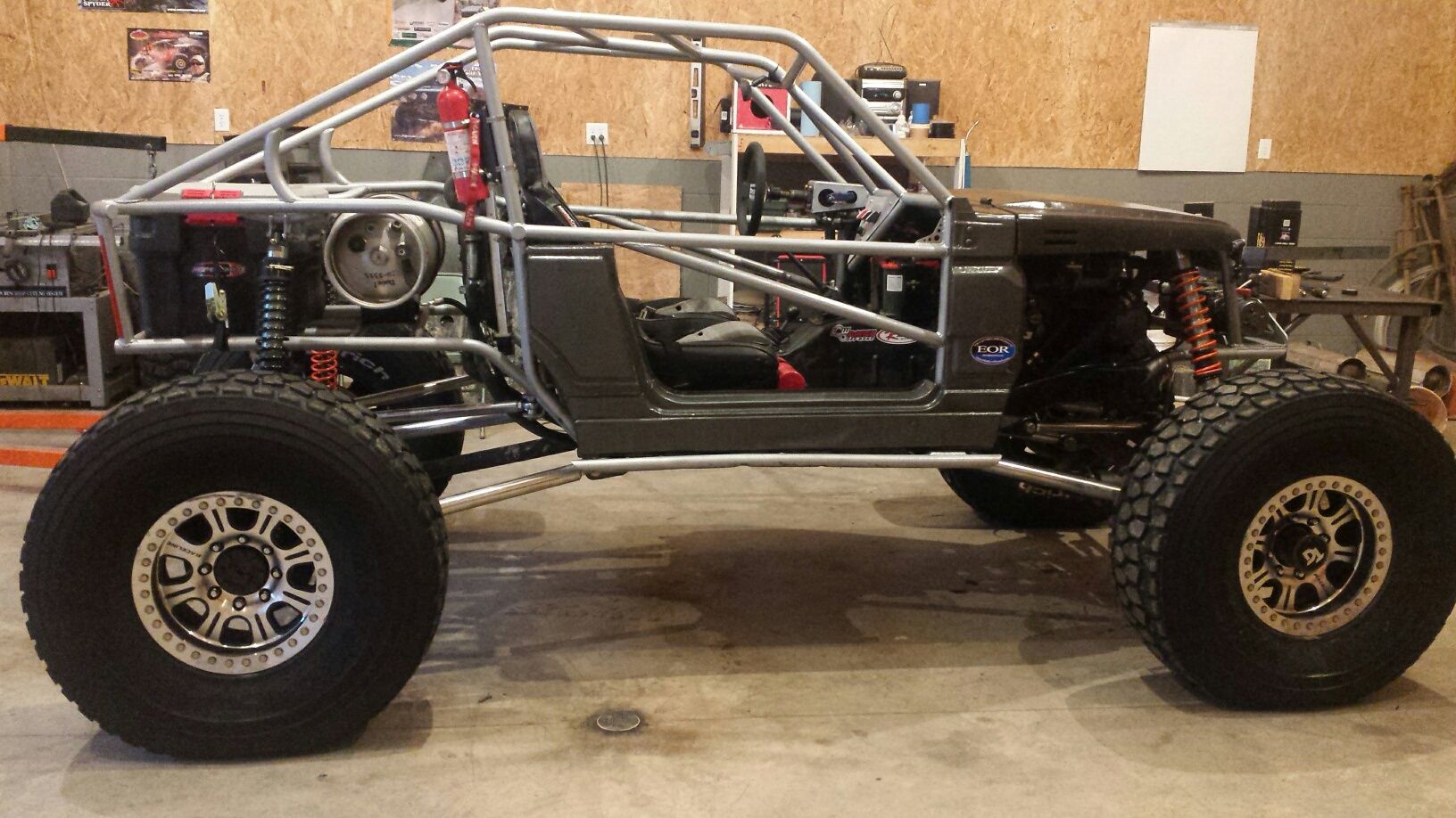

little update - swapped out the Trail Tough Mighty Kong T-case mount for the Low Range Offroad E.O.S. mount
ended up putting tender coils on the rear which allowed me to drop the rear about an inch
added some door bars which i really like, feels a lot safer now and added some additional roof support
time to swap in the 1.6 now, plan to start disassembly this weekend

Looks great! I know I was really happy once I added the door bars to mine. I had gotten tired of that corner of the door opening stabbing me in the arm...now the door bar serves as my armrest.
Swapping in the 1.6 shouldn't be much work on yours since you're running pane...I'm currently wiring up my 1.6 EFI.
Haha I thought it already had the 1.6 in it. I told one of them guys that was watching you beat it on that slick spot that it was a 1.6 lol. They said "man the motor in that thing does really good for what it is, it that the 1.6?" I said yeah I believe it is haha….oops
Diggin the new door bars. Kinda completes the tube work IMO on this one.
