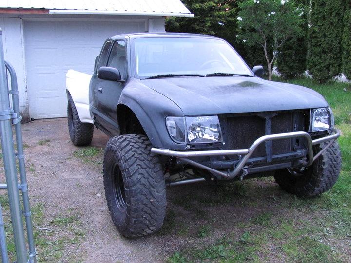

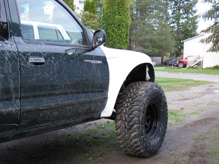

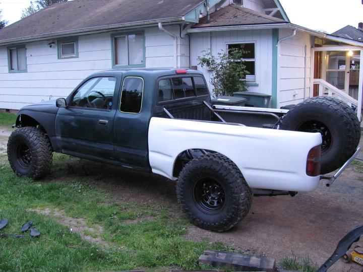

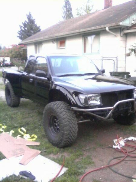

Here's some of em.....That things come along way since it was a gleam in yer eye when I picked up the axle.:awesomework::beer:

yes its a DD and thanks for all the props, i should have some good pics of it in the dunes MD weekend, and its pretty fun to drive on the road...got a little adjusting and tuning to do but for a first time building A-arm suspension it drives pretty damn nice. OHHHH and i wieghed it today:D can anyone guess what it wieghs and what the wieght ratio front to rear is? i was blown away!!!:beer:
ok so im not gonna sit on here and wait for guesses hahaa total wieght was about 3500lbs the front at 1900 the rear at 1600! 300lbs heavier in the front that was way better than i thought it was gonna be, i figured nose heavy. i think it would be easy to transfer more wieght to the rear and get it 50/50, im sure it will jump awsome.
