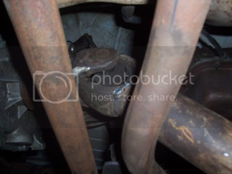

some random shots of the shaft and 25 minute crossmember.

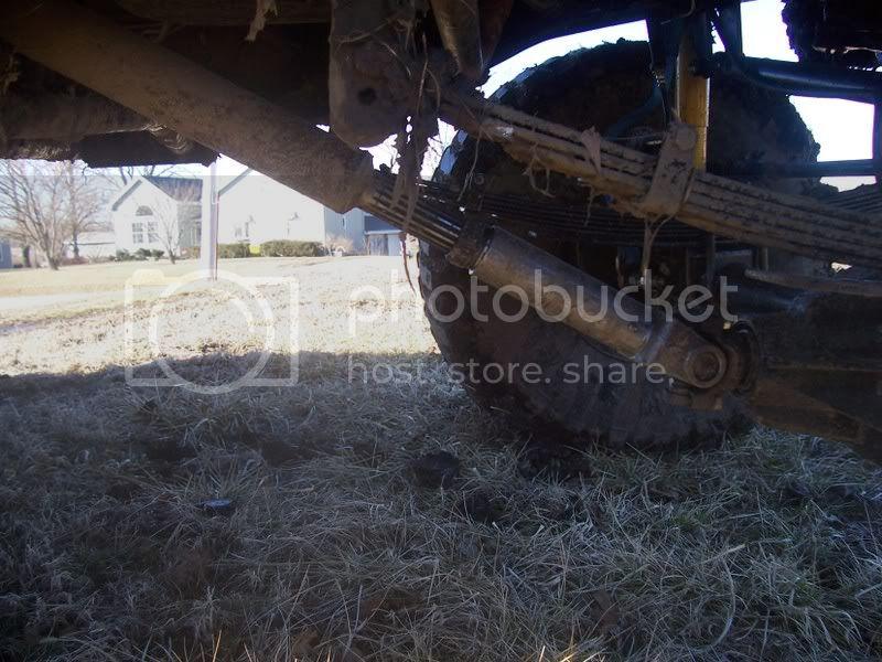

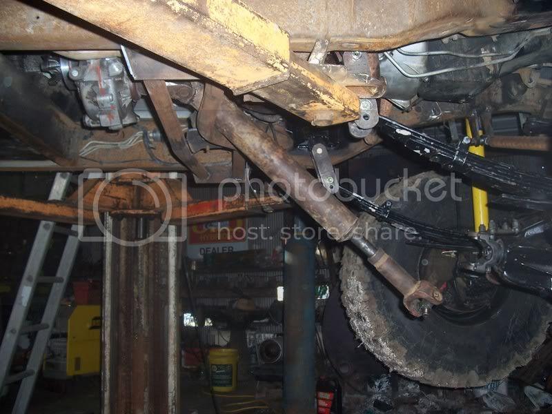

Steep but once the wieght is on it, it wont be unbearable. you think this will be better than a CV? I know its way cheaper, but the 1310 is going to be swinging in a serious speedup, slowdown, speedup, slowdown arch.

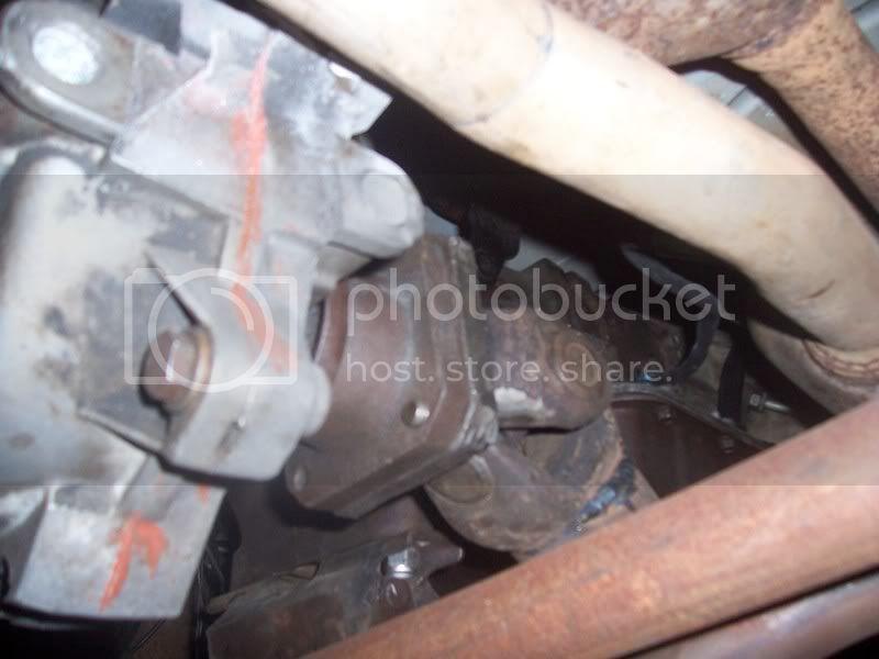

that shaft is hanging WAY below the pinion on the 60. the 60 is at full droop on the strap and the shaft is inches below it not hooked up. the shaft is currently a 1310 slip and he bought a 1350 yoke for the 60 that we put on. when the long 1350 slip gets here I'll make a shaft with 2.25" tube and a 7" travel spline and cut the larger tube off the 1480 yoke at the top for the smaller tube. I am still impressed with the angle those 60 driveshaft yokes have.
yes a cv is better, but not stronger than a 1480. you know how I know? because there are 1480's in the axle just downstream under 4.56x the torque and at the same angle when the wheel is turned thumb.gif

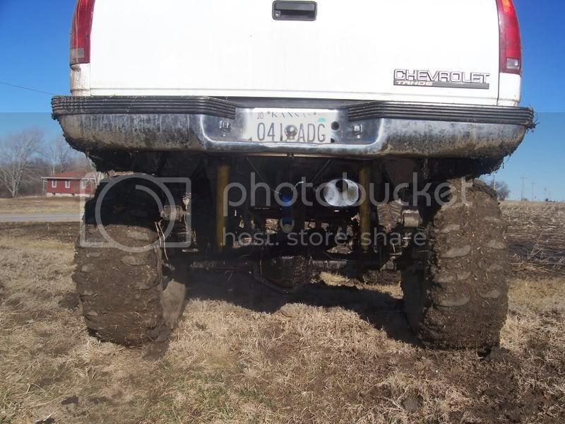

Is he gonna wheel wheel this thing or just party cruise it ? Its coming along man ! how about an overall shot of the big rig
Done. He's driving it home again today. took it out last night and tried it out. the long slip front is a great deal for $150, 9.5" of spline, 1350 forged yoke that's extra deep and allows the flex of a 1410, and is tight and sealed. The rear cv 1350 40* is sexy too for the money. I got the smaller tube front done and the 1480 cut apart and put back together with the 1 ton stuff. With that angle there are some good vibes out of that front, but it's tolerable....moreso than a $350 cv laughing this one cost him $50 with my labor thumb.gif
Its not my thing, but he was smiles from ear to ear. the reason the wheels are different is because the new boggers are on front with my old black 14" wide barts, and my worn out boggers are on the back on the faded AL 12" wheels. the other 2 new boggers and black wheels are in the back of the tahoe because they each ahve a cut in them.
