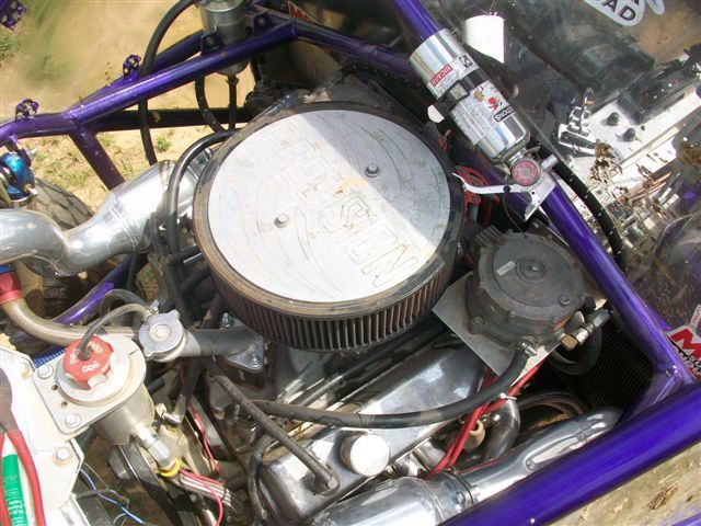

A high horsepower or high rpm engine will not perform properly with a single mixer. The photo is of a 383 stroker with one of my fuel systems on it. It dynoed at 630 hp on gas and 565 on propane. It ran in one of the off road competition series and did well. It had a strong flat torque curve of over 500 lb.ft. starting at less than 2000 rpm and stayed there over 6500 rpm. This is using technology that is 50 years old.
A single mixer is equivalent to running a two barrel gasoline carburetor on a V8.
It all comes down to the engine being properly set up and all components working properly. We discovered an issue recently while converting some Ford V10's in F650s with the engine going lean in a hard pull. It turned out to be a fuel starvation issue caused be restrictions in the fuel line fittings. The 90 degree fittings on the fuel hose had smaller i.d. than the straight fittings and was slowing the fuel coming from the tank. We had to remove all the angled fittings from the fuel lines to correct the issue.

I ran dual 425s on mine and it did great till about 6500 then started lean popping, i have a stroked 454 with a big solid cam and 14.5:1 compression, I just don't think I'm getting everything out of my motor i can with 850cfm on a 500 inch motor so I'm switching to something a little different but i still like propane for the simplicity and easy tuning. Buddy knows what he is talking about on the propane man has been doing it since most of us were still shitting green.

The weather related problem with ignitions being wet really can't be blamed on propane. It has more to do with lack of ventilation(or weather protection) for the distributor. I was at a 2 day XTERRA competition event a couple of years ago with the propane buggy that I show the photo of the 383 stroker. On Saturday the weather was warm and dry but on Sunday a cold front came in and the temperature dropped and the humidity in the air was about 90% that morning. Several of the fuel injected rigs had trouble loading up even after they warmed up. One crew member came running through the pit area asking if we had a scanner. We told him no, we didn't need one since we were running propane. Tim reached inside the cockpit and hit the switch and it fired off without incident.
The reason they had issues with fuel injection was because they did not use all the sensors needed for the pcm to recalculate for the weather change. With propane this 50 year old technology adjusts itself for the change in barometric pressure without wires or sensors.
So who's selling the 2 mixers adapter that's being shown and at what price? I deal with propane on a regular basis(forklift industry) and can deal with it's quirks. I just need to determine if it's cost effective between the 2 mixer adapter set-up or regular injection.
