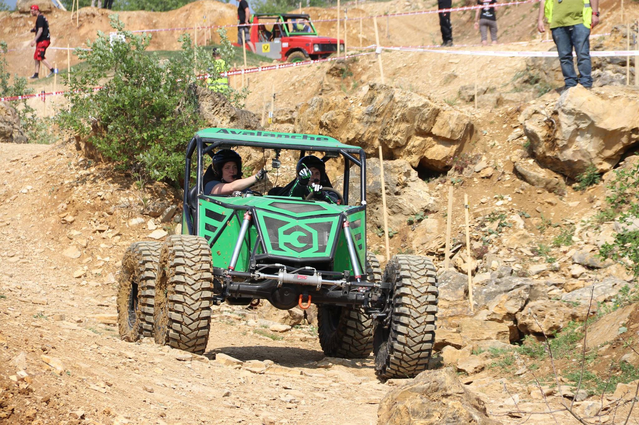

are the lights under the cowl to show you when the rear steer is centered? nice build, I noticed in one video it had some wheel hop in the front axle. Is that why you are doing changes?
Thank you. Yes the LED Lights indicate if the steering is centered. A pretty simple and good working way to get your rear axle straight.
We do some changes because of the overall width. We have smaller axles now, this is why we are driving with turned rims. Now we turn them as they should be and are going for wider axles. I hope i explained this correct ;-)
And yes we also want to do something against the wrong setup of the Air Shocks.
Time to update this....
Avalanche now has wider 404 Unimog Axles (with Portals), newly configured Airshocks and new 40" Maxxis Trepadors.
At the moment we are in the process of switching to Volvo 5-cylinder turbo engine insetad of the VW VR6. We also change the brake system completely because we had a lot of problems with breaks breaking when we did not want them to. Interested in more pictures?
