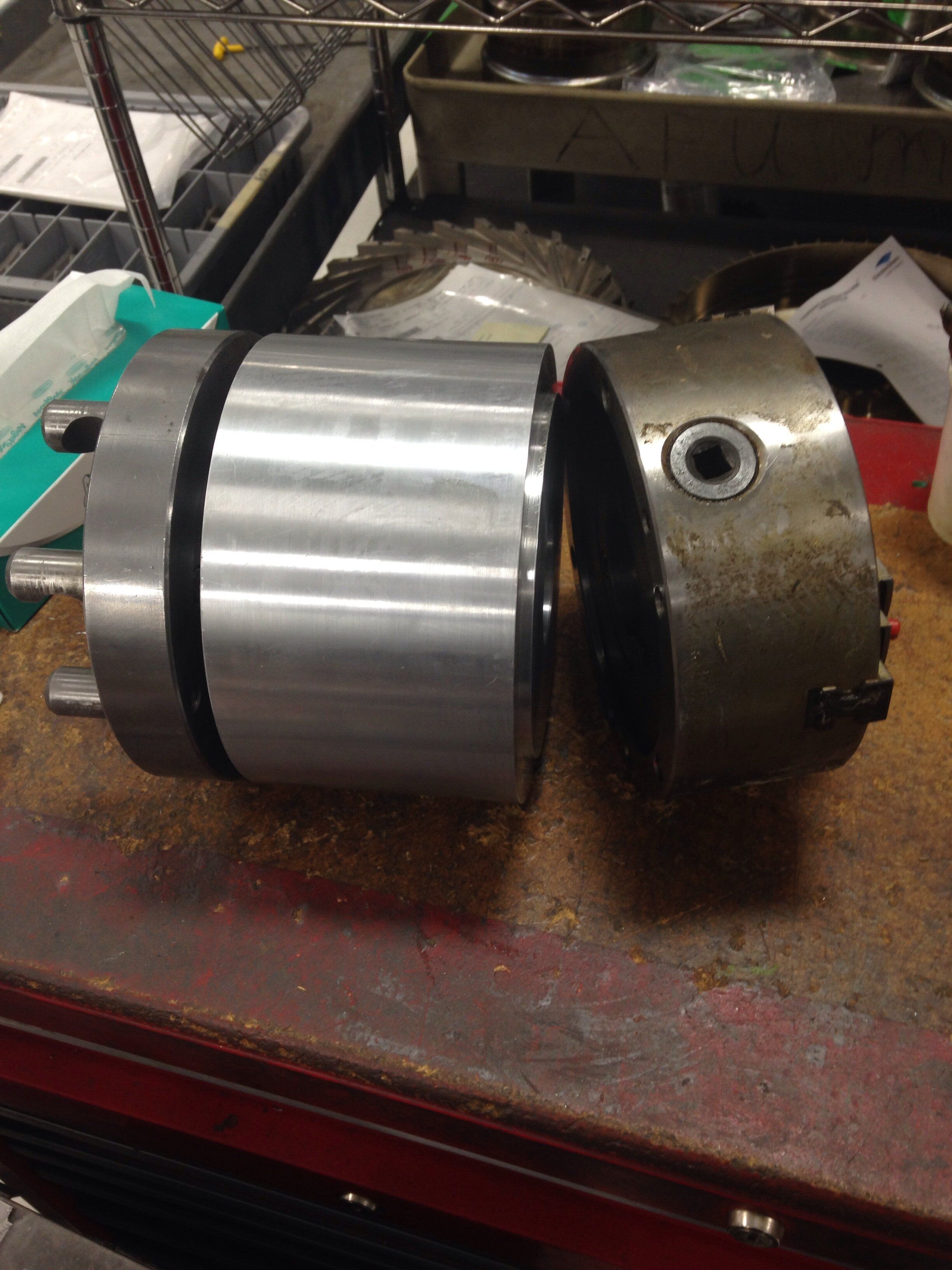

Here's a little project I got going, bought a lathe from work they got rid of it because it had some wear on the bed ways close to the chuck. So I made a spacer/adapter for a old 3 jaw chuck I had laying around
Clever. Shortens the bed length a bit but saves a lathe. I wonder if that much weight overhanging will affect spindle bearing life. Probably not appreciably. Good deal.
Prob shortin the bearing life alittle but for what I paid for it I could replace 50 bearings I think!!! Lol :****: seems to be a good tight lathe. I just wonder how it's going to act at HIGH Rpm's!!!
Ages later I've finally finished this repair / project and the chuck seems to spin very true now. But I have come to realize that the jaws are warped, something I understand is very common. That is to say that the inside of the jaws close tighter than the outside. I've read about true-ing jaws by opening them to clamp a round piece on the outside and using a boring bar to take a slight cut on the insides of the jaws. Think this is worth doing? Any other advice?
