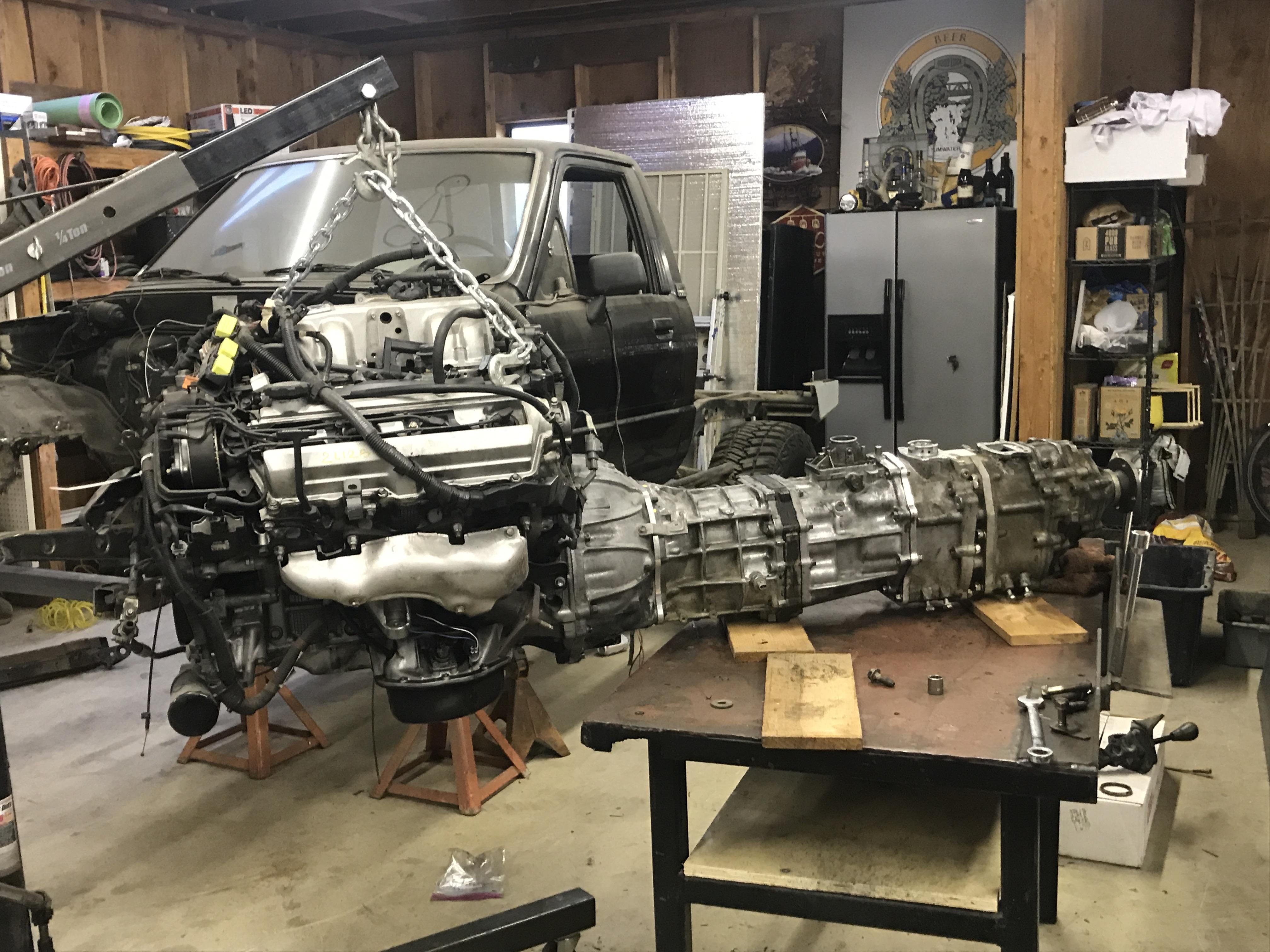

Pick N Pull had their 50% off sale this weekend, so I picked up some more junkard crap for the swap. I.E. the 1uz Bellhousing that I didn't have yet. Nothing like pulling a trans in the dirt just for the bellhousing.
Also shown is the sc400 in tank fuel pump (which I may or may not actually use), some relays with plugs, and some misc crap I didnt have yet.
Hopefully can get some time in the shop this week to start putting stuff together. Cant wait to get my gears in the mail for the trans so I can button that thing up.

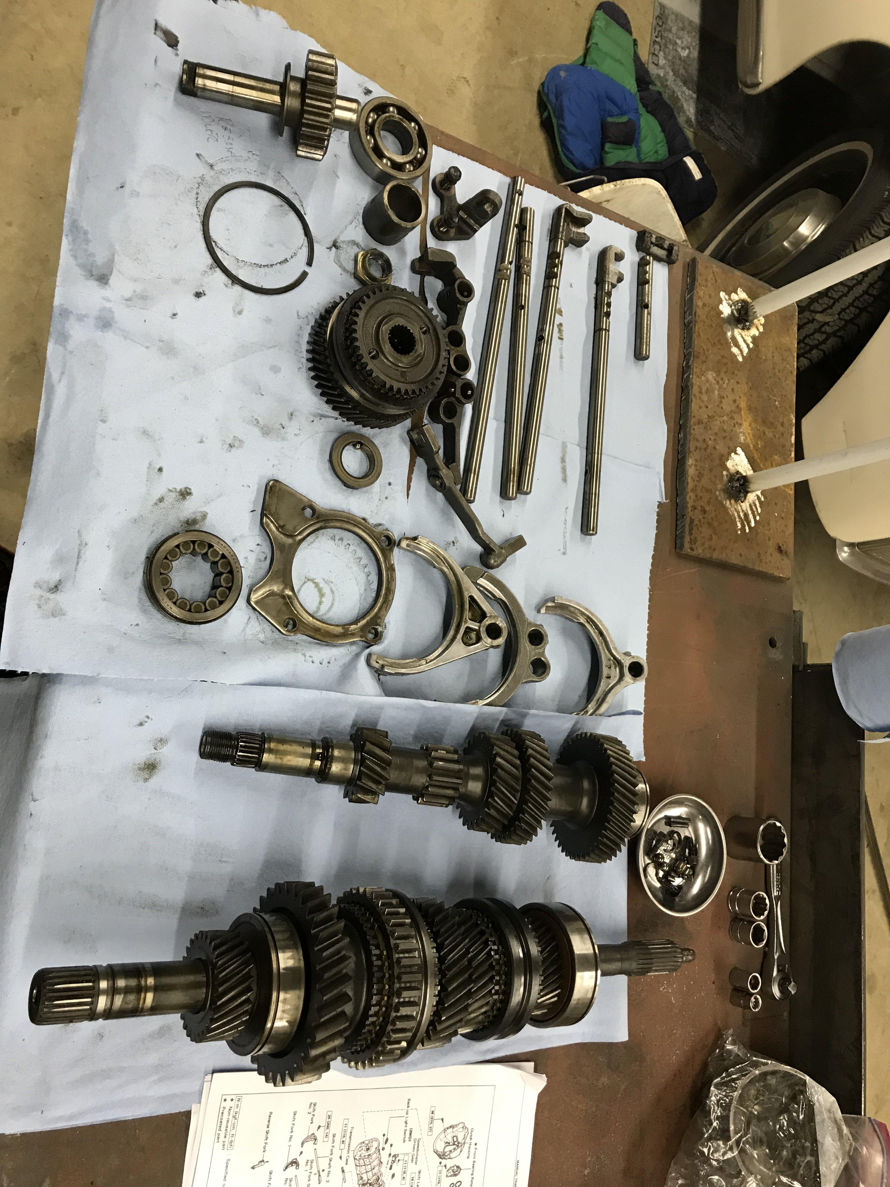

Higher overdrive 5th and full rebuild of trans completed a bit ago

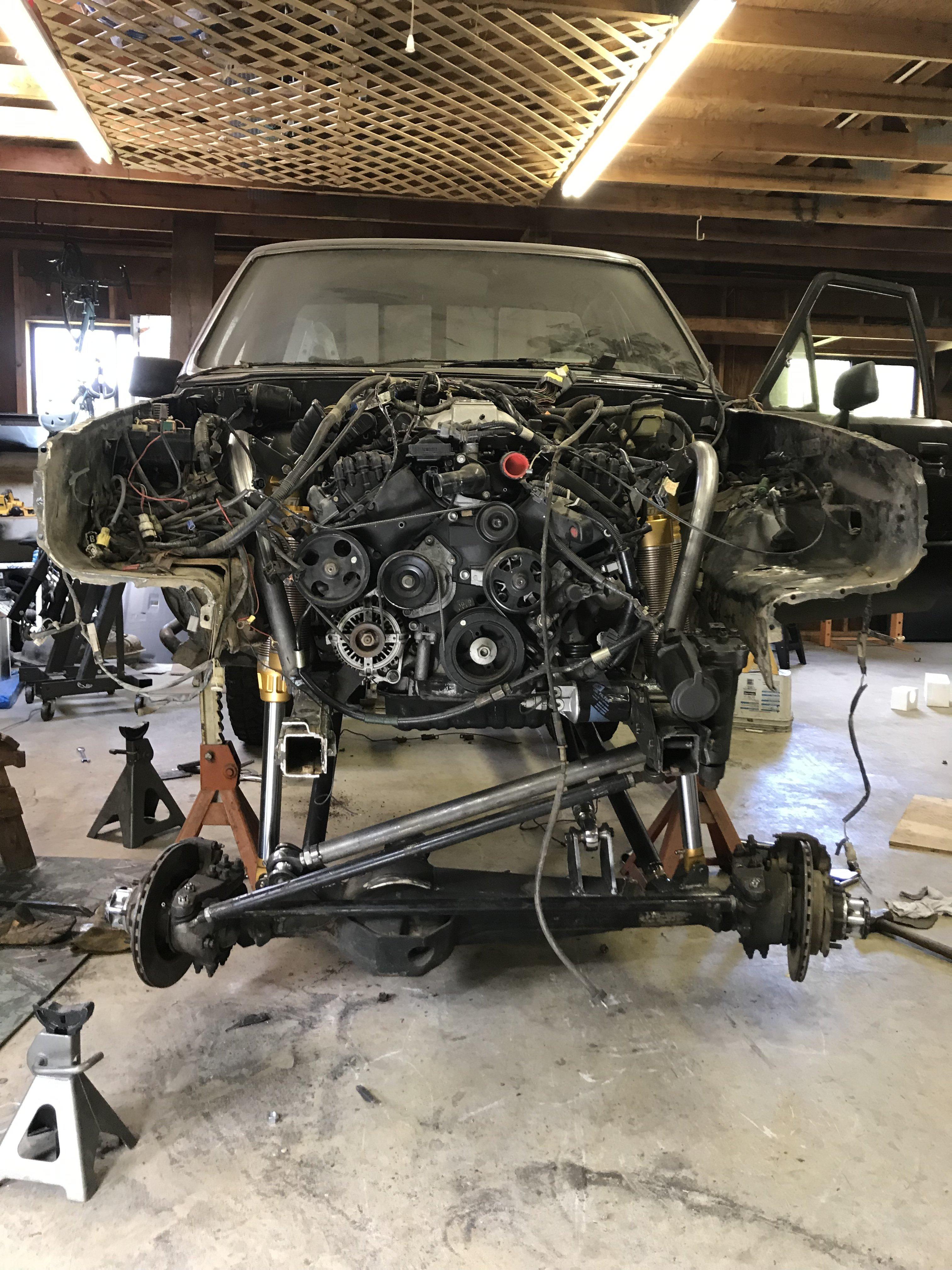

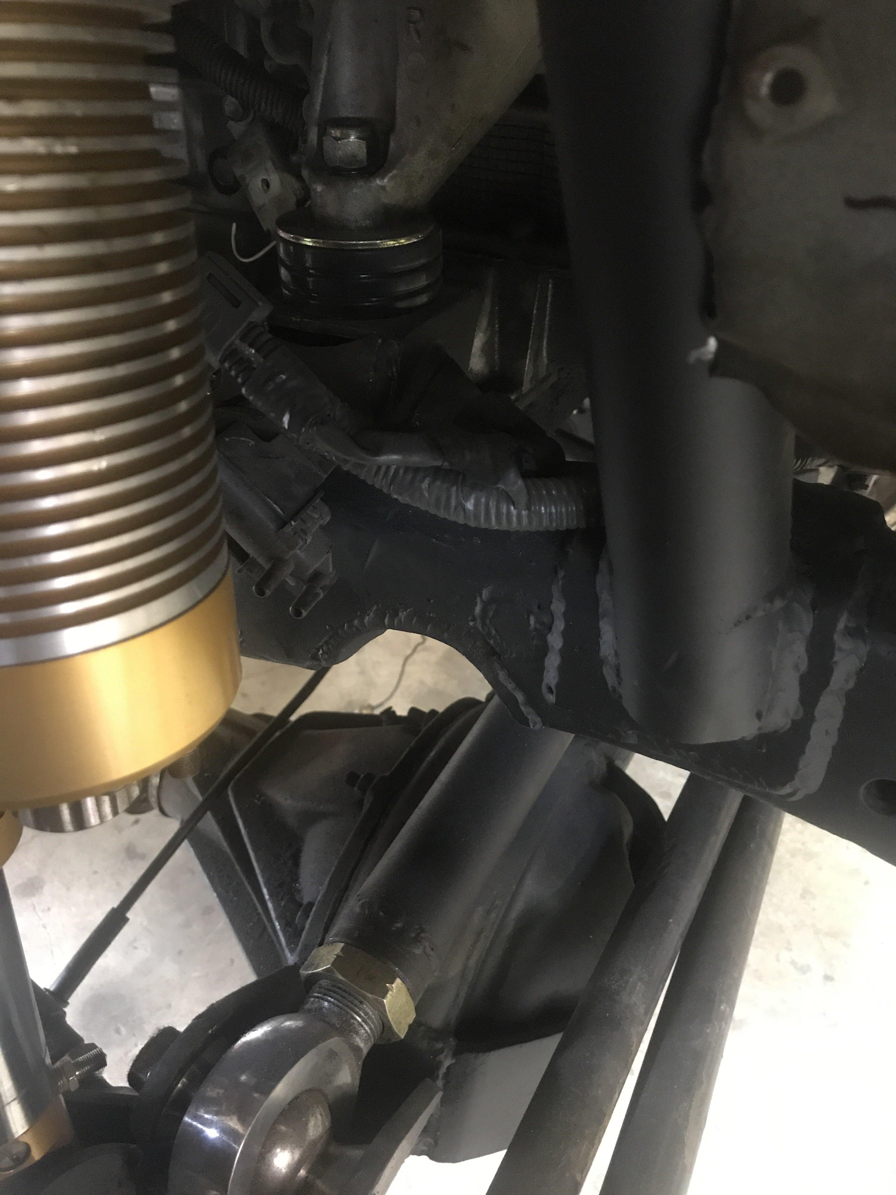

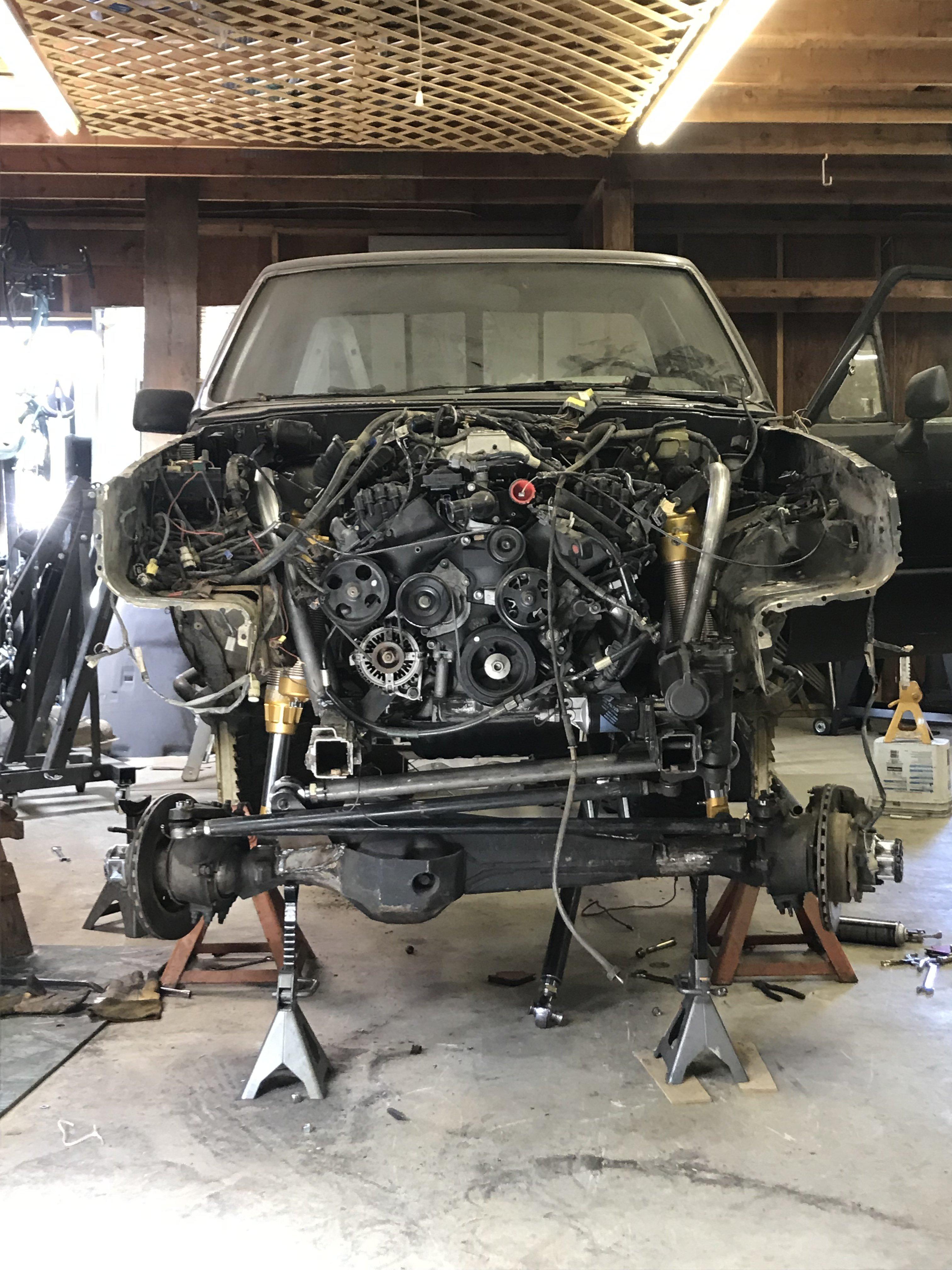

Then, front links and shiny ORI struts. Went with 14" struts. Also went with a huge panhard bar. If anyone ever reads this, go ahead and make fun of me, I can take it.
Only about 5" of uptravel. Hard to get more on 35" tires and keeping it as low as I can.

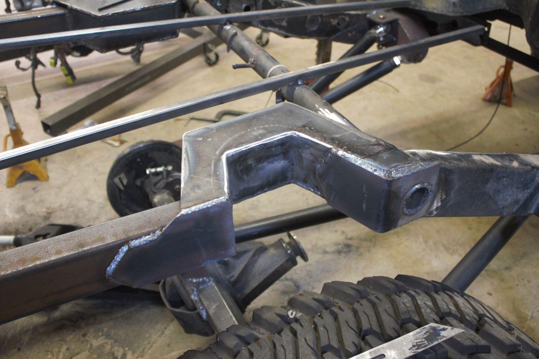

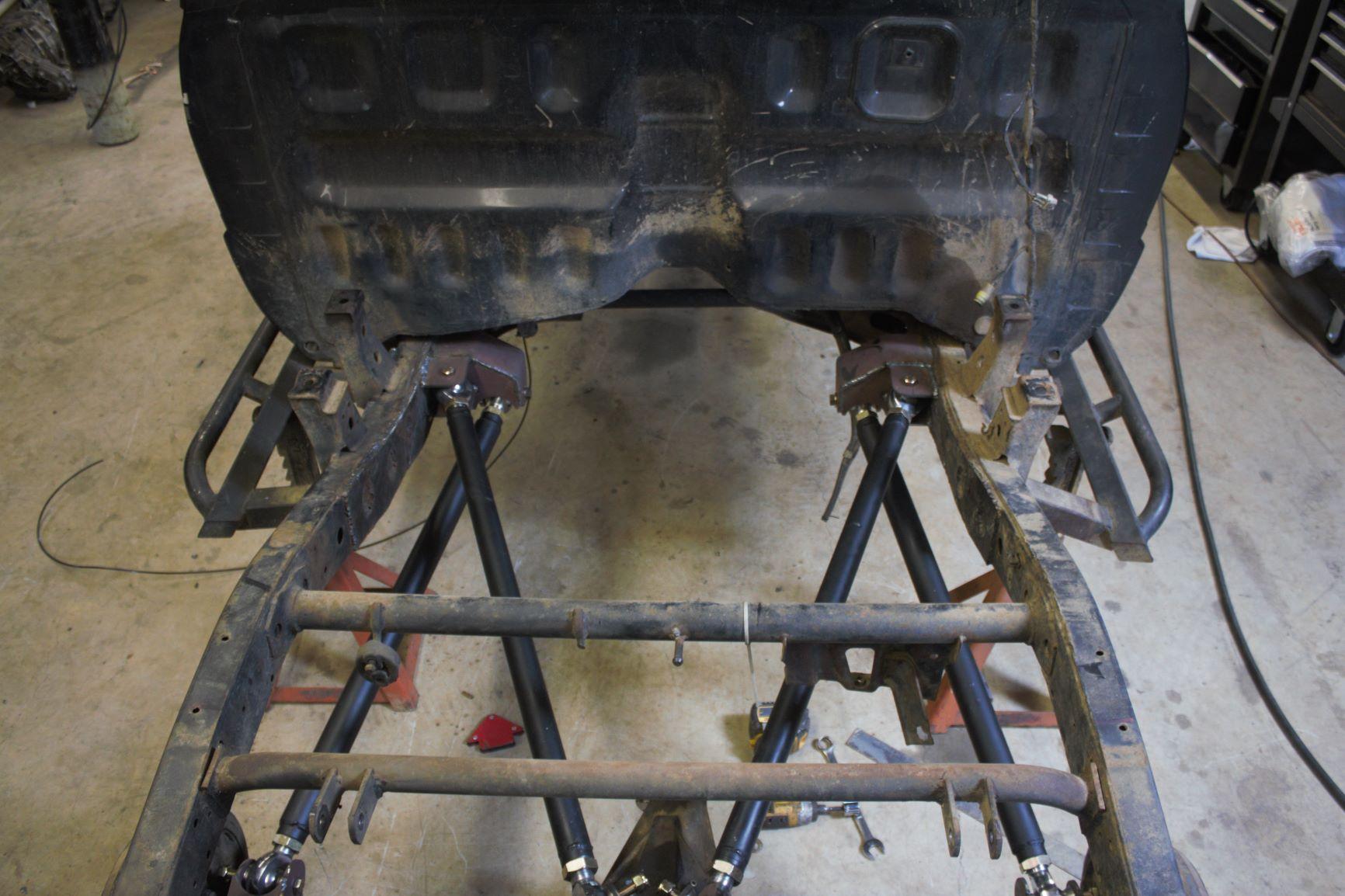

Had to notch the frame for the panhard at full stuff. Did every link end placement 3rd try. Plenty of re-do's and cutting stuff back off.

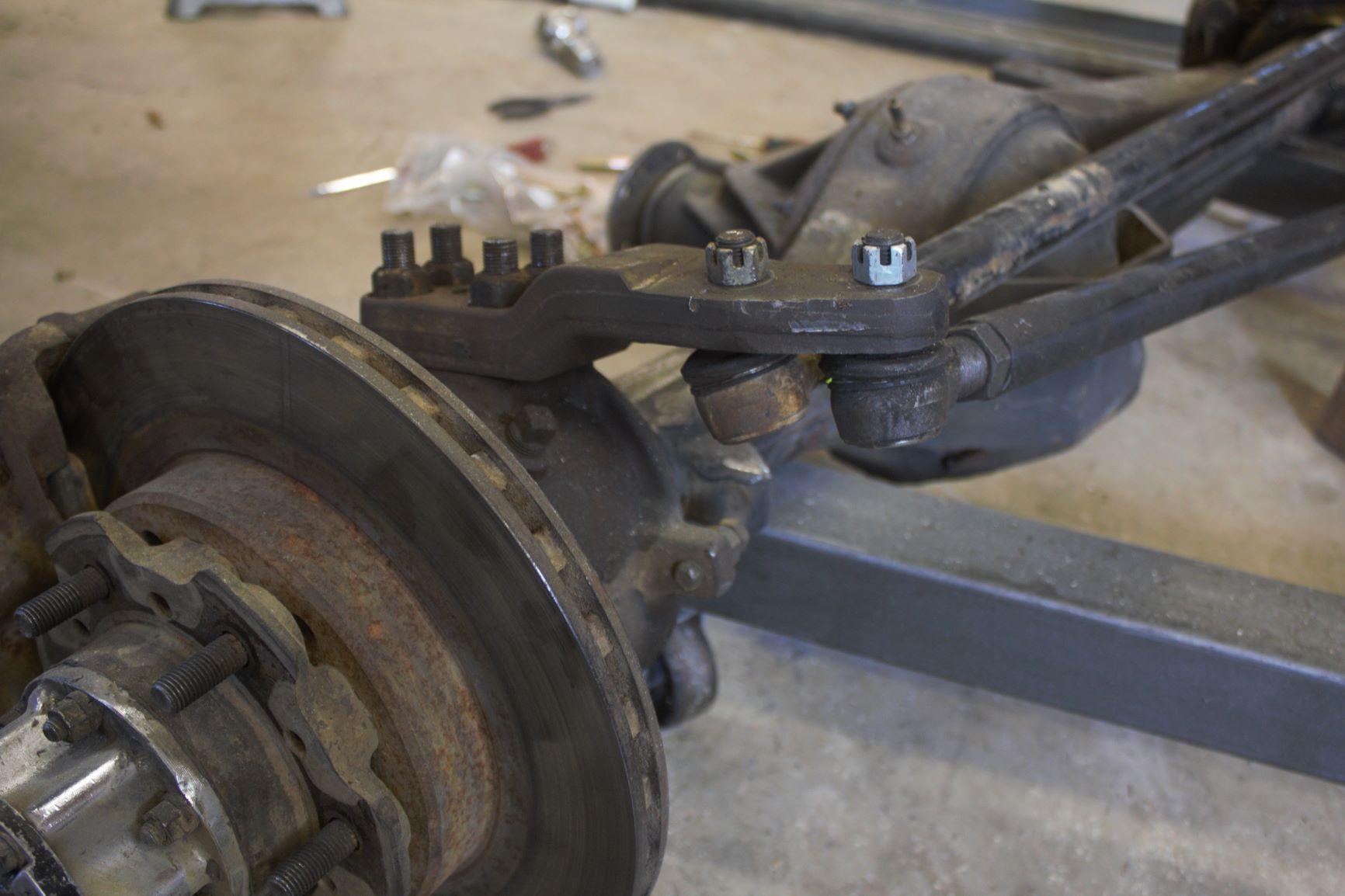

making room for uptravel, flipped the histeer to lo-steer. Time will tell if this was a stupid idea. I know muscle car guys double taper their steering arms so why not. IMG_7182.jpg

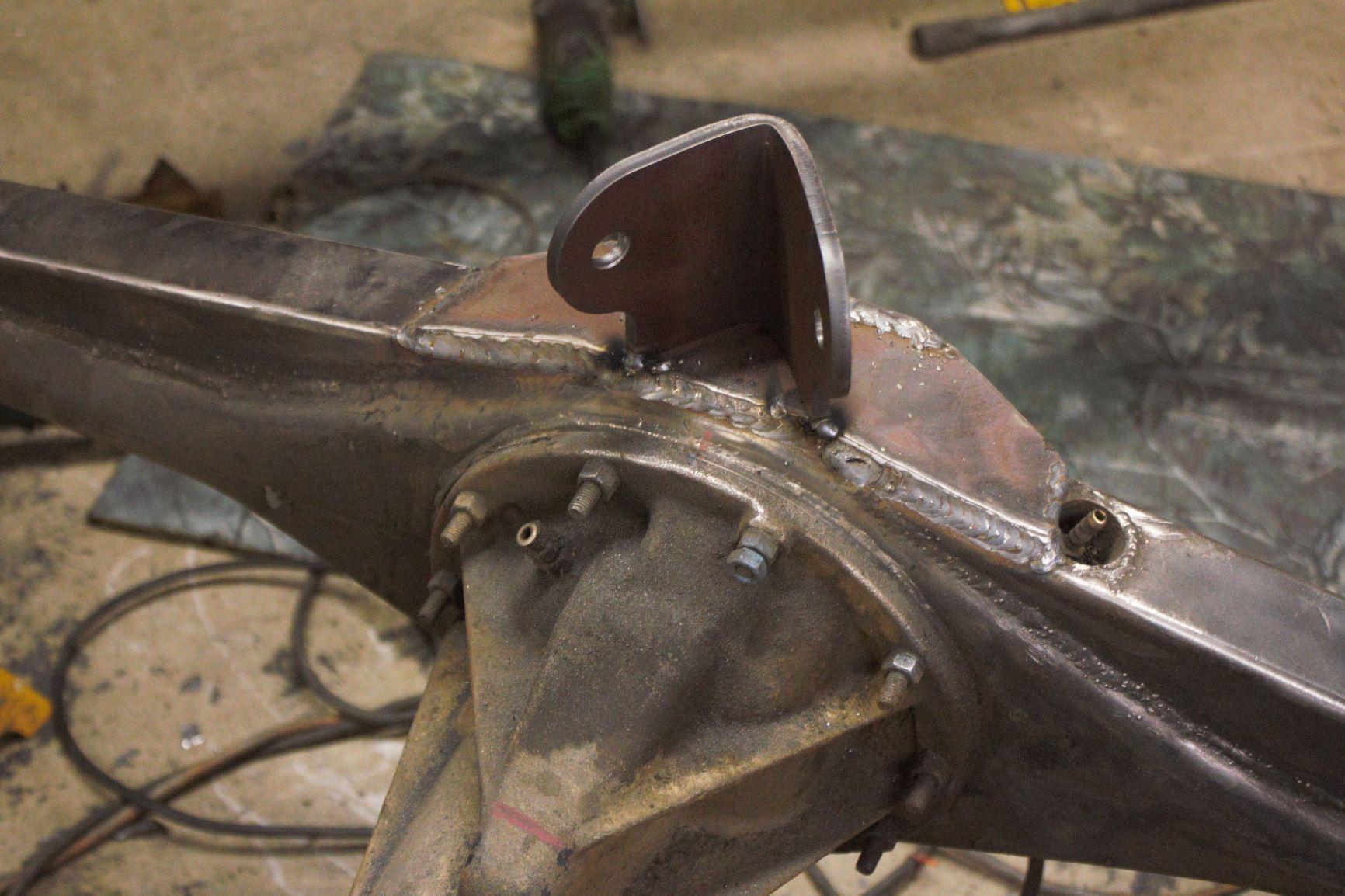

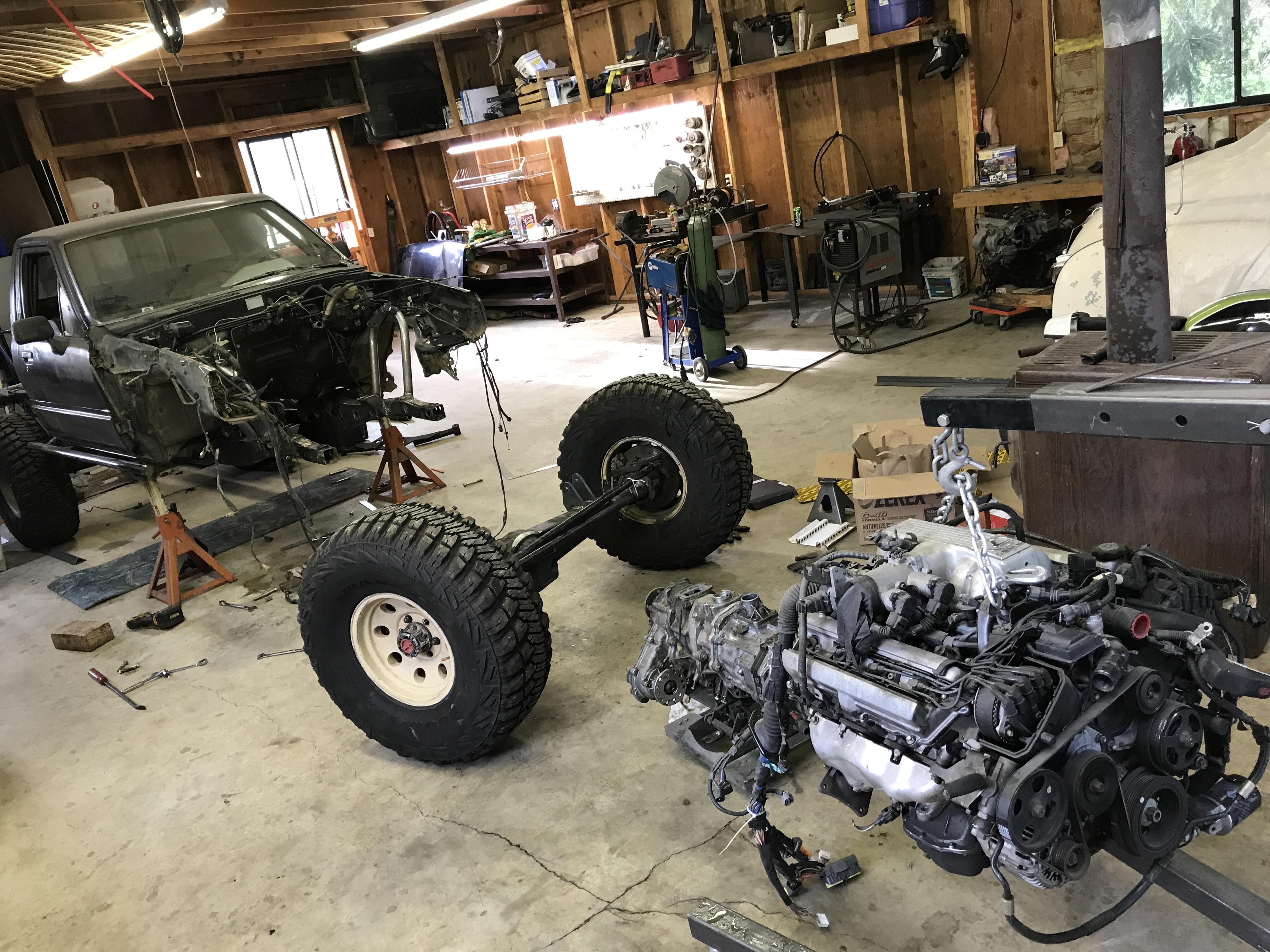

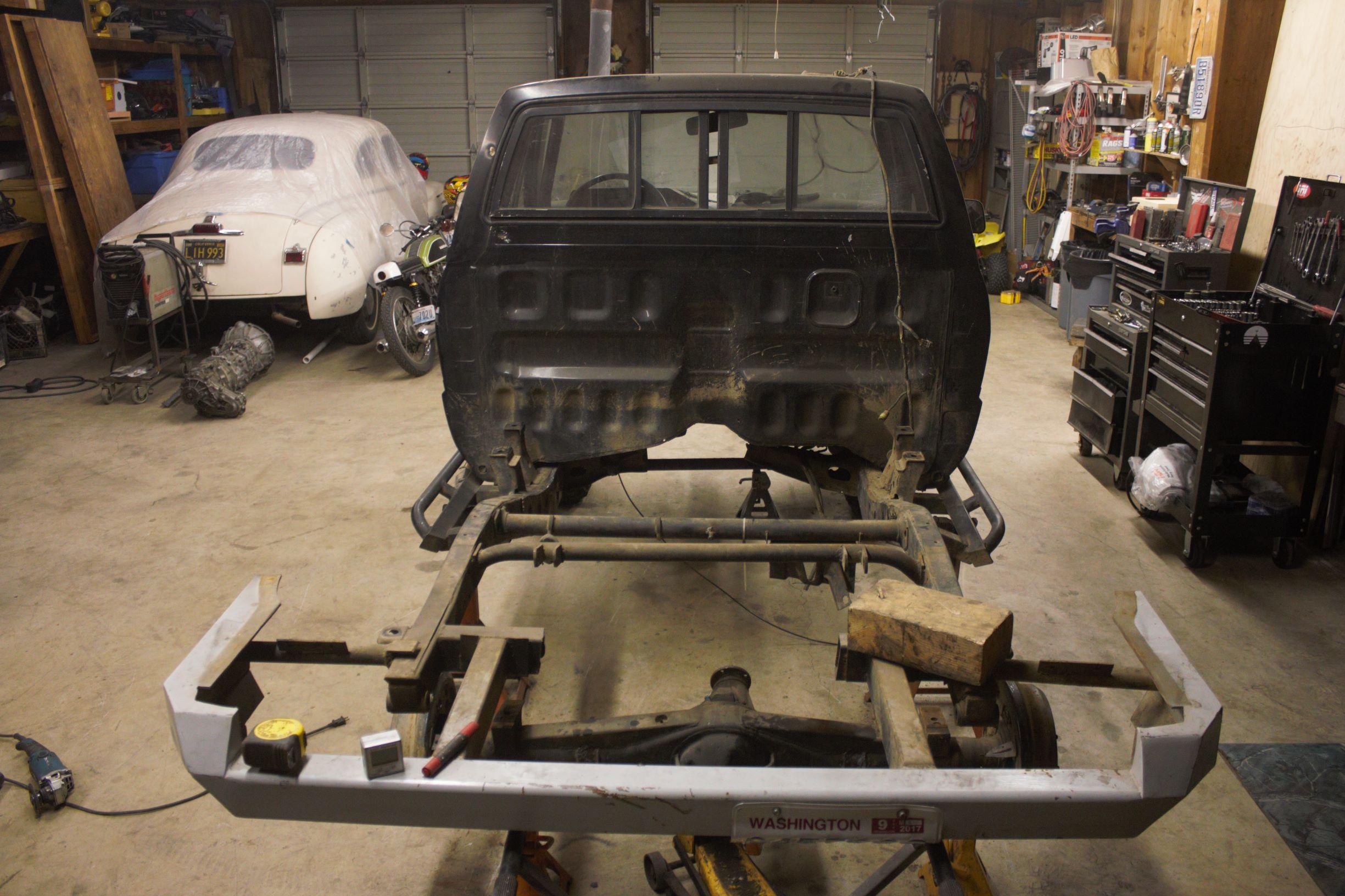

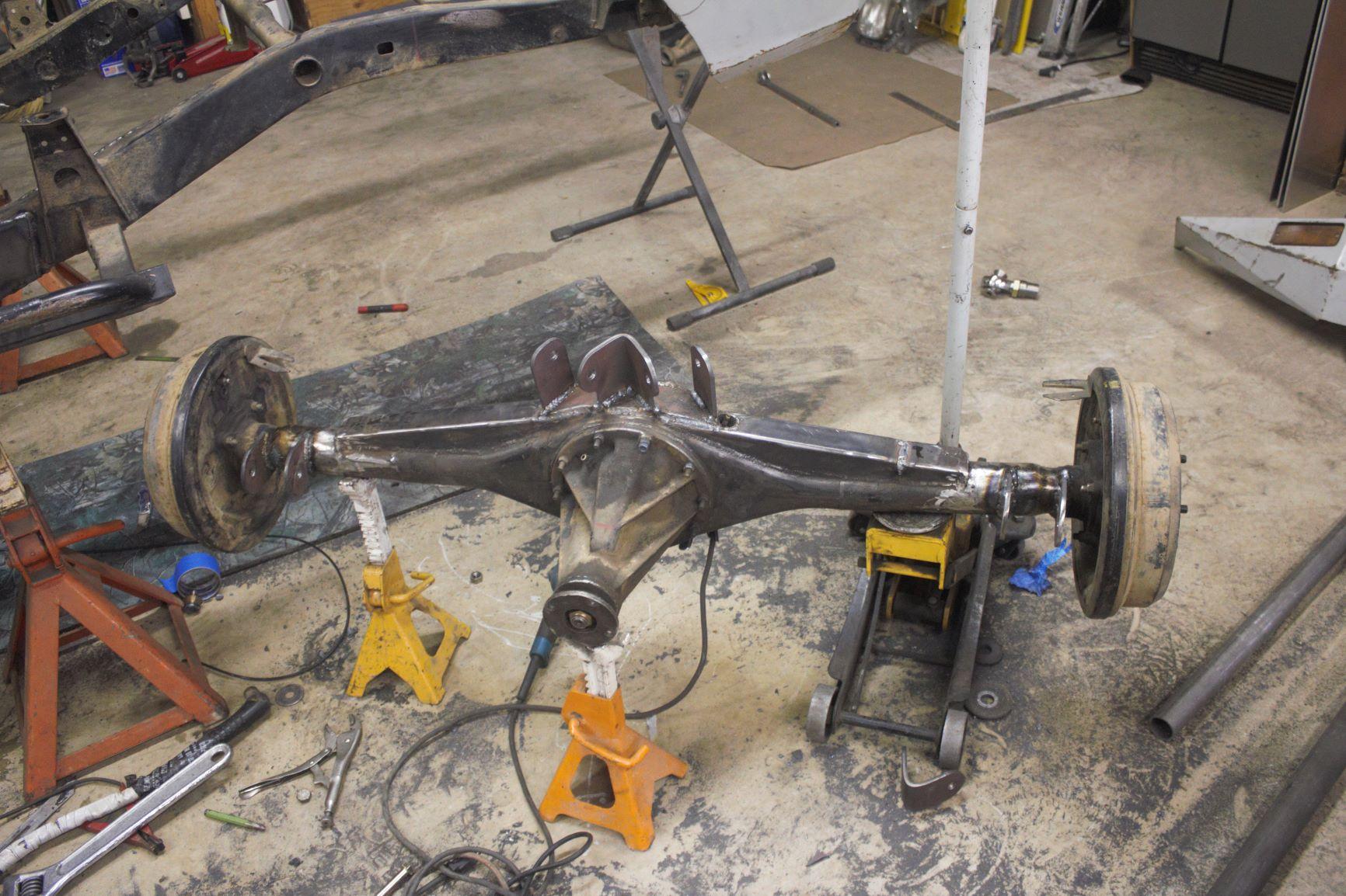

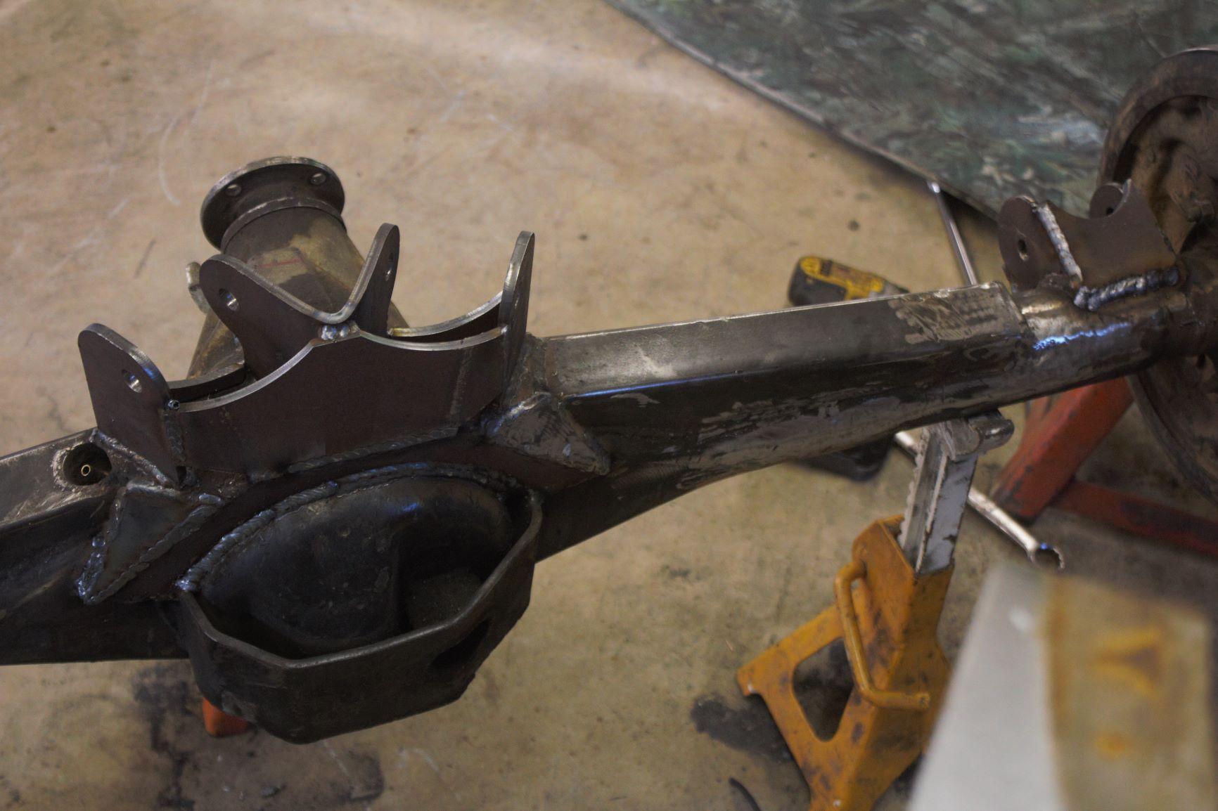

then delete all the leafs brackets etc in the rear. Which was a pain because I had frenched my leaf hangars frenched into my frame. IMG_7206.jpg
IMG_7209.jpg What I started off with

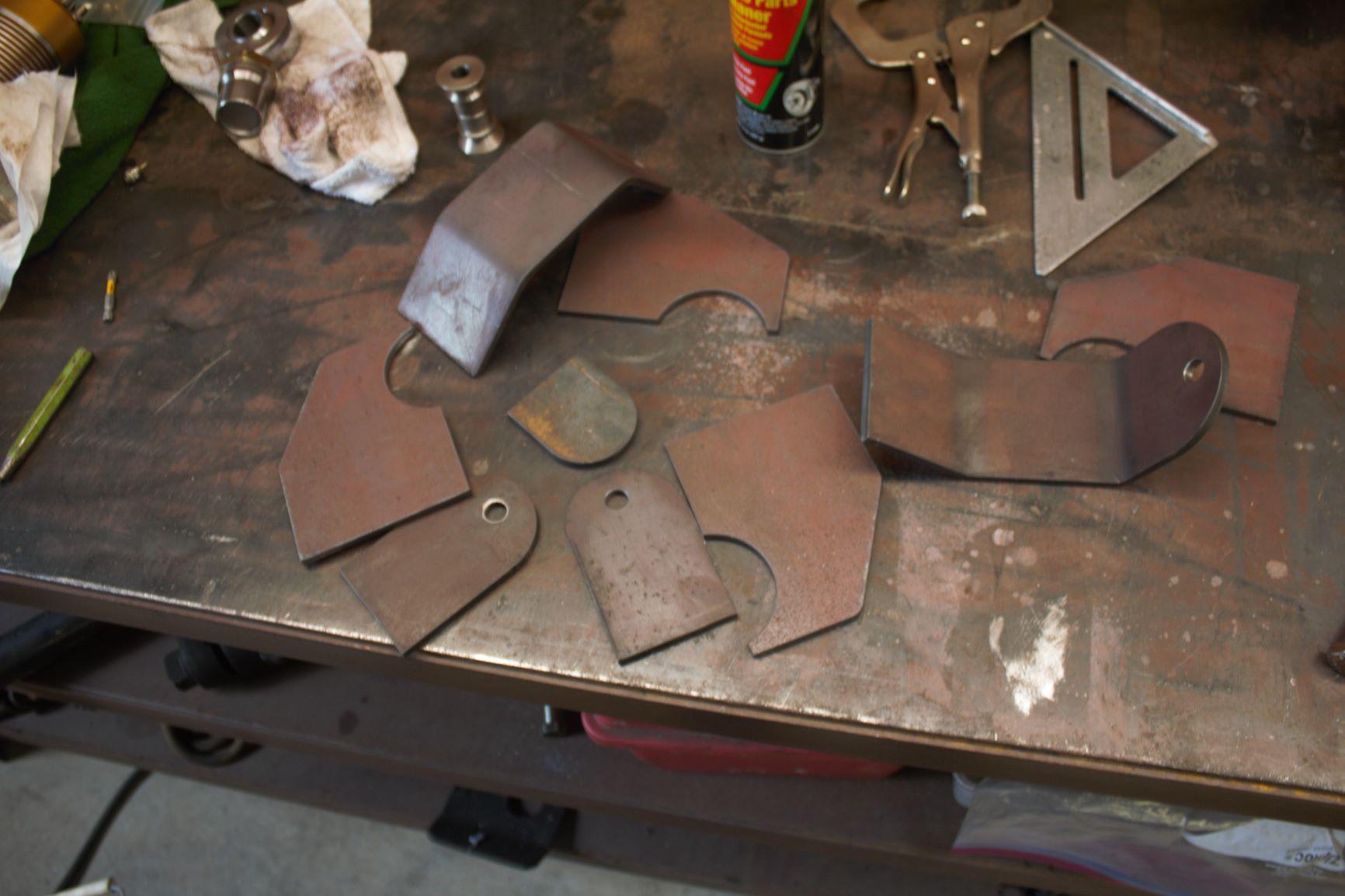

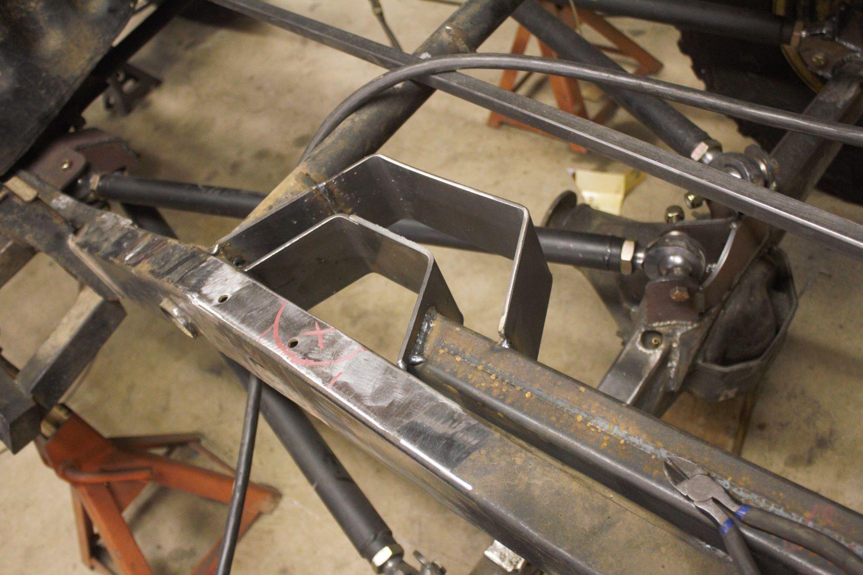

IMG_7211.jpg fresh brackets cut and bent for frameside links
one.jpg and axleside uppers done.
two.jpg almost.
IMG_7220.jpg ok now done.
All this work has been done during the great quarantine of 2020, so I've got a little more backlog of posting to do, but gonna get up to current soon. Maybe this forum wont die just yet.

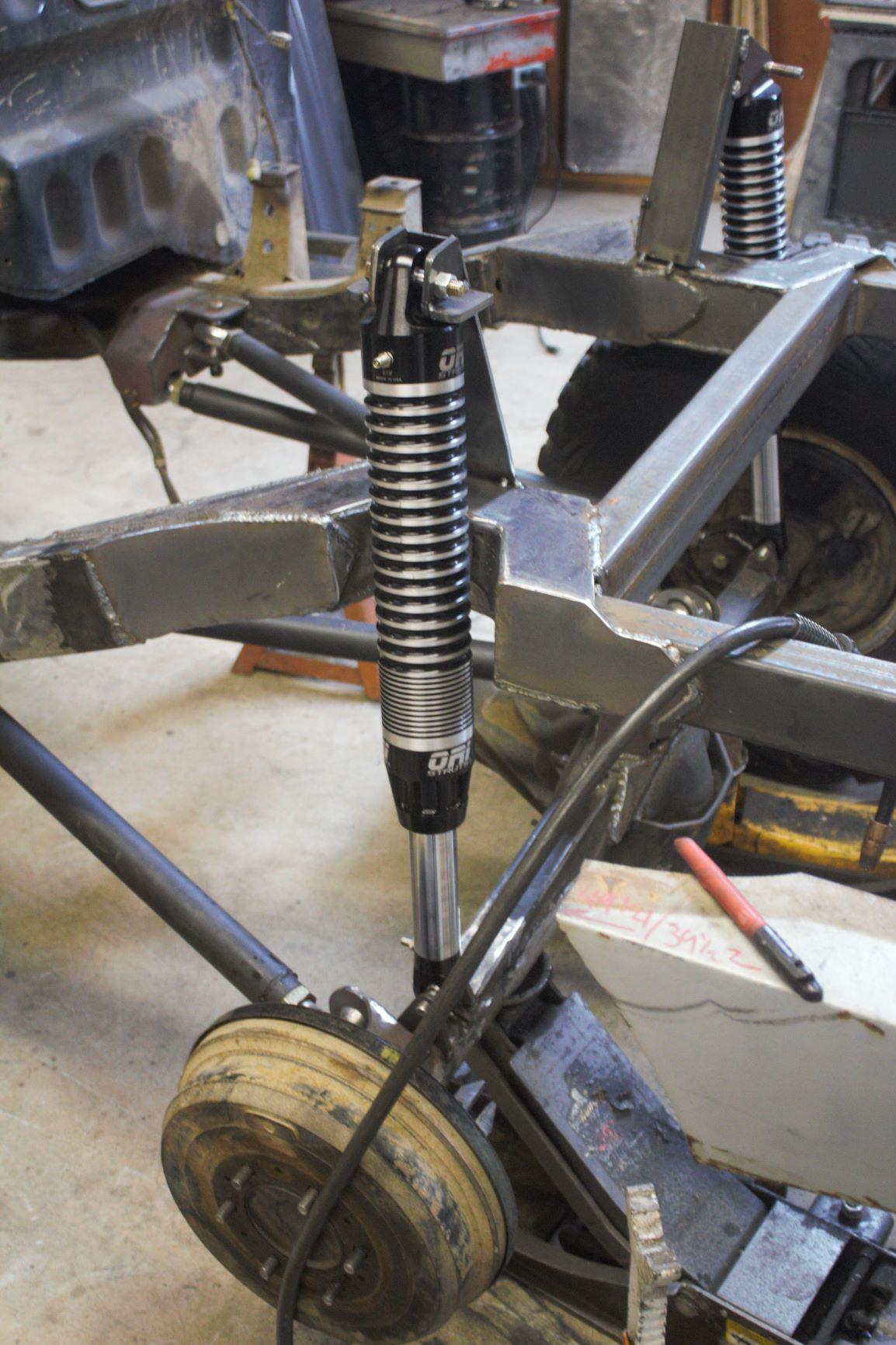

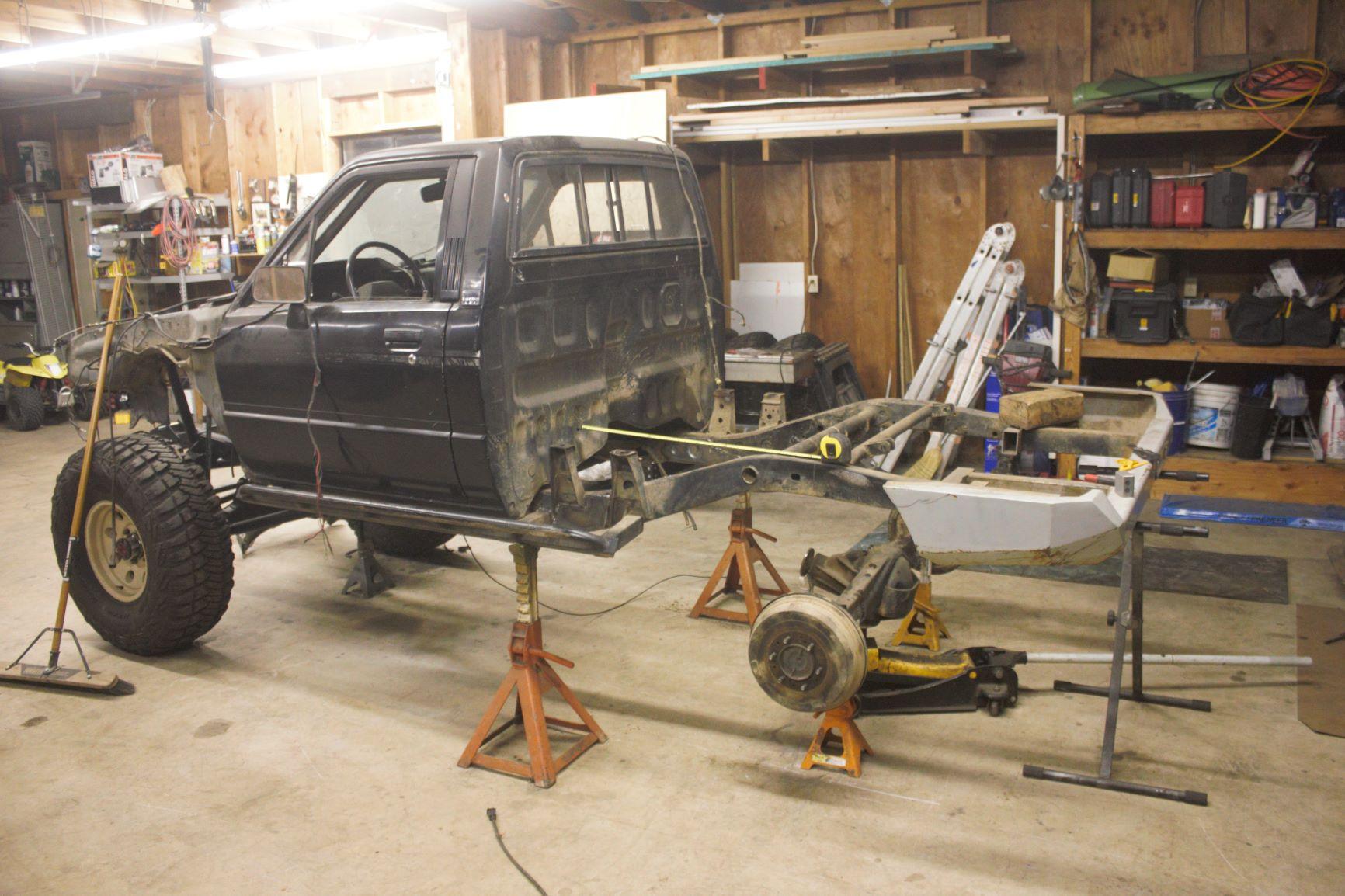

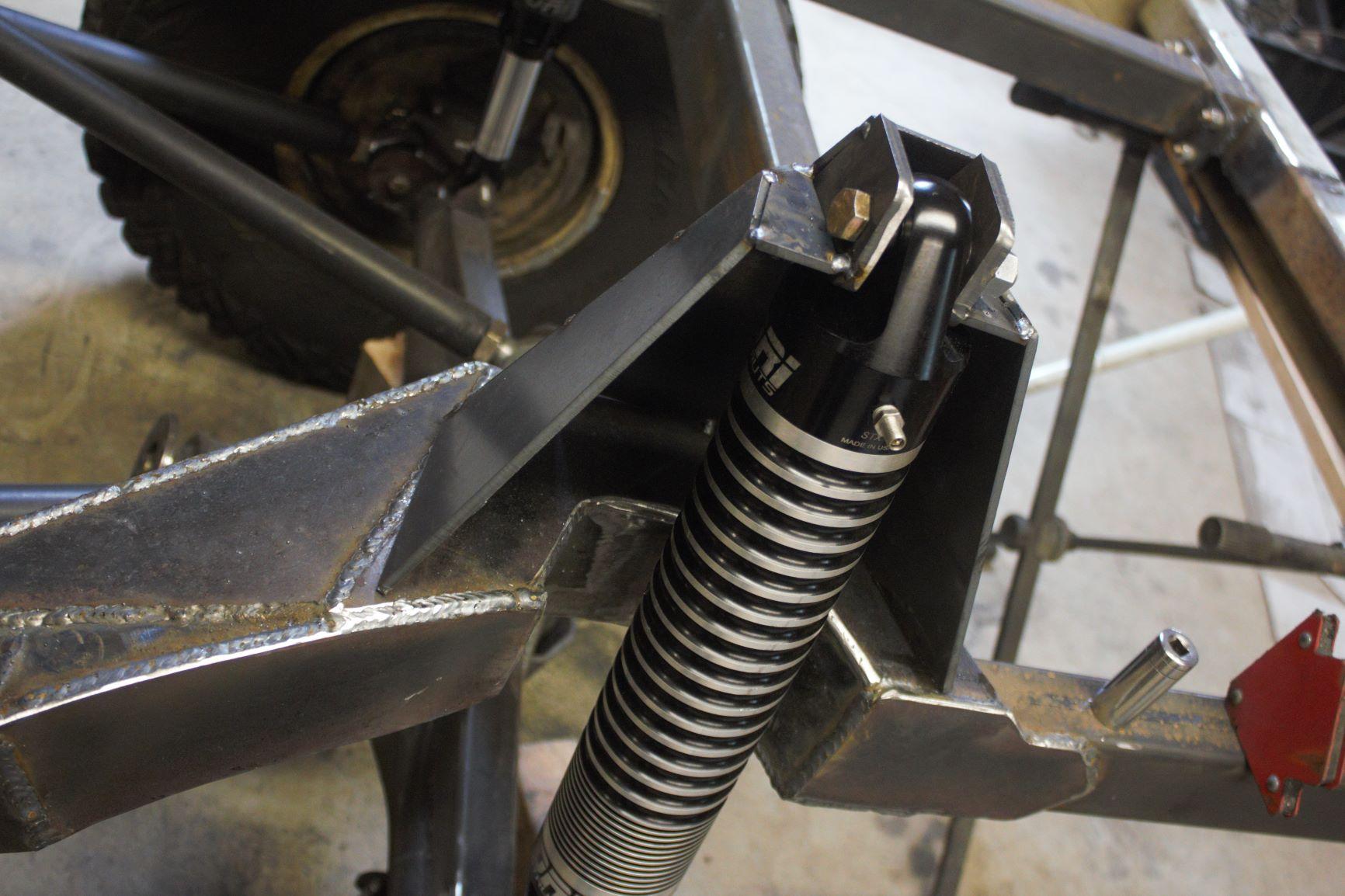

IMG_7224.jpg Had to make room for the struts
IMG_7228.jpg so the frame got a little C-notch

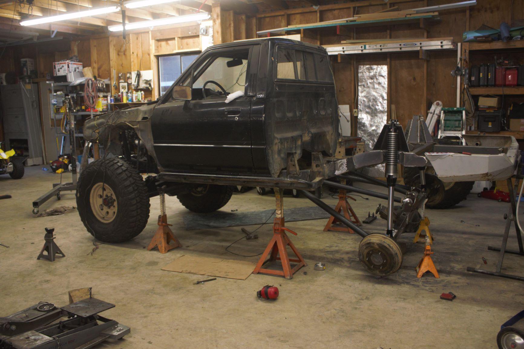

IMG_7236.jpgand then the tires were all over the front of the frame notch, so that got wedged out
IMG_7240.jpgthen made some baskets to put the shiny stuff in
IMG_7245.jpg and checked flex again.
