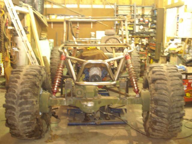

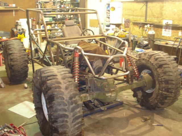

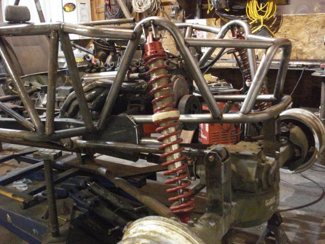

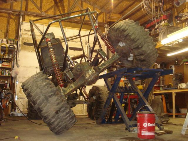

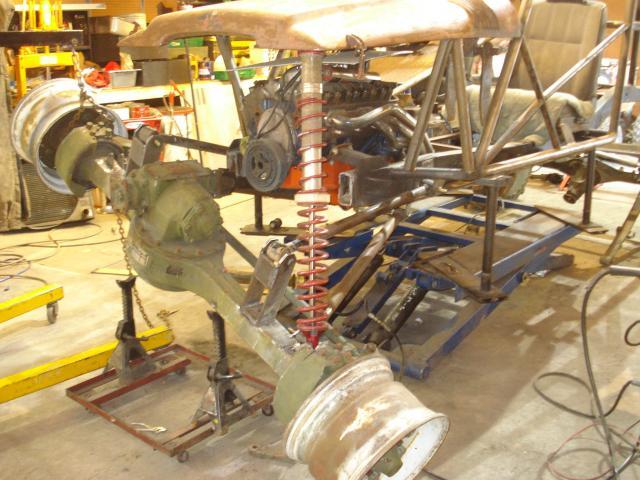

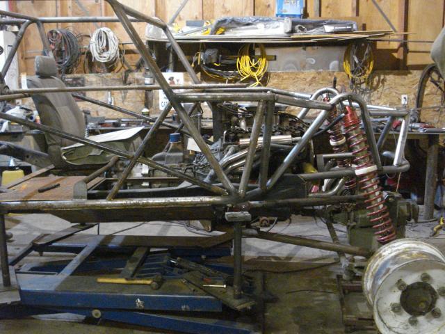

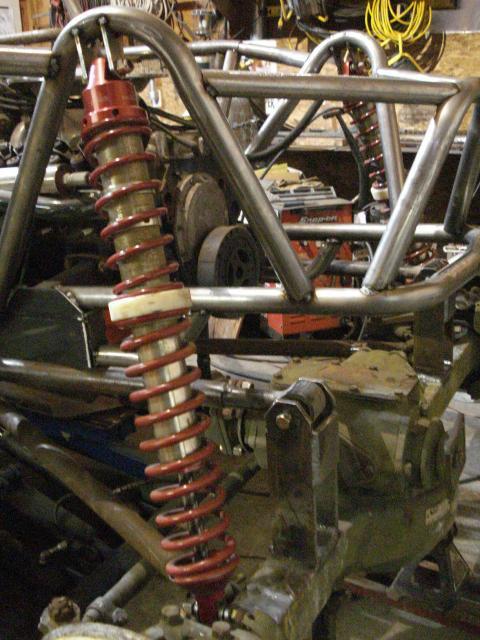

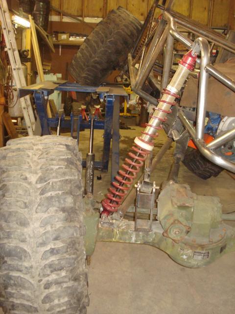

I have been workin on my old 4runner again. I seem to hack off more and more runner each time. Oh well its got at least 6 feet of toyota left now:redneck:
I had originaly planned to go leafs and toy axles. But I have saved faster than I have been building on it lately.

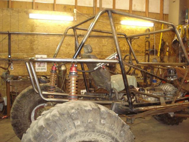

I have been actively looking for coilovers for the last year. I finnaly came across a set of 16 x 2.5 resi SAWs, two with dual rates and two with tripple rates.

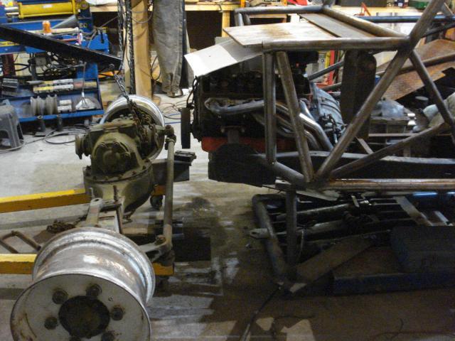

I have a 350 chevy mated to a 465 and a toyota case for drivetrain.

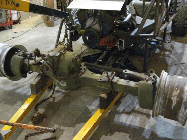

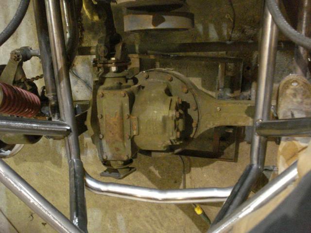

The kicker came at the swapmeet this year. I picked up a pair of rockwell steer axles. I am going to run them:awesomework:
A few pics!

some more.:corn:

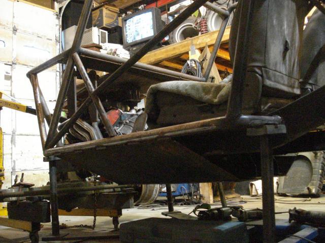

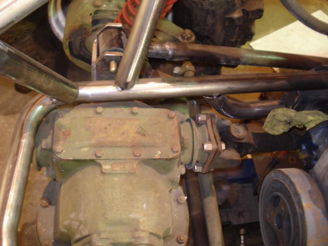

some misc.

Ya know, I looked and looked, and I can't find anything there that is Toyota. I mean, even the hood looks like its off a Zuk. Wheres the 6 feet of Yota?
Neat axles. Look almost bulletproof.
There's some toyota frame in there
Theres enough frame to keep the VIN and two 4runner seats.

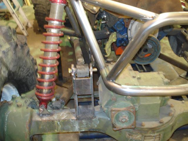

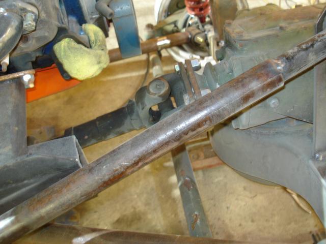

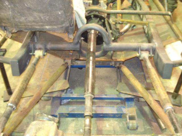

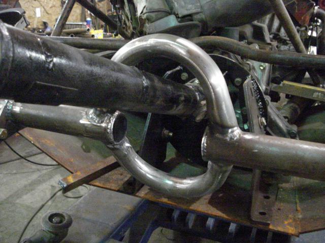

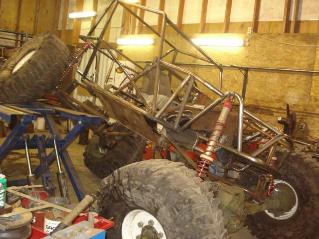

Just to show it had leafs at one time, the front upper links are mounted using the old shackle sleves in the frame up front!:haha:

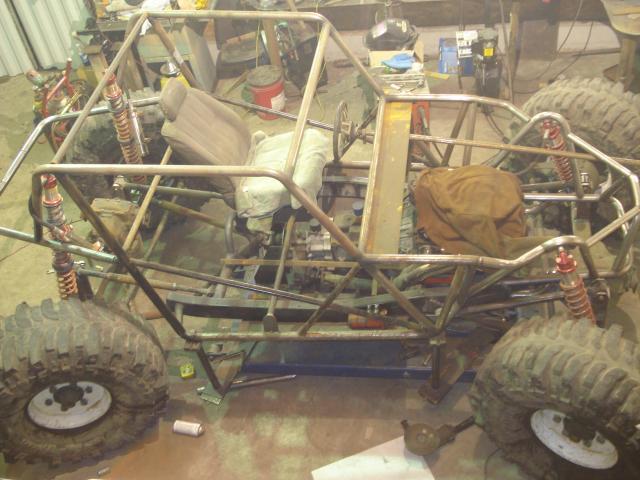

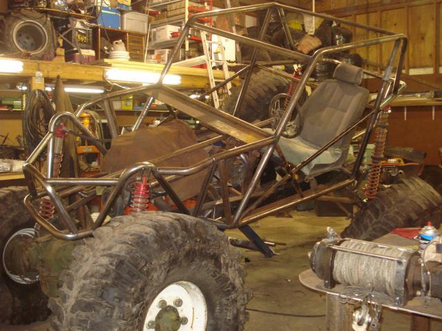

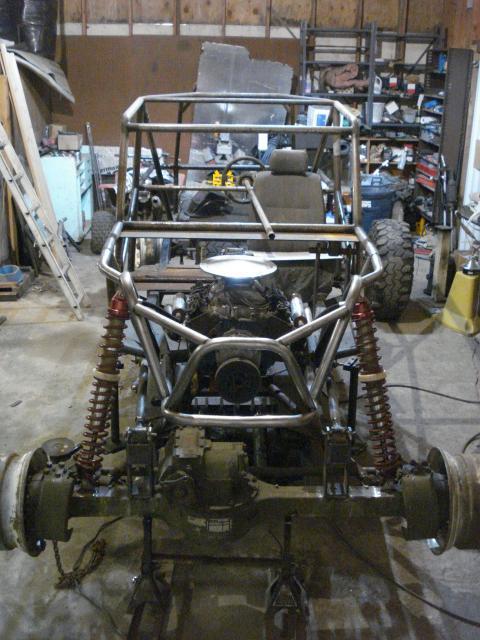

Ive got a rolling chassis now:cheer:
I have to rotate in the top front shock mounts and rotate up the rears to avoid contact when fully stuffed and turned. It otherwise is OK I think.:D
