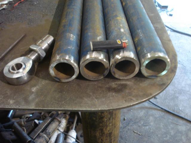

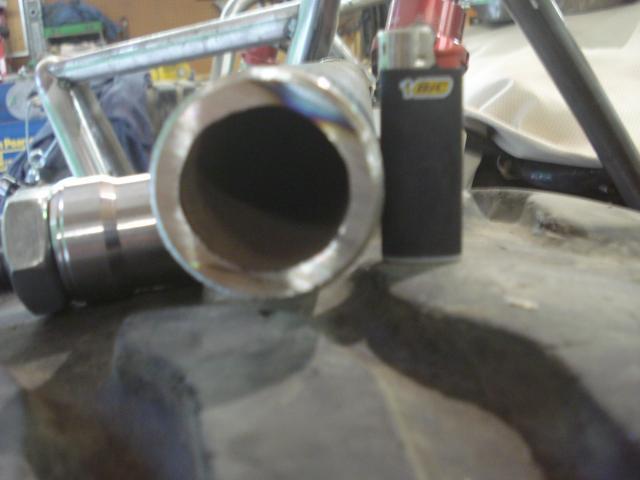

Worked on the upper (temp) links. I have 4 links made of 2 inch 7075 that have been cut and threaded, Ready to be annodized, then the hexs machined on the ends and the lettering to be done on the sides. That way the links will be color and all the fresh cuts will be bright aluminum. I am getting hooked up by a friends machining bizz on the links and have to wait for another order to get finnished so my links can get "piggybacked" in with another batch of annodizing.:bling:
For the time being I welded some threaded bungs in some 3/8 wall tube and made the uppers. I figure when the aluminum links are on these will make great spares if needed and use the same heims.:awesomework:
The lower links are going to be "unbendable".:flipoff: They will be steel not aluminum and will be engraved with lettering too. They will have bushings and heims. As soon as I get then finnished up, I will show them off.:corn:
