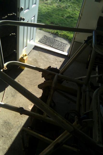

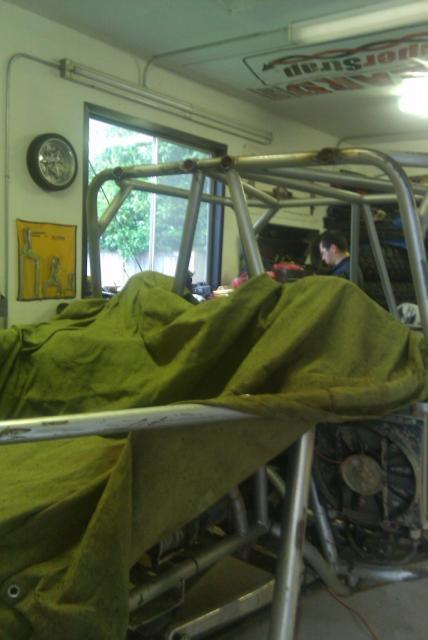

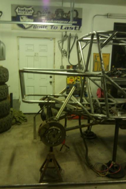

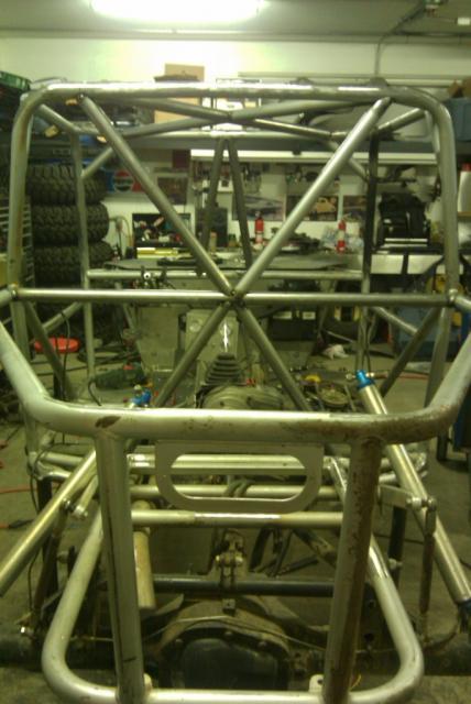

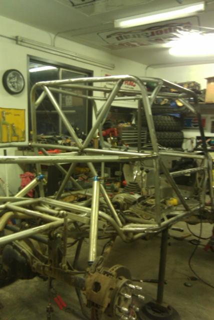

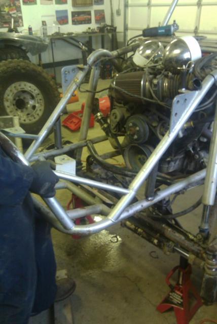

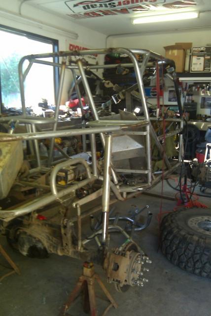

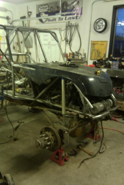

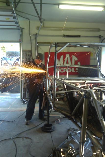

so a week or so ago my brother brought his chassis over to my place to go under the knife
its been rolled several times really hard and the roof was about an inch out of square or so plus he wanted to change some other things
list of things to change before koh
fix passenger a pillar...................................................done
resquare the roof.......................................................done
cut out all the center passthrough that came on the three seat chassis.....................................................................done
x brace the new center area.........................................done
remove third seat.......................................................done
remove fuel cell and build new one
cut out winch and re mount it.........................................done
shorten the back 4"......................................................done
shorten the front 6".....................................................done
rework the entire nose to fit the car more style................done
cut all roof supports out and redo in x fassion....................done
remount battery.........................................................done
remount trans cooler...................................................done
make a rear deck to strap stuff to
remove rear bump stops to gain more up travel................done
redo rear shock mounts to gain more droop.....................done
redo radiator mount so the hood can be pushed back 3"....done
and then redo all the panels

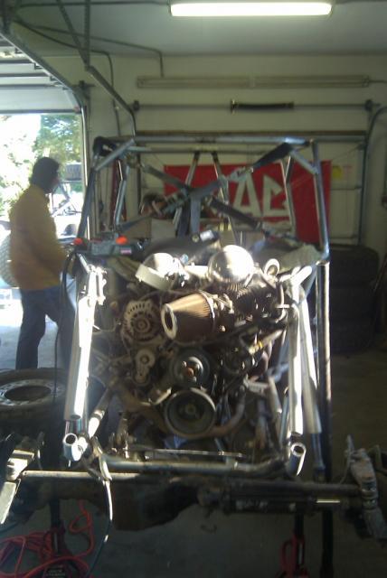

some pics of the car when it came

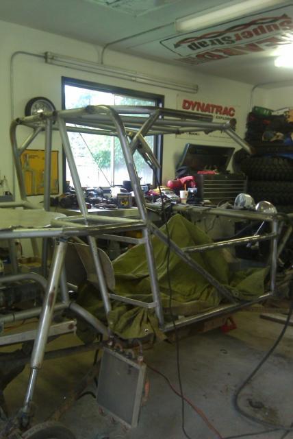

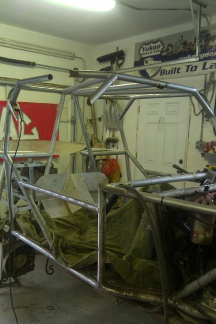

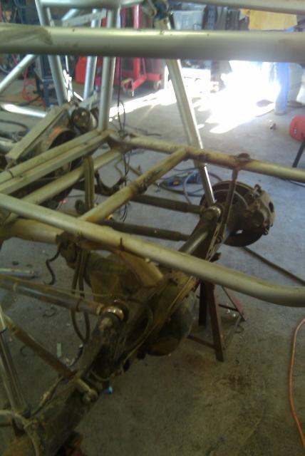

progress in order i think

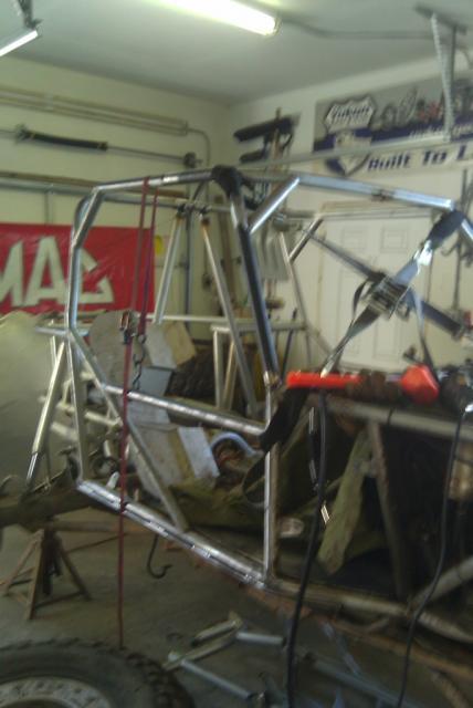

more

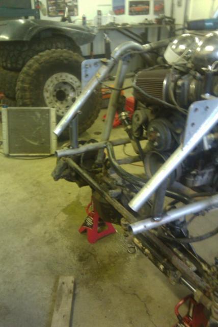

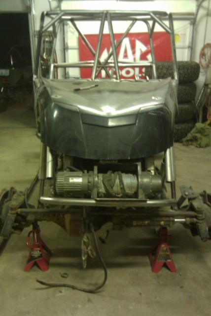

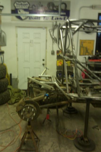

still more

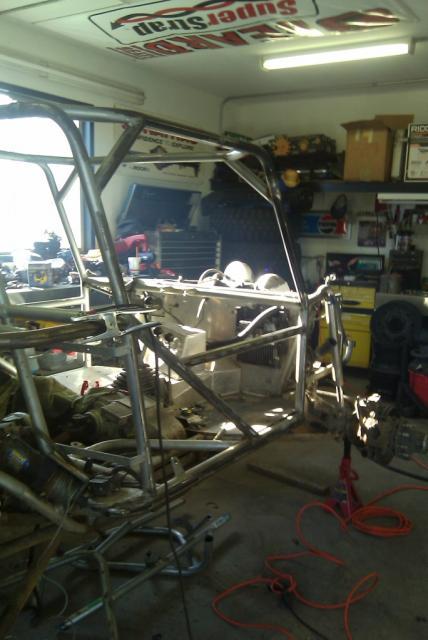

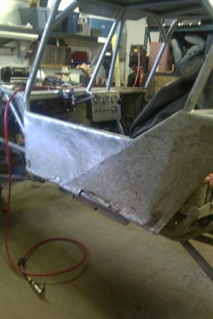

last

:eek::eek::eek: Damb you boys have been busy!!!!!:eek::rockon:
What rear end is that?? Ford Van 35-spline, SF 60?
Does he run it offset or did he shorten the long side?
Nice work.
You guys really stripped her down:awesomework: Cadaliac grills......look at the oil my Cadaliac spills:haha:
Which rig is this? Lets see some pics!:corn:
This is one of the cars you dont see very often because the owner dosnt wheel!:rb:
The times it has been wheeled it seemed to get ****ed up more and more, This rebuild/revamp was long over due!
X2 on the glitter paint:redneck:
