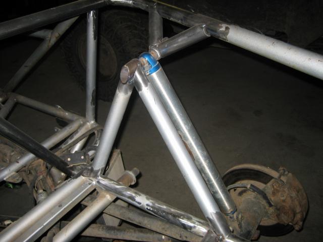

shock mounts all tacked up
new winch mount in
front shock towers reconnected to the frame

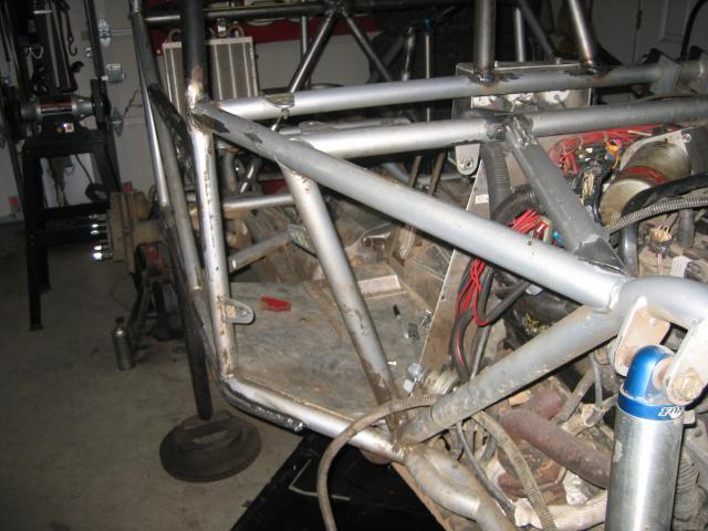

Looking good. Save yourself some headache with the rear shock mounts and don't weld the outer mounts until everything else in the back of the chassis is welded.
I welded everything in the lower half the chassis first than changed the rear diagnol down tubes and it pulled those mounts out almost an 1/8" makes it a real pain for the bolts to slide in. I even had a brace tacked in to stop the chassis from flexing and the mounts bolted together with spacers. It just sprung out of alignment when they got pulled out.

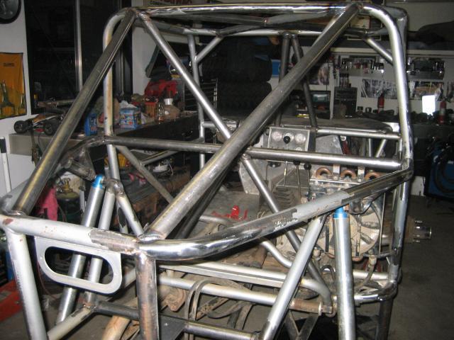

pics from today
welded everything up
re mount exhaust in the back

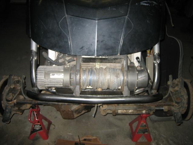

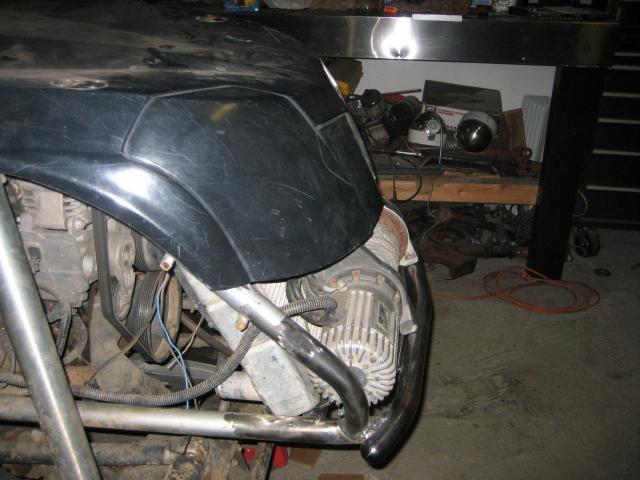

finished up the front bumper bar

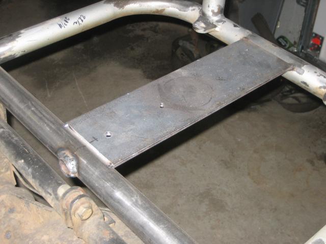

cut the plate for the front winch mount and tacked it in

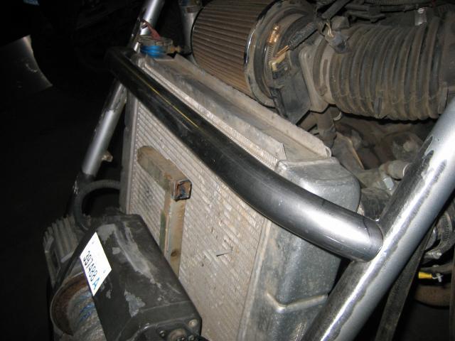

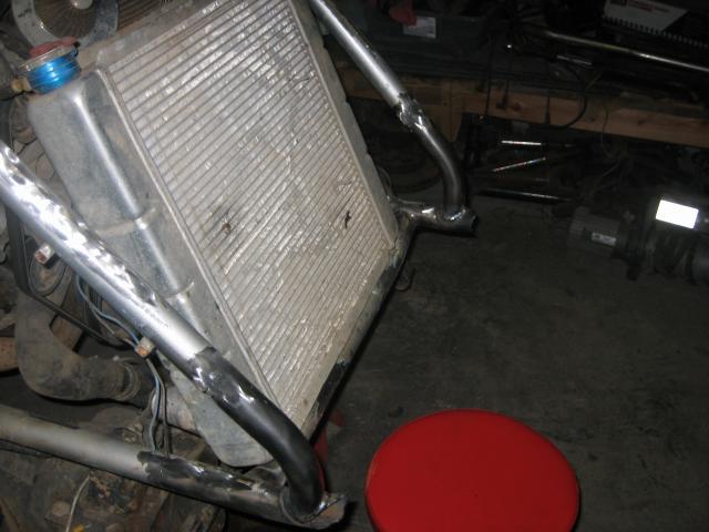

started radiator mount and tacked in

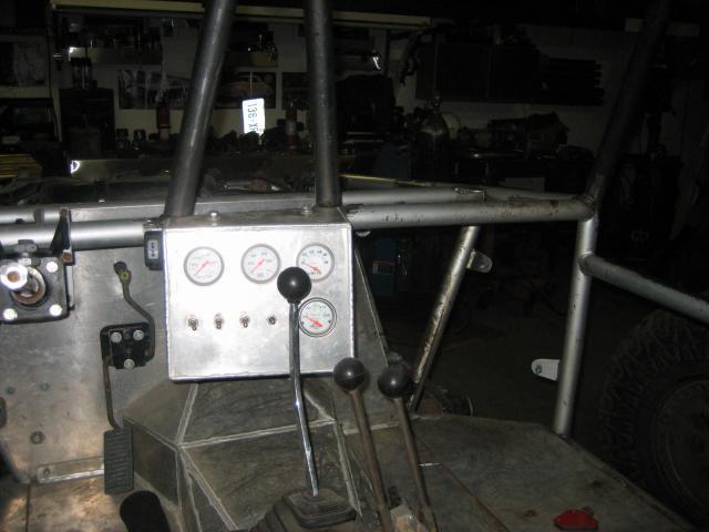

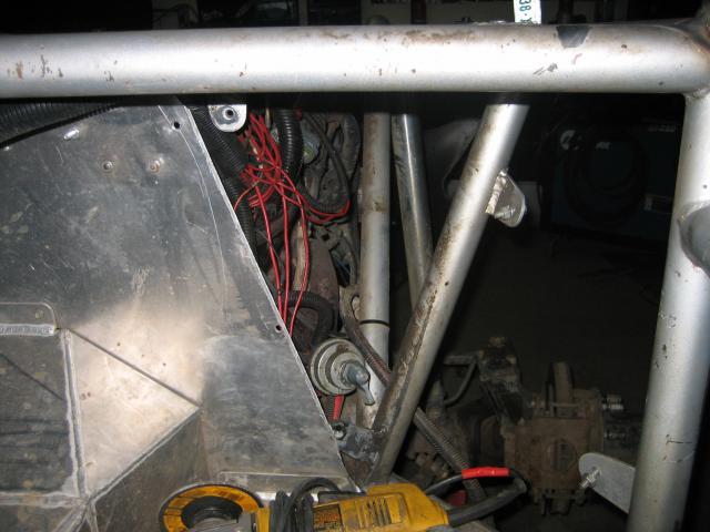

decide to start on the firewall so we cut out the pass corner for im proved vis
and added a tube for more support and to mount to
also got the trans cooler mount almost done

:awesomework:Great progress! What style/brand tube bender are you using?
bender is on loan from jason c not sure what brand it is air over hydro
same bender that was used at sn fab for years
