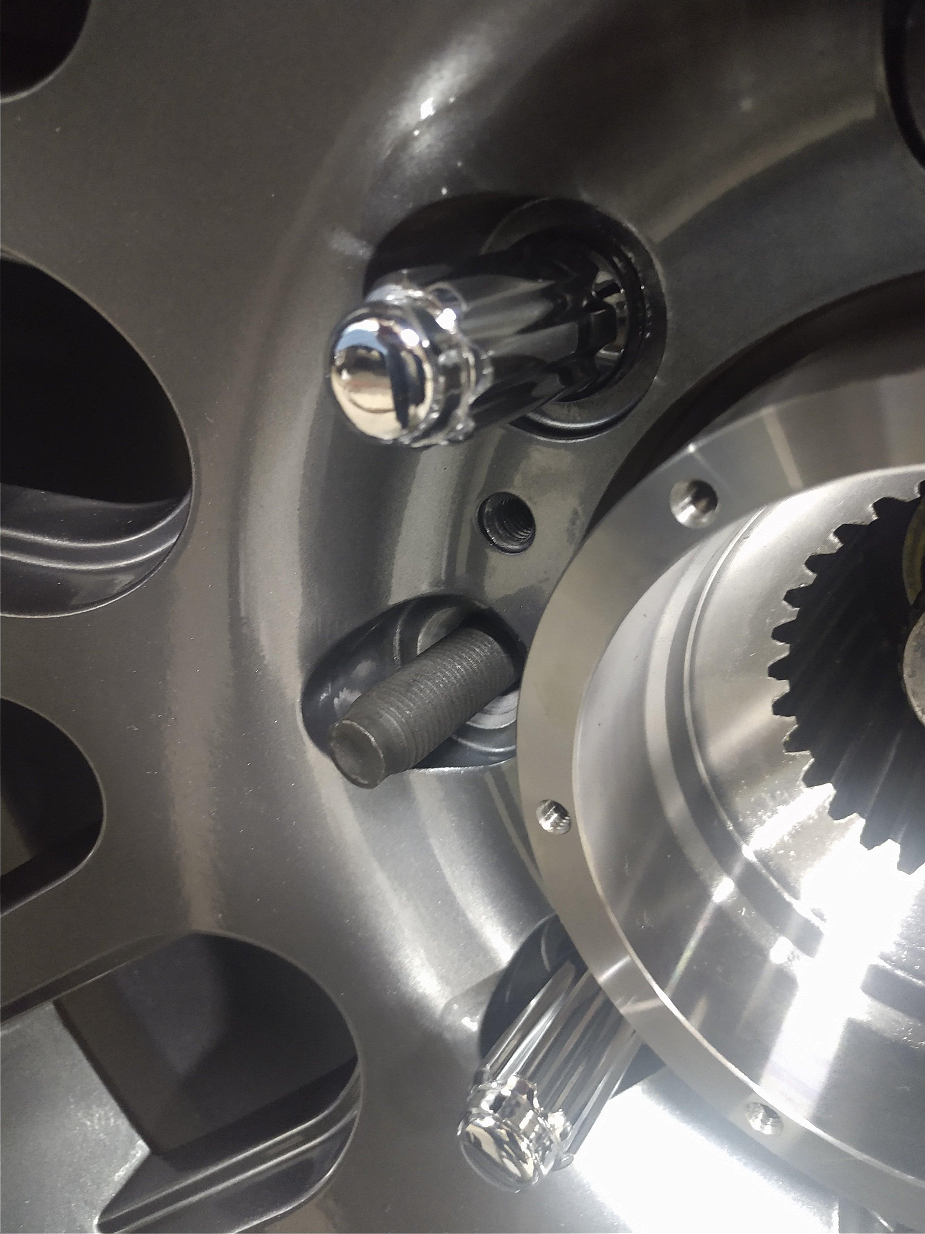

Dorman 610-347 is what I found online. I reused the metric studs because they matched my rear 14 bolt. There is plenty of length through my wheels.

Welp, I ordered the 347's yesterday. Luckily, looks like they're almost identical except about ½" longer, which I can live with. If there's any sort of consistency or pattern with their part numbers, I haven't found it yet.
