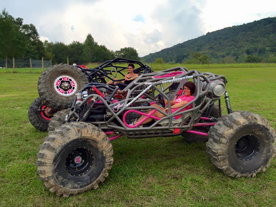

The two ladies (Buggies) got to finally meet each other at AOP September 5th. Was a very humbling site to see both Second Chance and Lady Luck side by side and an honor to trail ride some as well. :dblthumb:

Thanks as well, Taylor and I spoke along the way of the Lady Luck build and this day was along time coming ! Sorry I missed it but glad my wife was able to make it happen! thumb.gif
