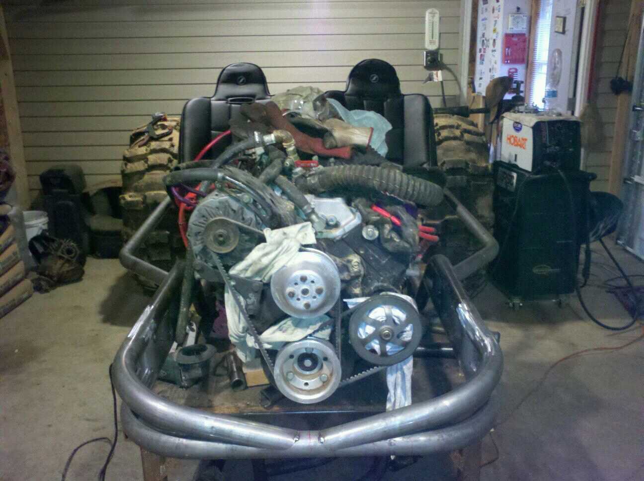

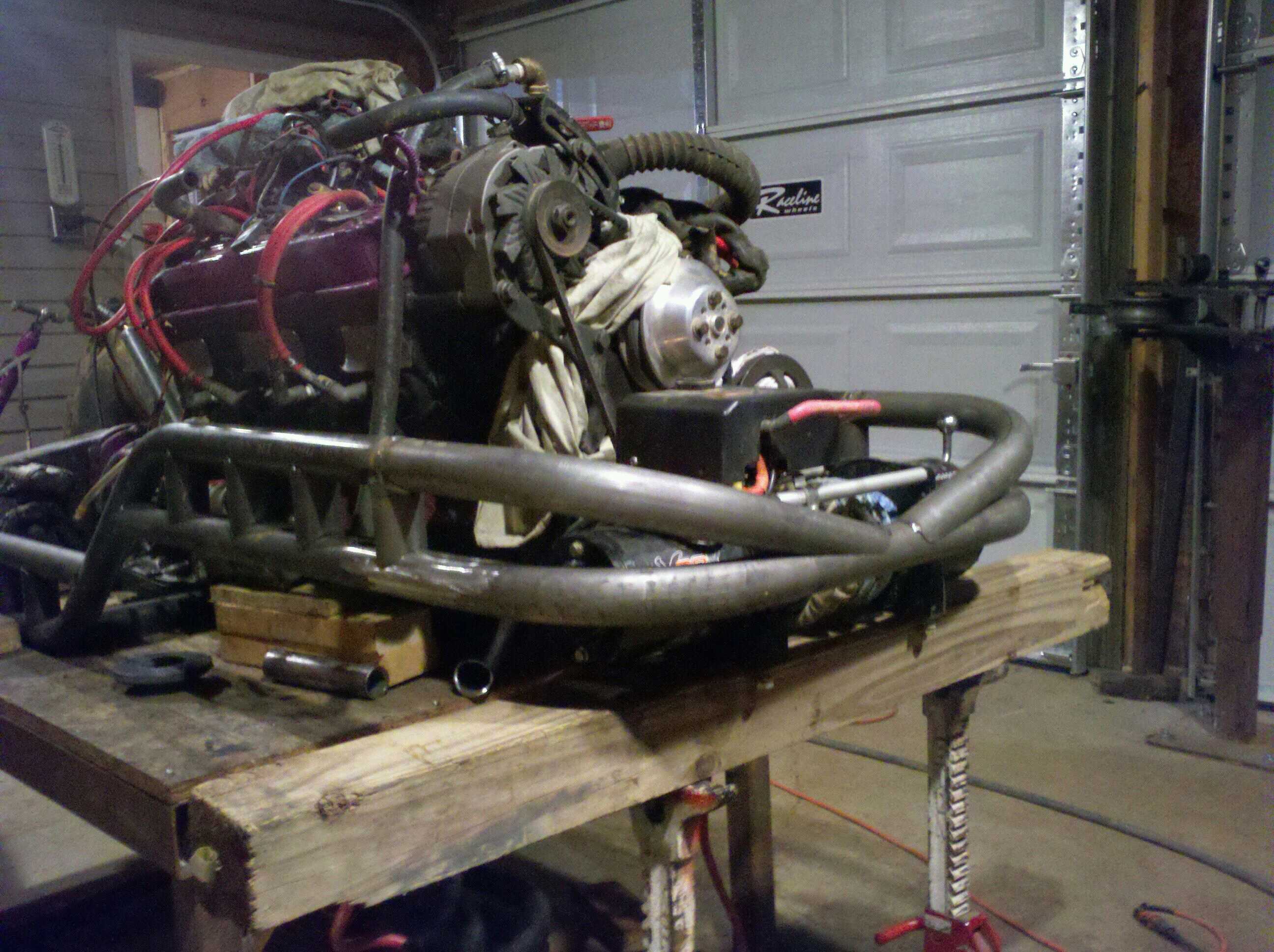

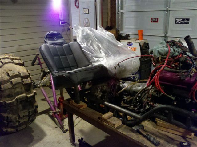

Made some progress but not as much as I wanted! :popcorn:
Re: SECOND CHANCE RIG

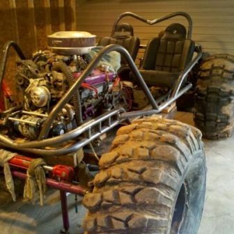

Here is an update pic on Second Chance, I haven't got to work on this week with my work schedule but hope to have a full driver section soon?! :spin:
God Bless
You mind giving some specs on the 406 wanting to build one, an looking for some ideas. Thanks
The 406 has an eagle rotating assembly with flat tops, 525 cam and vortec heads. Thanks for the comments will post more pics soon!

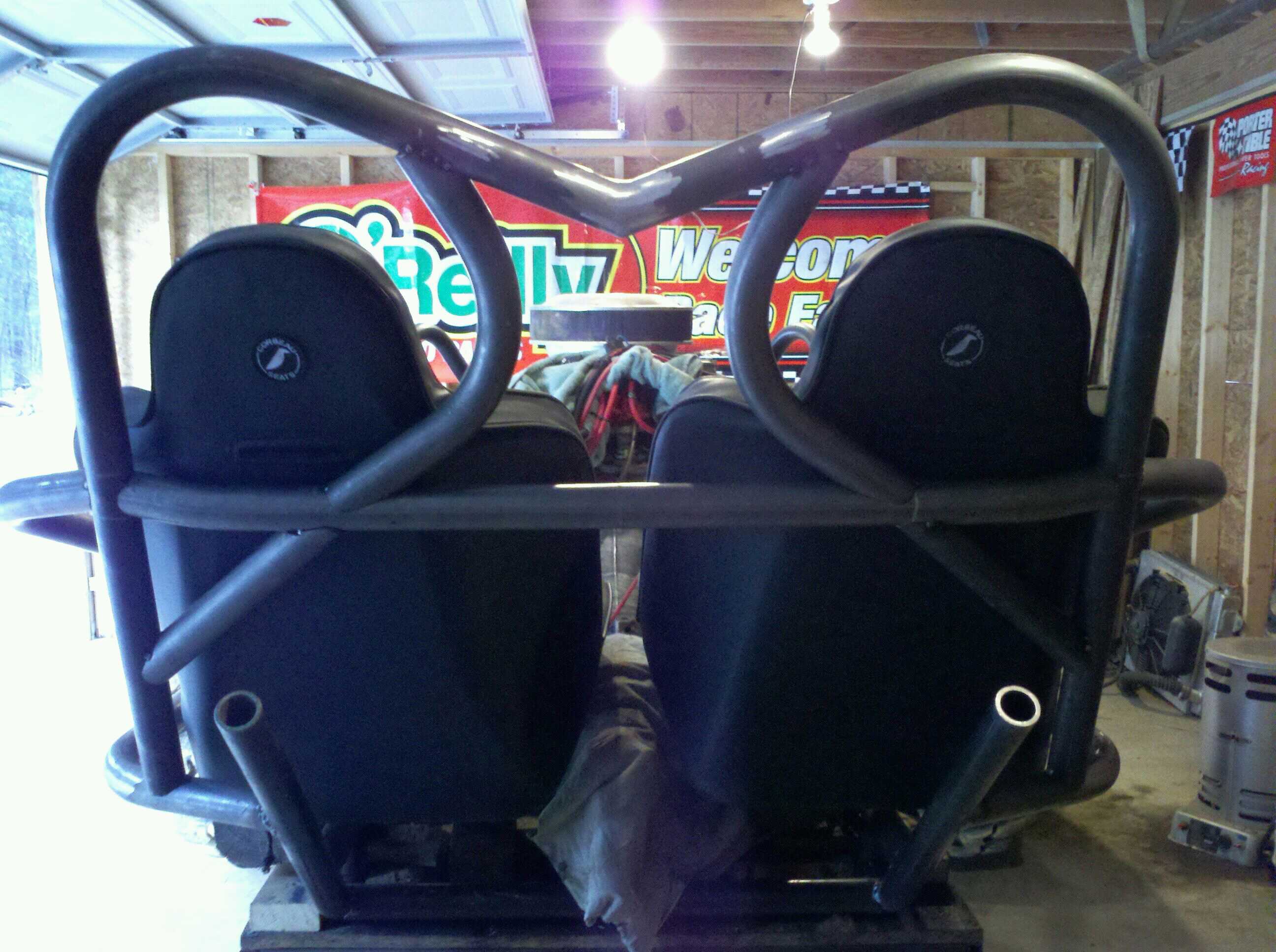

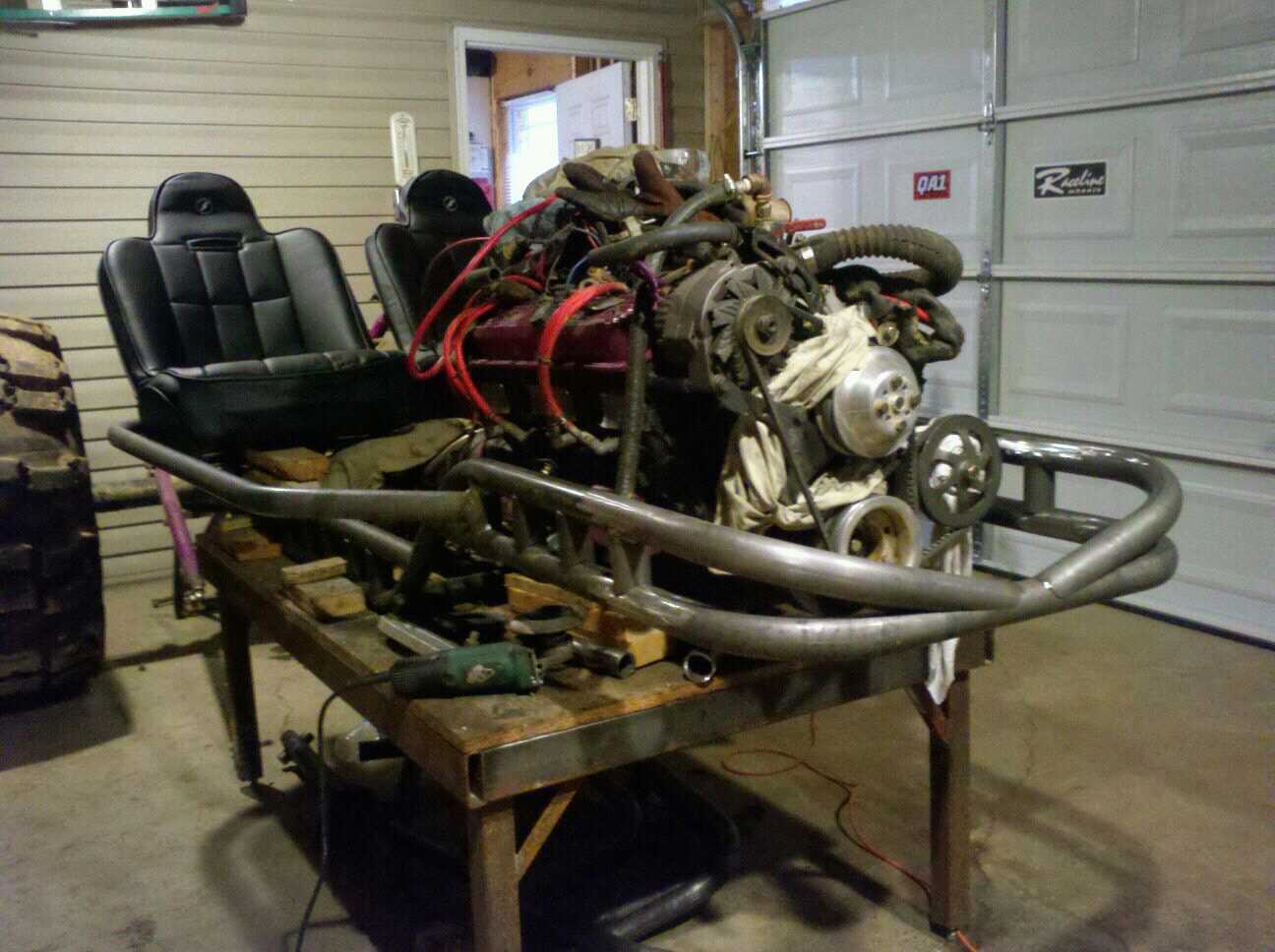

Few more bars added in Second chance. Hoping to have drivers section by this weekend Lord willing?!
Thank you much, I'm at the point of starting the roof line coming down the (A Pillar) right now trying to decide what look I want.
