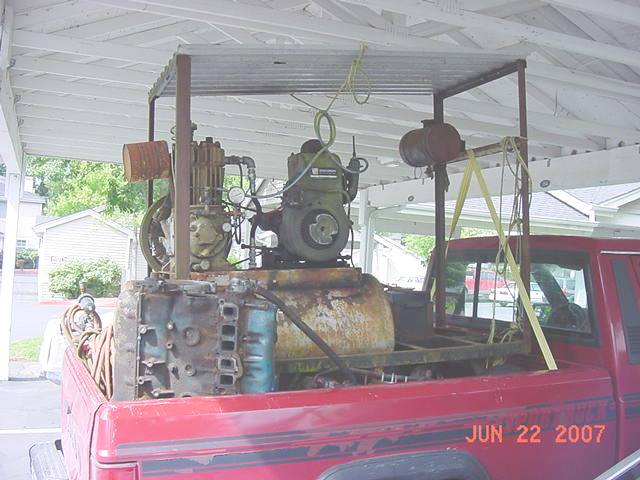

Crash saw mine on it's way to the building site. Gas powered (Wisconsin) Devilbiss with 80? gallon tank
