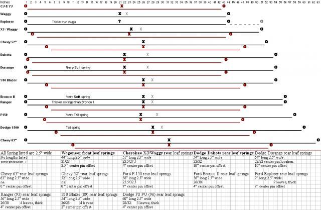

I am not sure where to find it now, but when we were deciding which springs to put under my rig, we found a table on the Internet that showed the length, offset, etc., of basically every leaf spring out there.
Spend some time with your friend Google and you should be able to find it.
