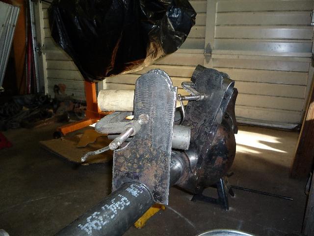

Sam and i tried to figure out a way to hook up what i borrowed to what i got and it wasnt gonna happen.

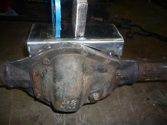

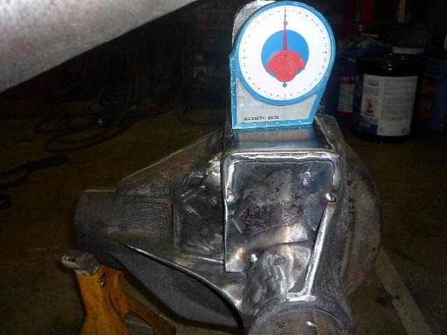

So i made some brackets...

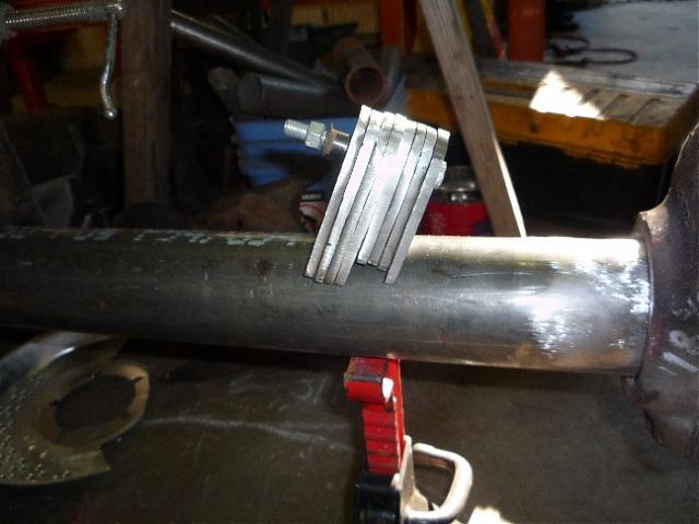

Just torched and de-slagged for now, ill final fit when i have the ends here. the uppers are gonna have room for multiple sets of holes for dialing in then ill reshape/make another final.
the lowers are much easier. 4 shorter and four longer.

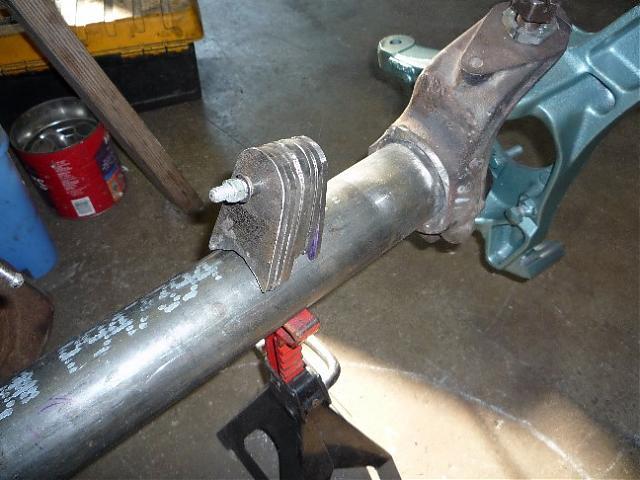

yeah i coulda bought some brackets but with the money i saved i got this:D

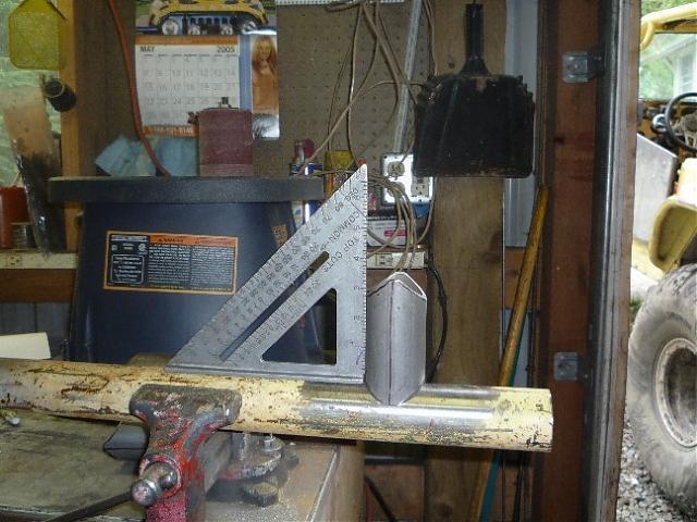

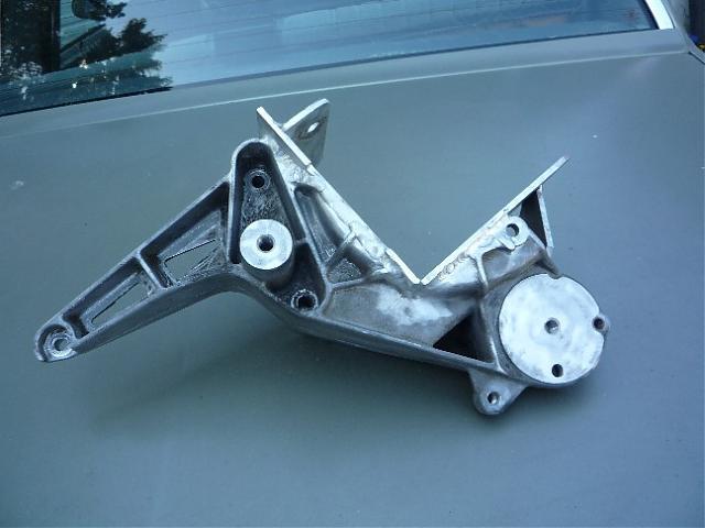

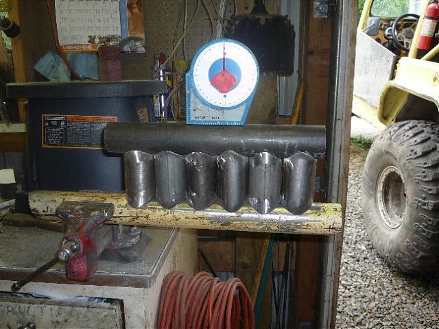

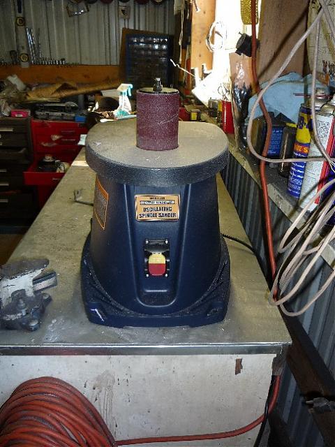

tig setup question?
it worked much better on the cardboard template:awesomework:
the flapwheel is faster but once you get it close it makes the radius perfect. of course the large spindle is 3" and a dana 60 tube is 3 1/8" but its easy to sand to a scribe line.
need to get better sandpaper the **** on it just crumbles off.
So what does it take to get the aliminium bracket tacked at home?
can i power a tig torch from an AC DC buzzbox and regulate the gas thru the mig regulator?
Does anyone have a portable enough setup that could bring it over?
My neighbor has all the stuff but its brand new unopened so until his shop gets built im SOL. He poured the slab last week.
i can borrow welding stuff from work so if anyone knows a good setup let me know what all i would need to borrow.

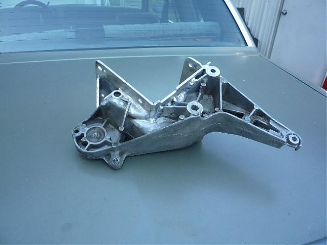

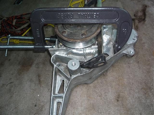

York Bracket

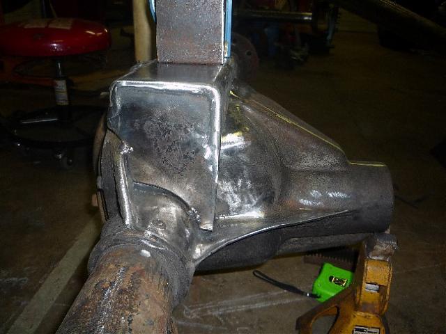

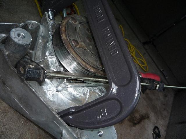

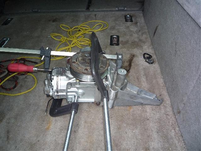

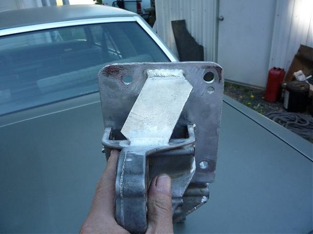

well the bracket made it to the back of my truck, we will see if i have it clamped into place well enough:redneck:

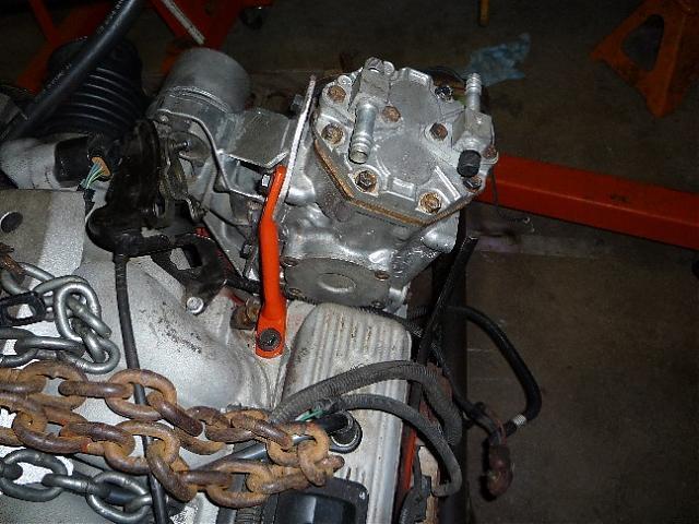

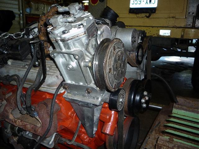

another shot of the installed unit.
this leads to another minor issue. the back brace no longer reaches its original location. now i get to play with fire to make a different brace to an alternate location.:FIREdevil:

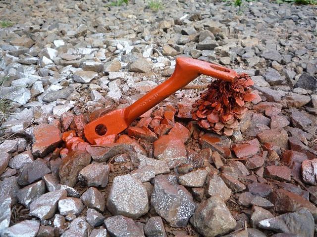

tonight im making the back brace, fire and an anvil.....:awesomework:
well that didnt work
the fire and anvildidnt work out so well, best leave that blacksmith stuff to the proffessionals. but i can cut and weld:fawkdancesmiley:

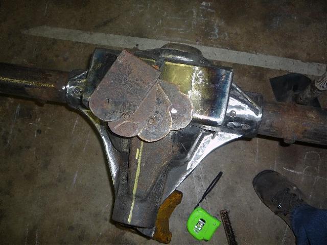

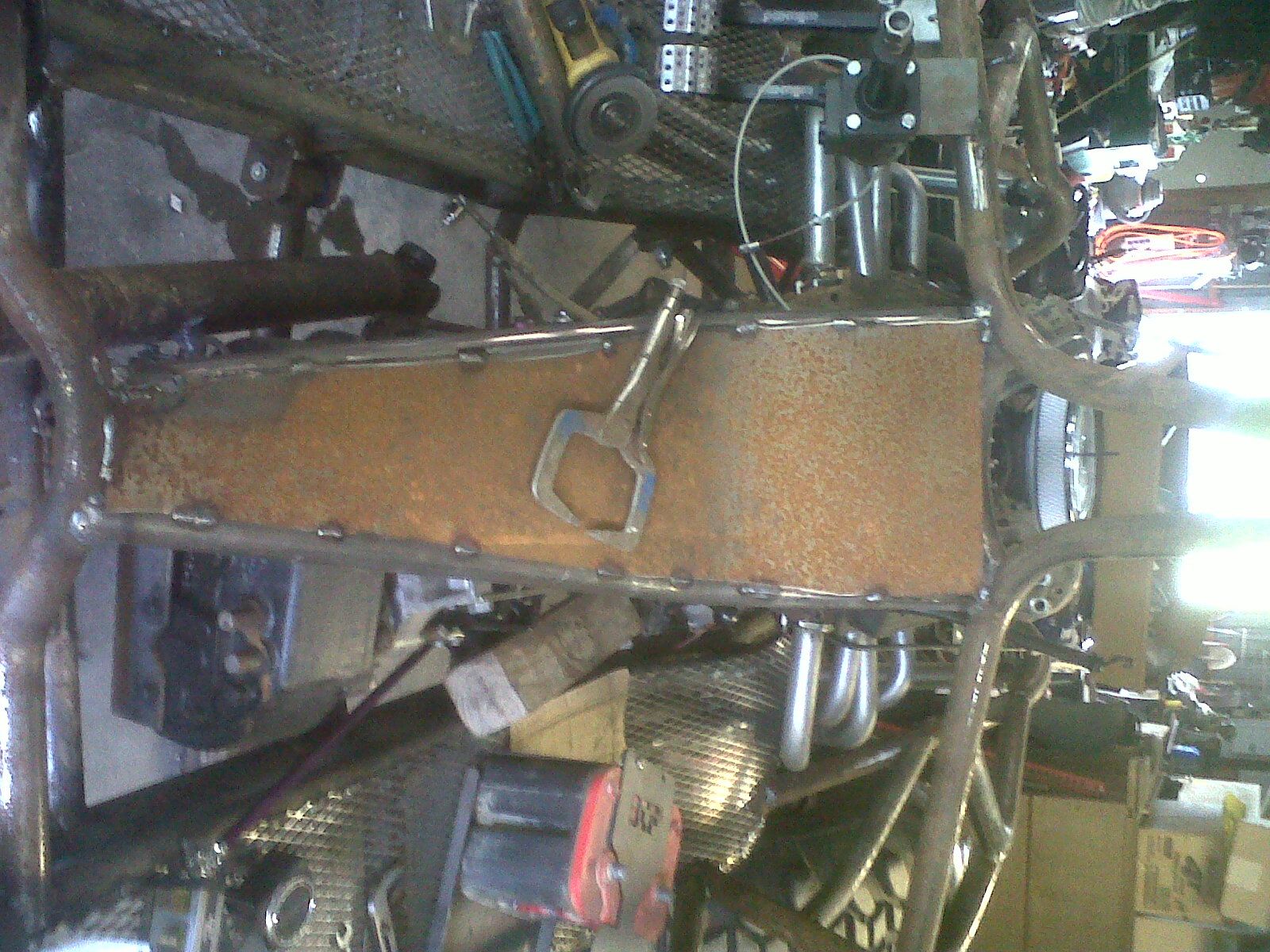

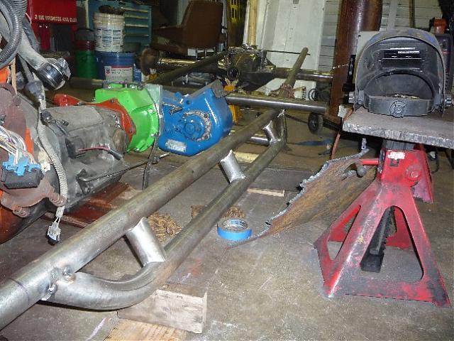

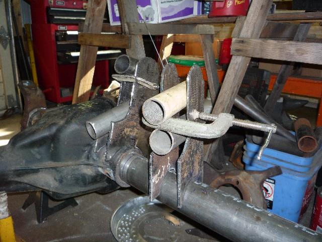

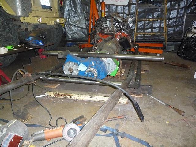

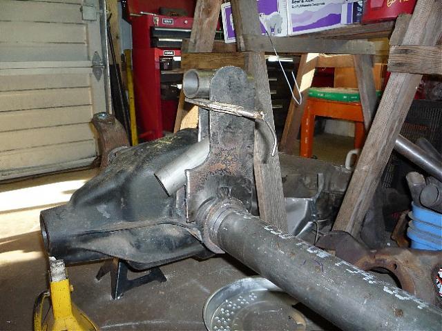

made a little more progress, made some center link brackets and a small truss to weld them to for the rear end today.

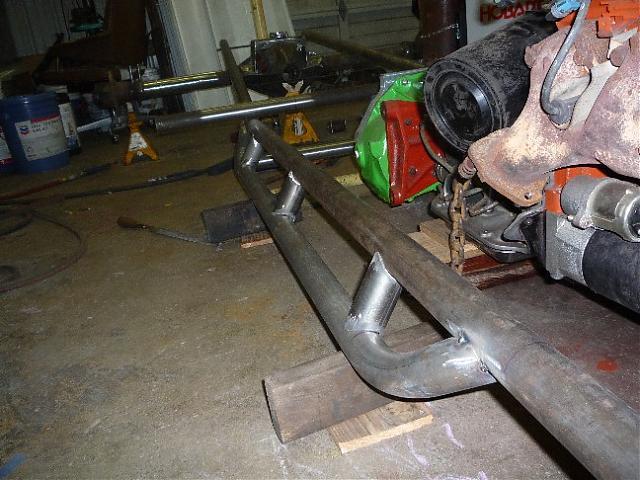

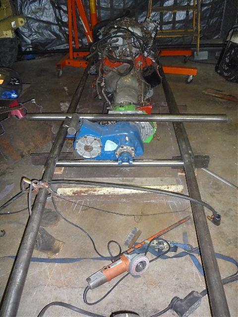

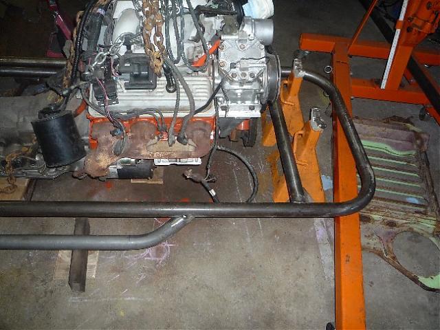

spent some time solidifying the chassis.
now i need to spen another day bending tube. by the end of the week ill have a bunch of small tube between the rails.

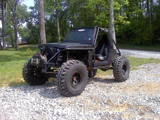

old school
bought this when i was 19.

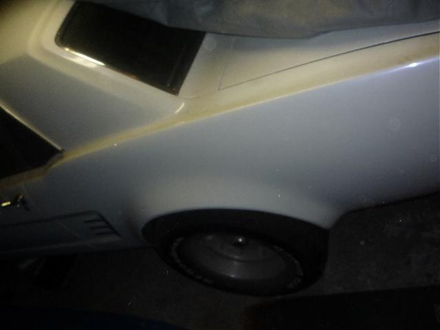

trying to get it to show the pearlesnt in the paint. neon light does it no justice. first time it has even been photographed with a digital.
just seeing if anyones actually paying attention.:fawkdancesmiley:
