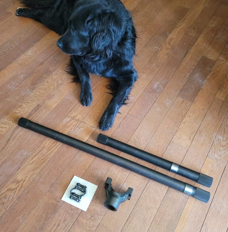

Mark Williams , 300m , 40 spline inners for the front end
& the final yoke / strap kit (also MW)
Bella approves!

Big bell RCV stuff outers. Two reasons. MW inners are better quality and RCV lead times. I can't tell you how many bouncers are calling for MW inners when they break RCV stuff because of those reasons. There is a lot of RCV outer and MW inner setups running around, it's just not talked about.

2-3 weeks lead time on custom length, double spline shafts from MW ; I've seen more guys than I care to count wait 3-4 months on custom RCV inners
I don't care what kind of warranty you have , If you have to wait 3-4 months for a part , I'm out
I also believe MW makes a superior product
It also doesn't hurt that MW 300m is less expensive than RCV 4340
Had there been more options at the time, I would have went with another 1550 sized (outer) shaft
Ouverson didn't seem to need my business enough to return my calls , so RCV it was since the 47 spline (outer) game is limited

Max 42° with a 40 spline inner shaft
