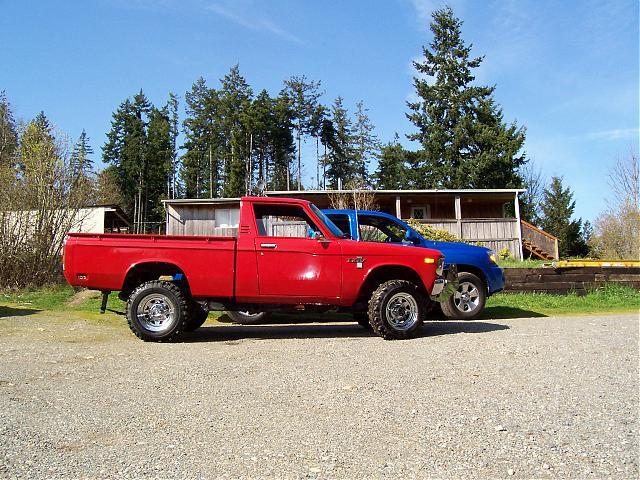

Looks nice Diggin the Luv, Heres my sisters luv, I know you wish yers was this badass:redneck:
