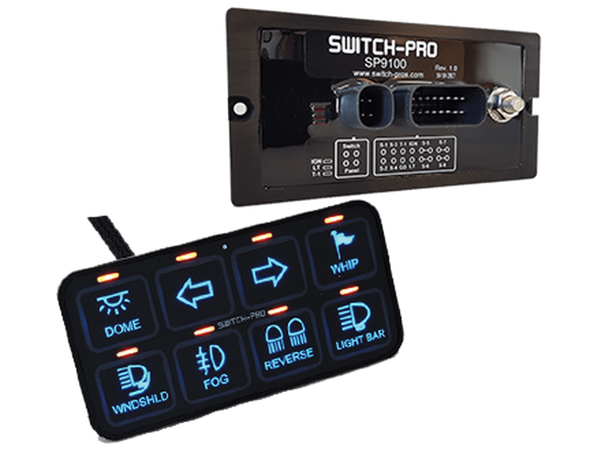

For that kind of money though I think I'd rather have the Switch-Pro 9100 pdm with a seperate red start/kill backlit rocker. If you get them on sale like Black Friday or something it doesn't hurt so much. View attachment 121860
These are nice and I have one I plan on using. Need one outside of Black Friday, happy to help. MSR makes a nice led light up relay as well.
