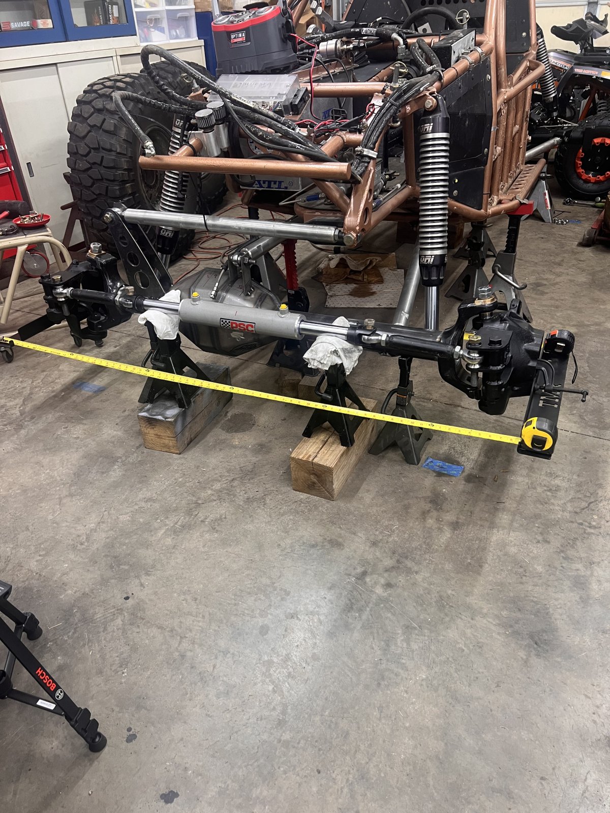

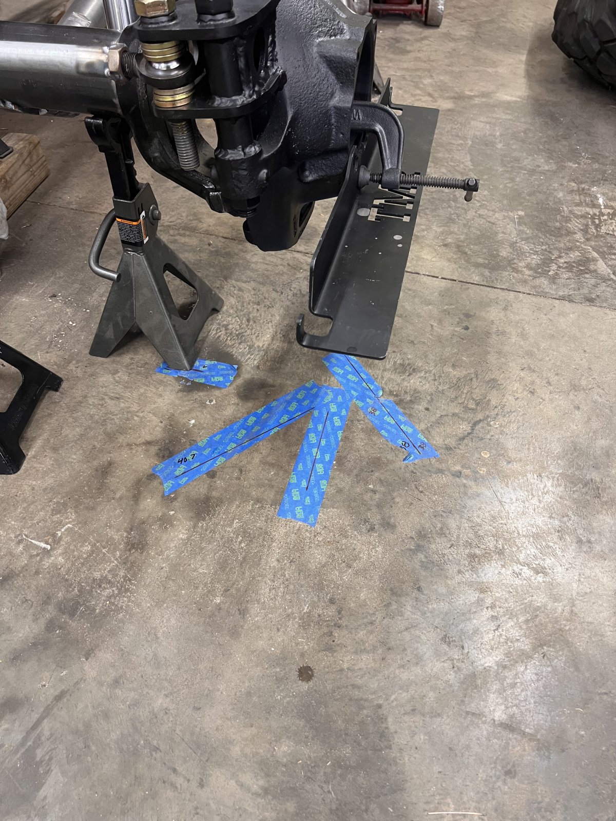

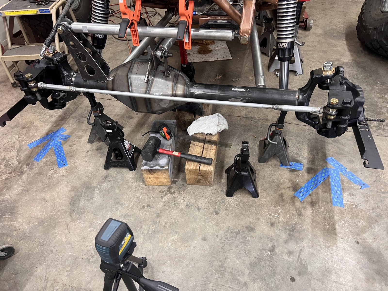

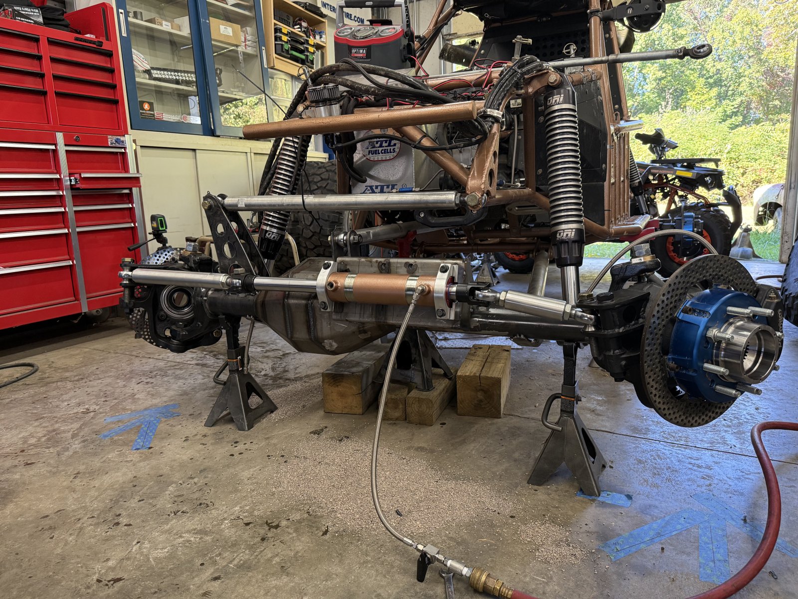

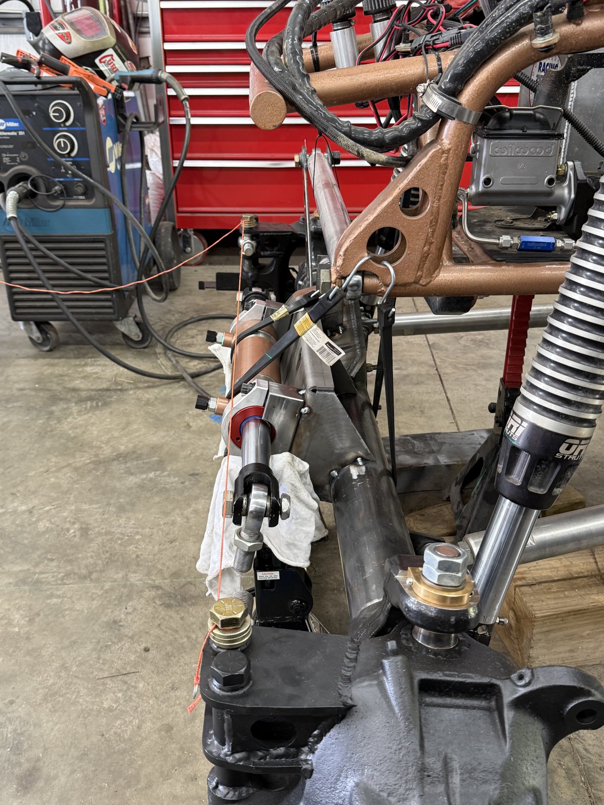

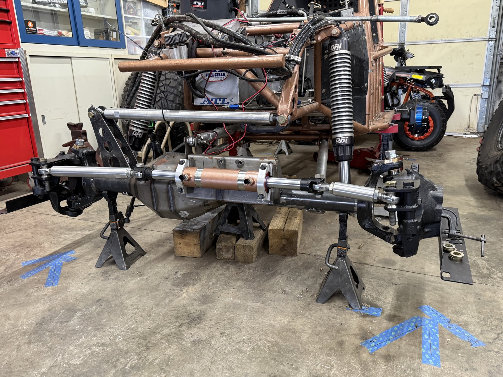

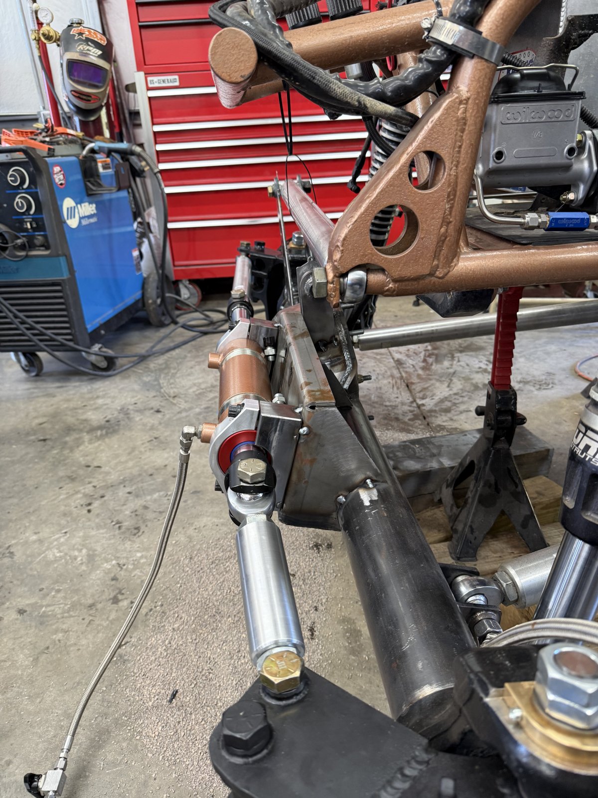

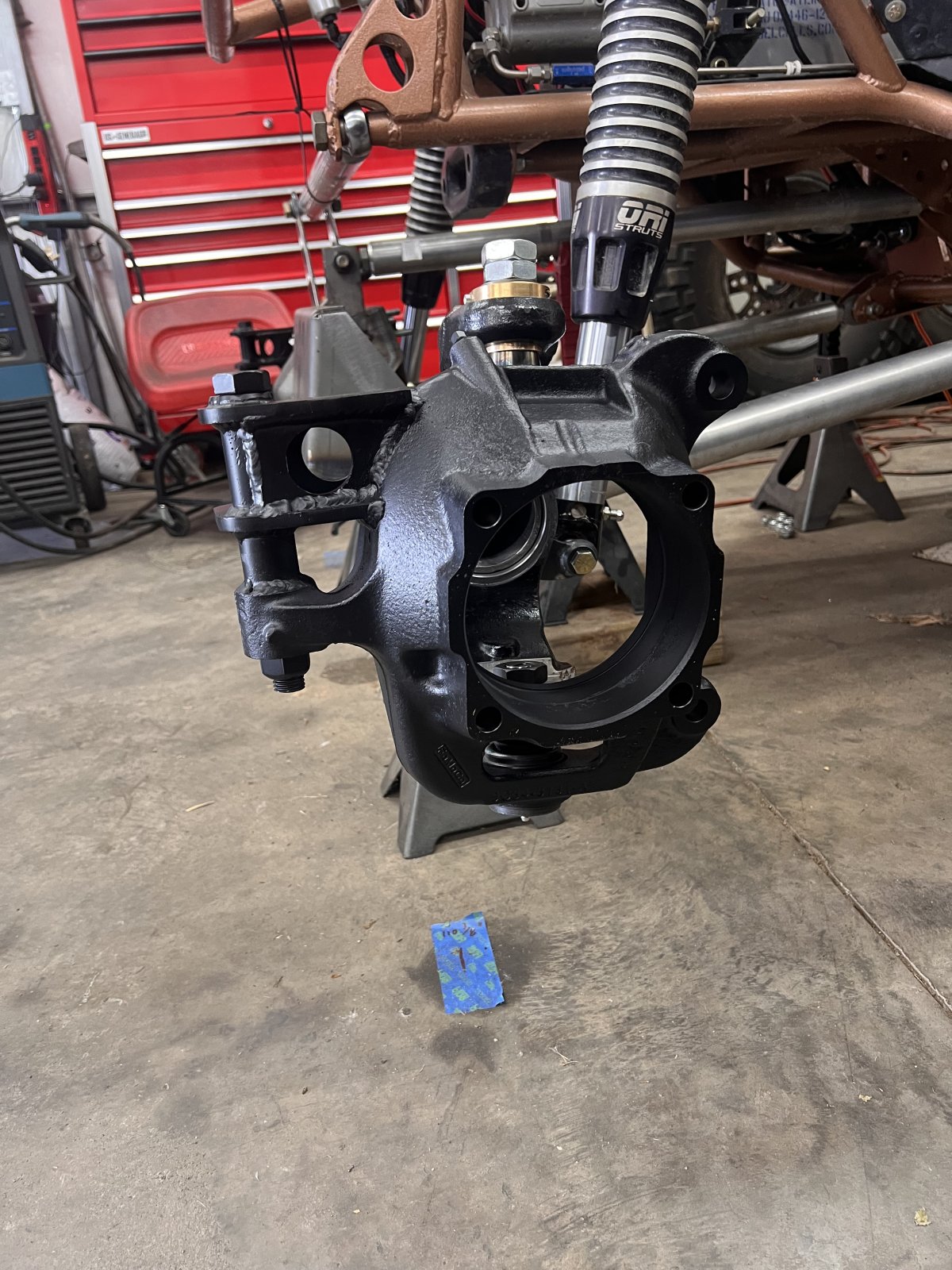

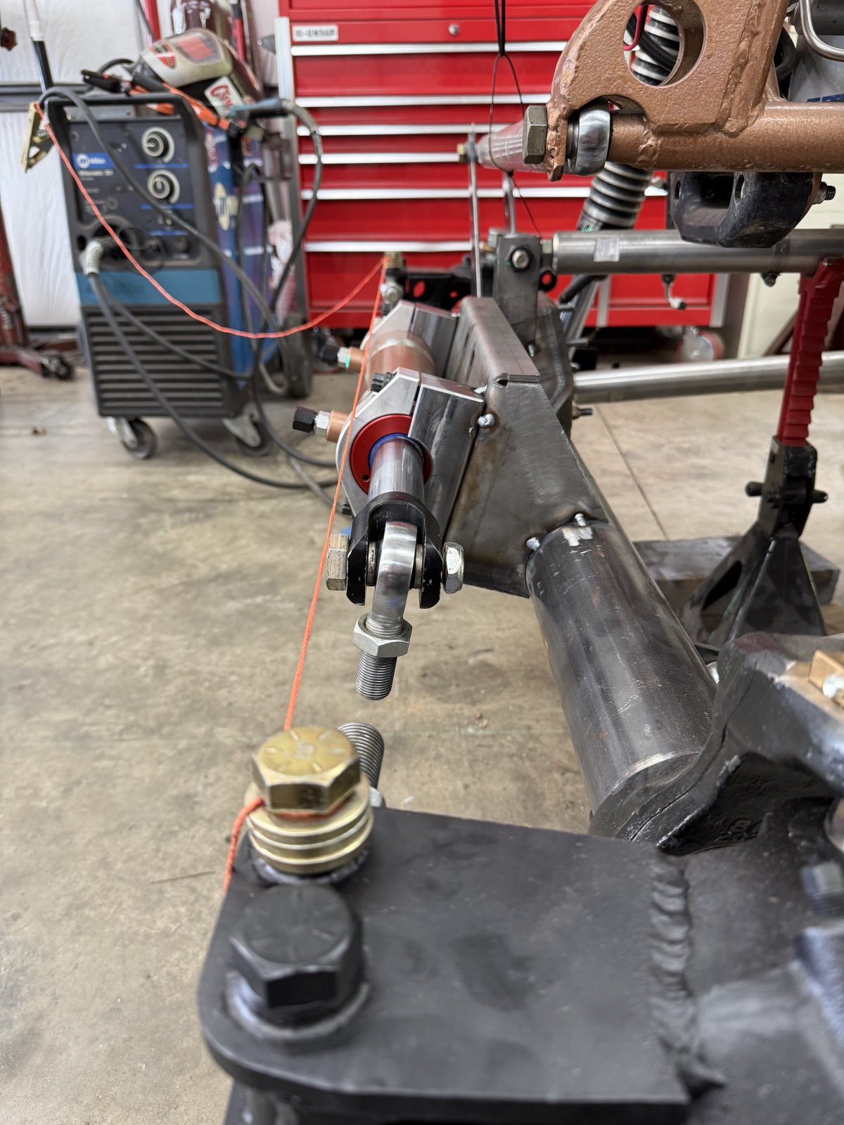

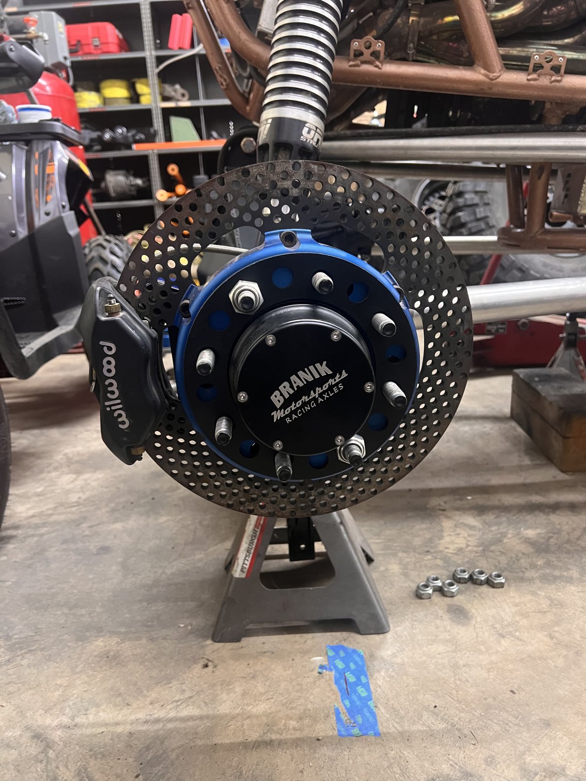

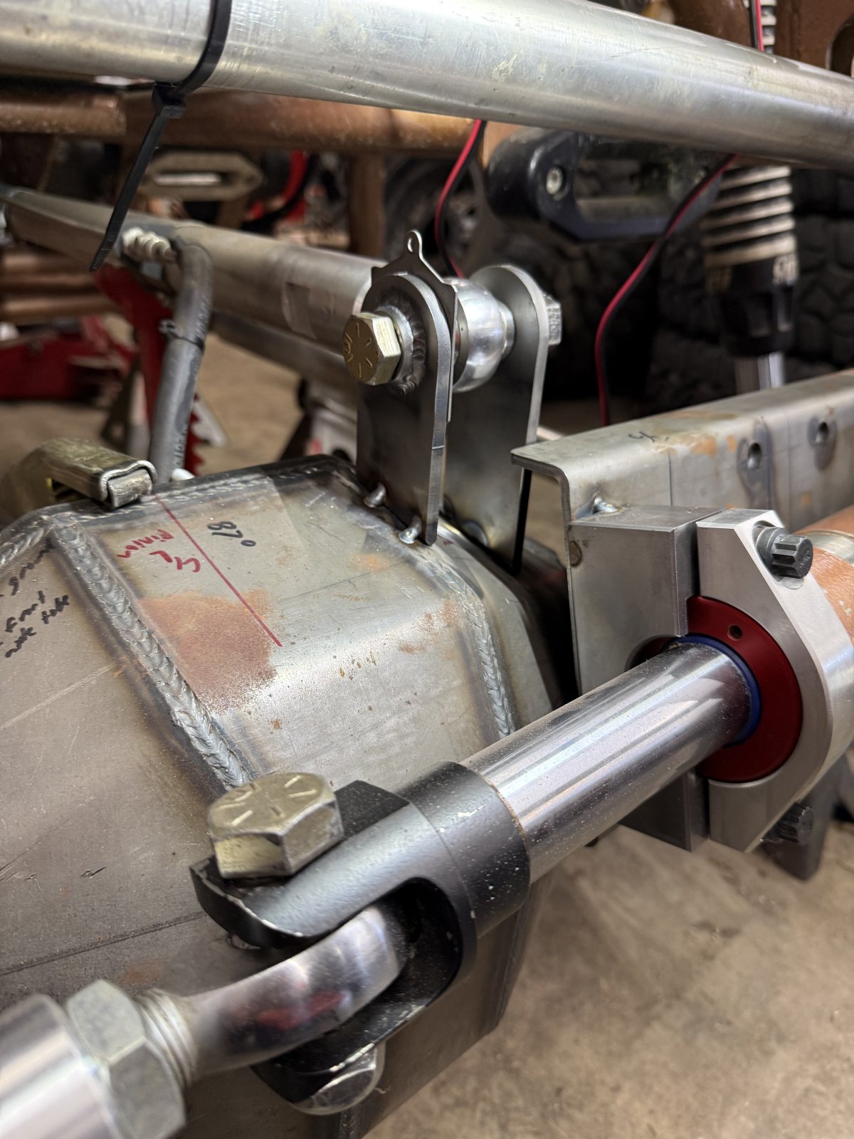

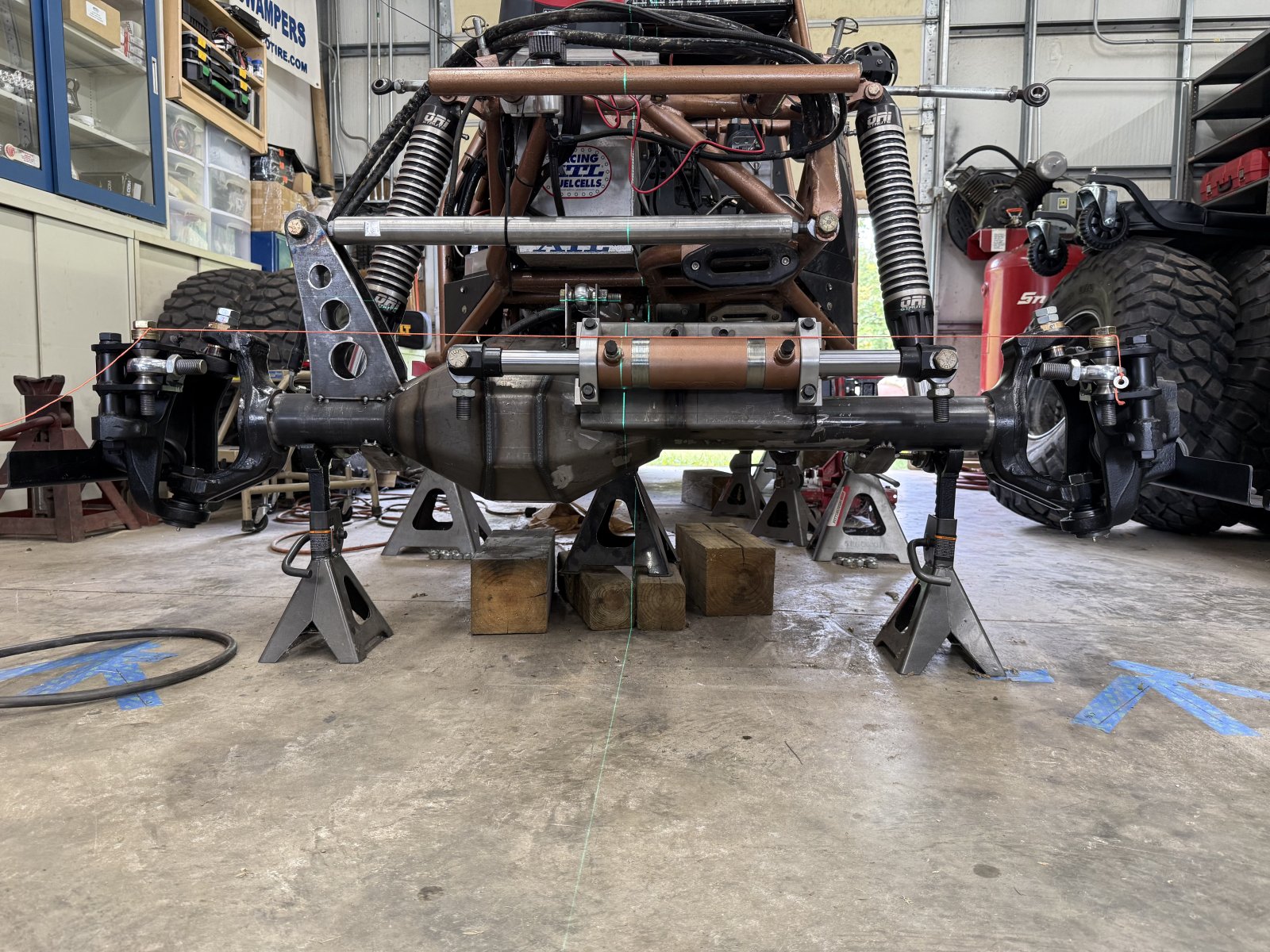

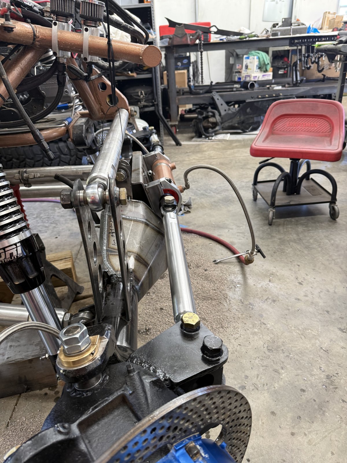

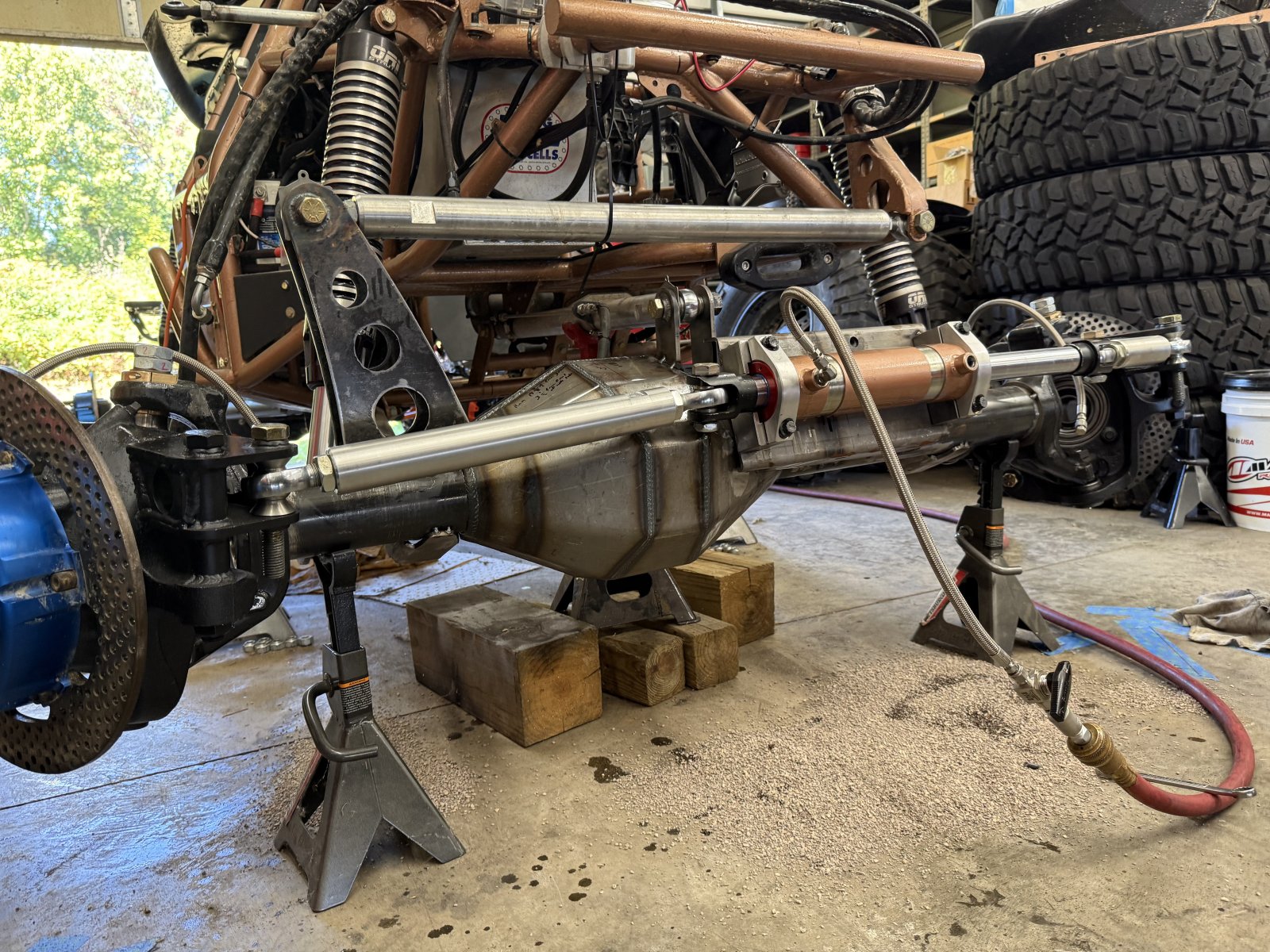

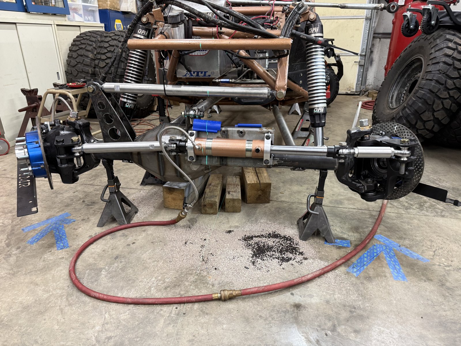

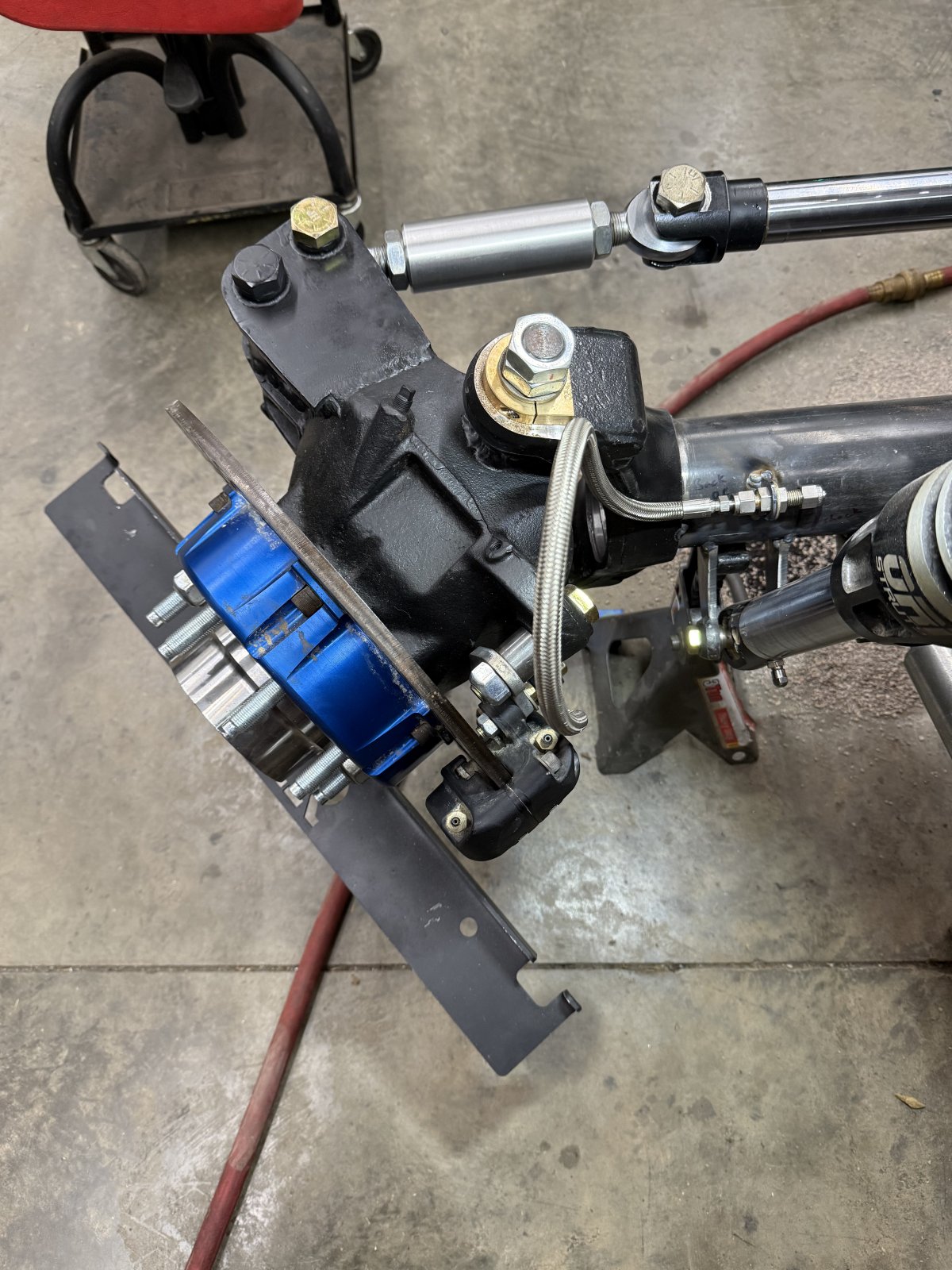

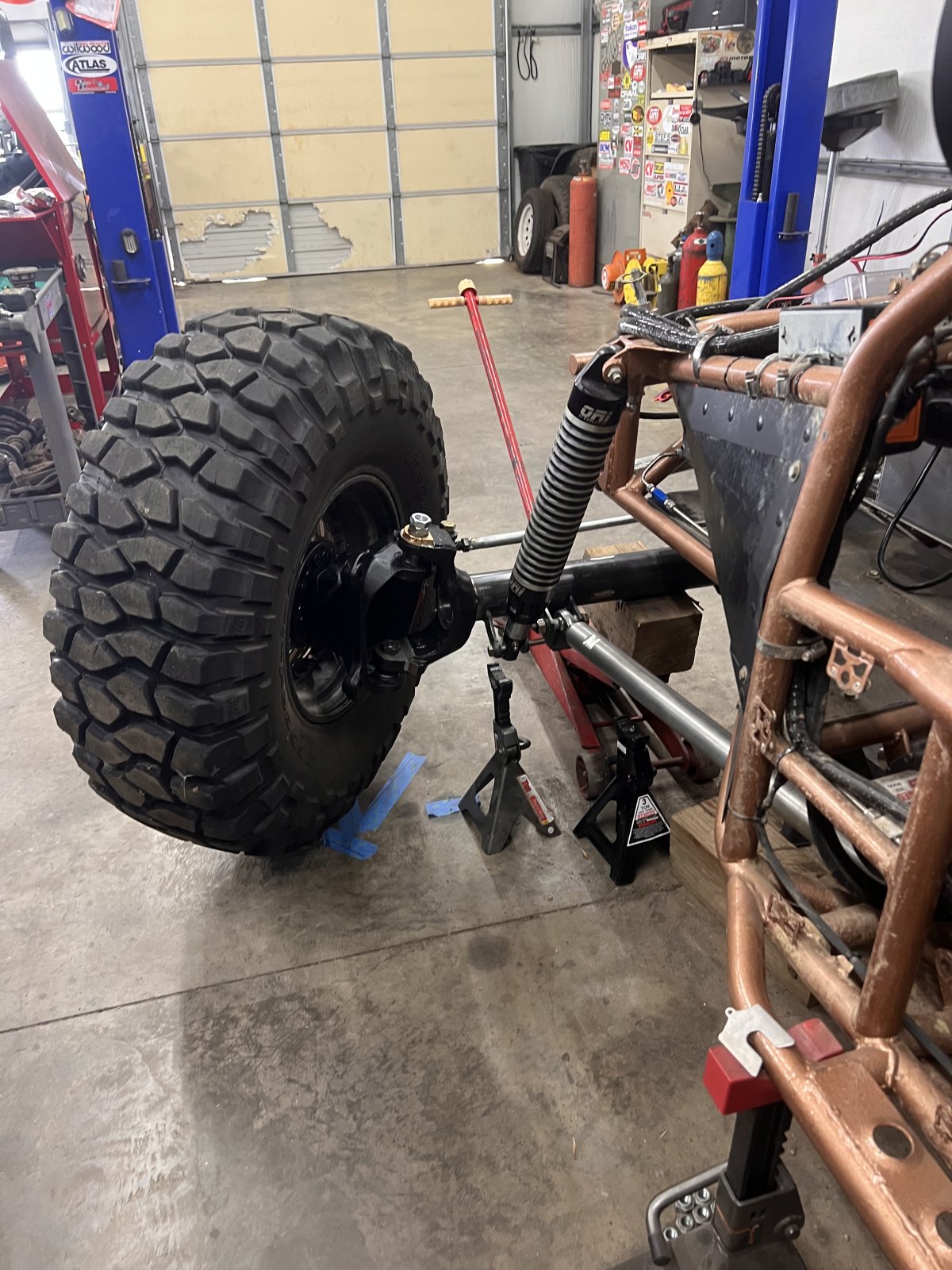

It's tight, but I can turn it by grabbing the knuckle without too much effort. I had to loosen the little plastic plugs in the ports though to let the air out. Before that it was difficult.

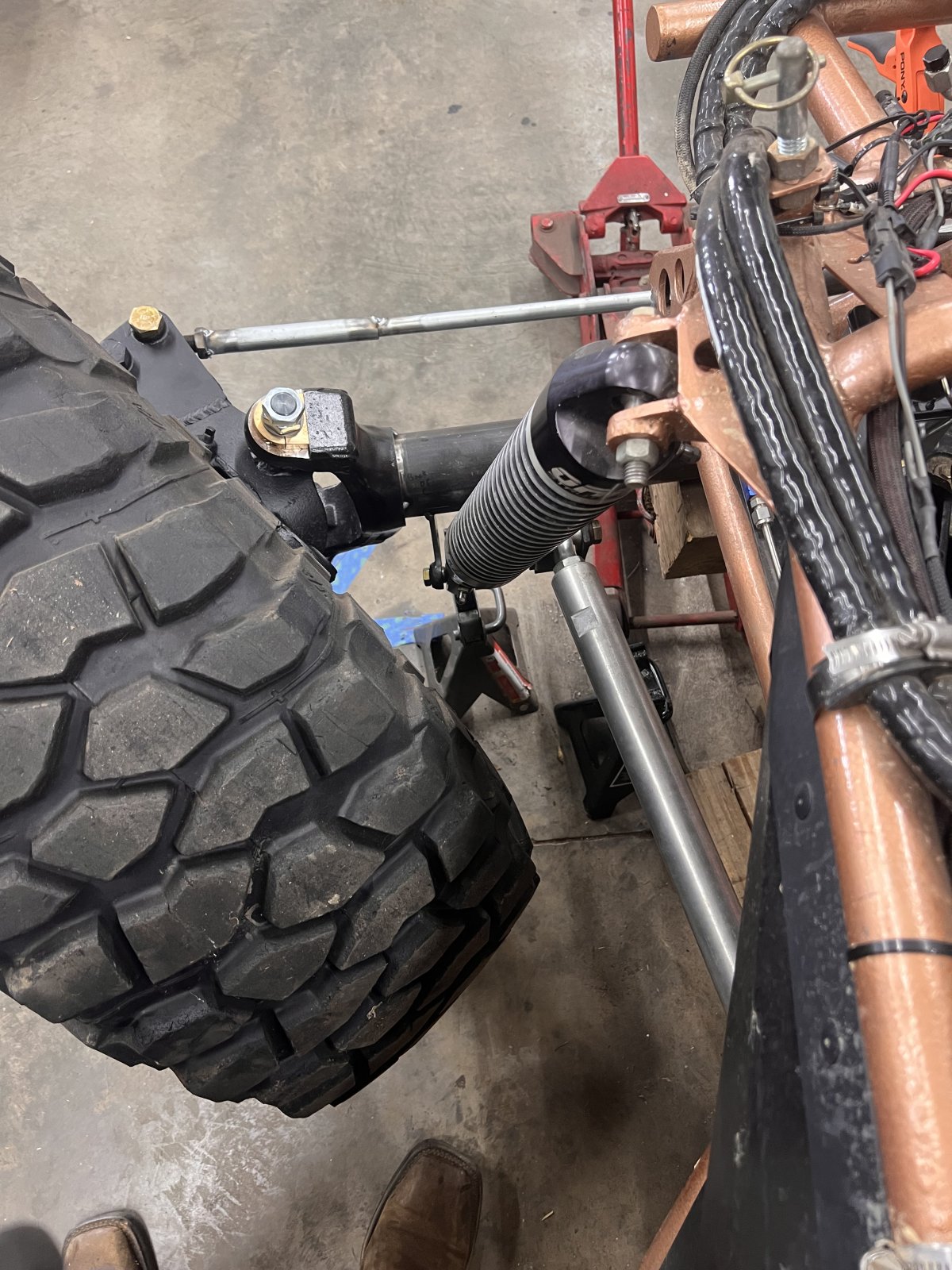

When I was checking the steering clearance at full lock I used an air hose to cycle it back and forth.
Yeah thats what psc tol me to do. Thanks

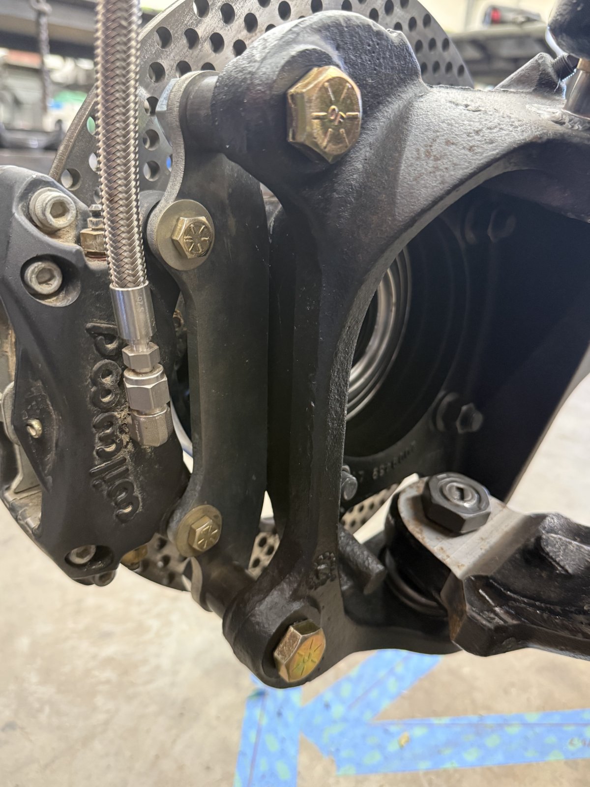

Well after 115 days of the nightmare at work I've finally been back on my regular schedule for a couple of weeks. I've managed to find a little time here and there to get in the shop and piddle on this thing.
I got the headers installed.

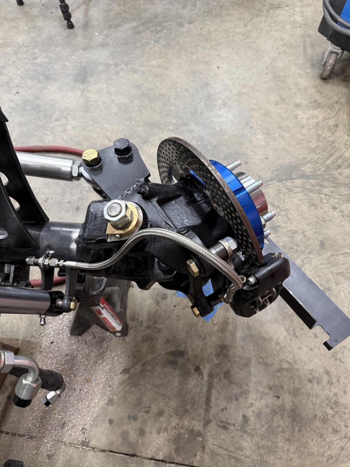

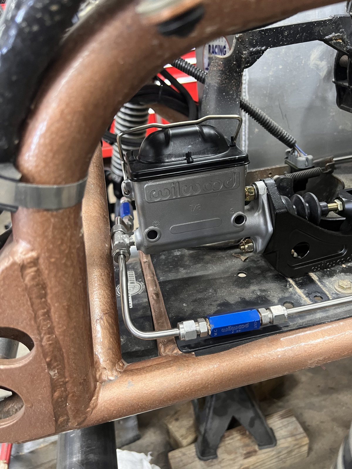

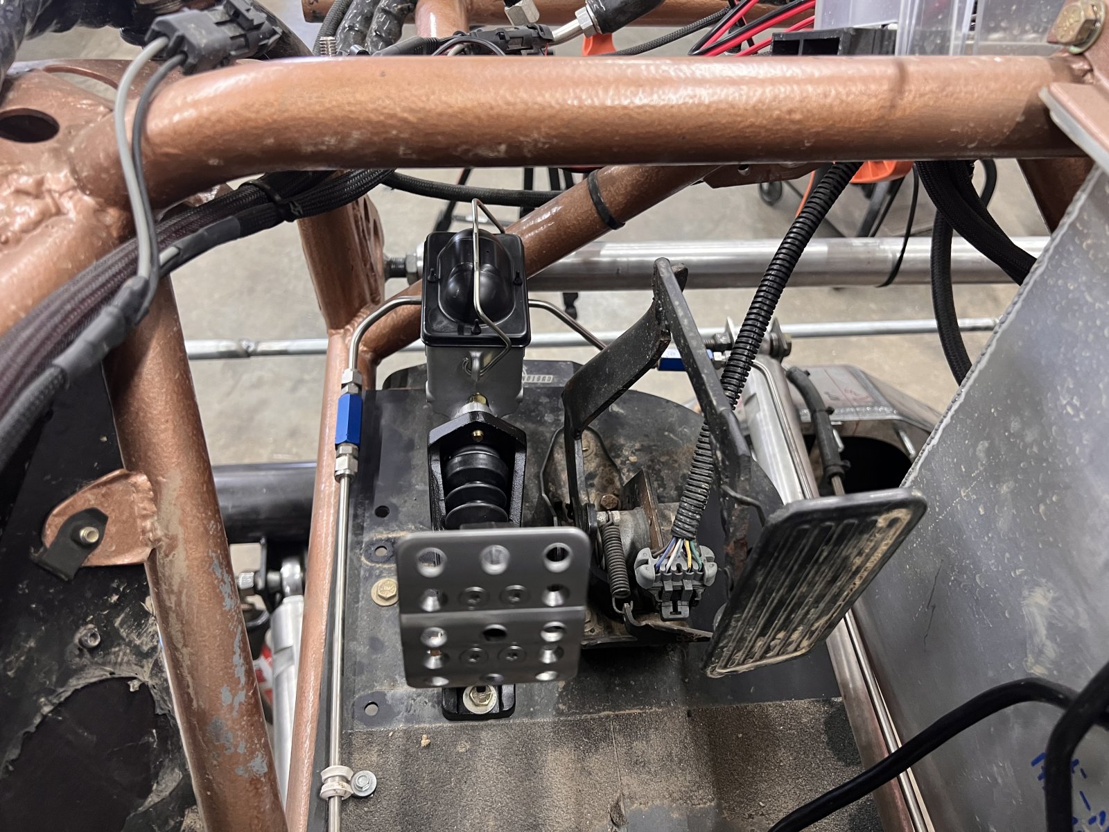

And the brake lines buttoned up.

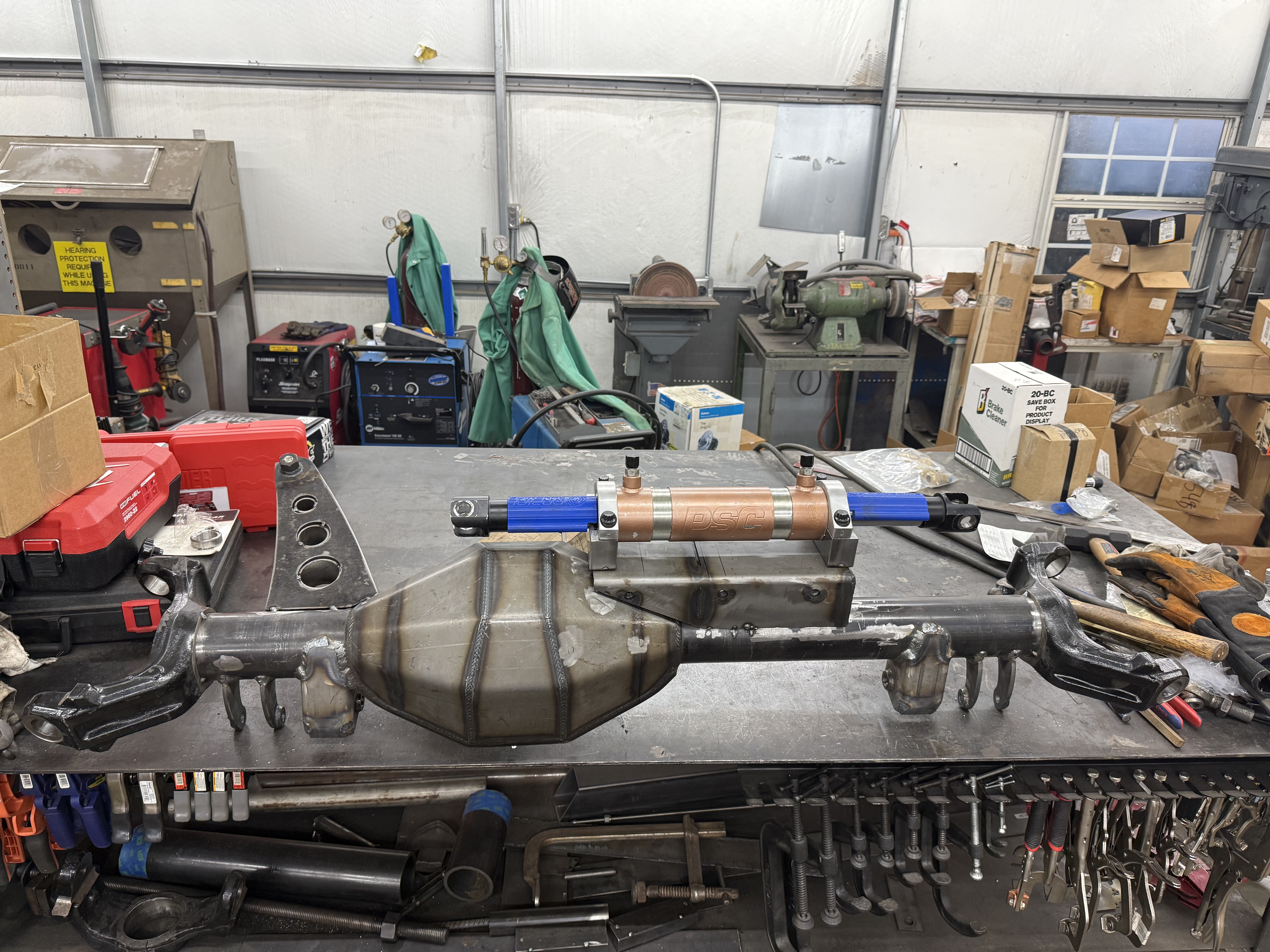

Also got started on the new longer rear driveshaft. The tubing is cut, just have to fit it all up and weld it up. Originally the front and rear shafts were the same lengths, but moving the rear axle back ~ 8" necessitated a longer rear drive shaft. The old rear shaft will be a spare front now, and I'll eventually build another rear shaft for a spare.
Still have quite a bit of plumbing to do. I miscalculated on the fittings and hose I was going to need so I had to order more stuff. Most of that was delivered today. Then I guess it's on to wiring.
