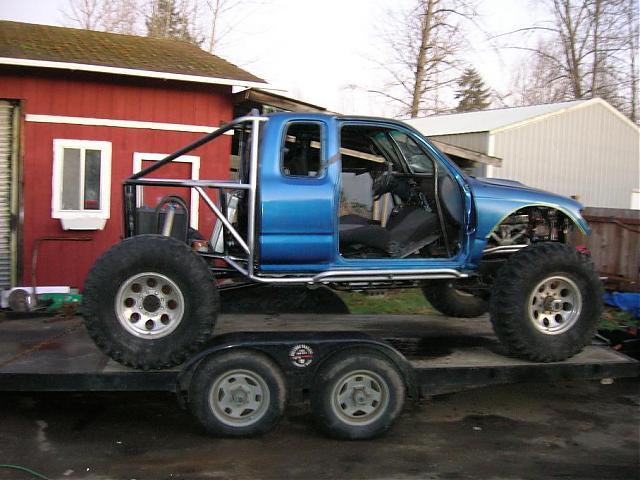

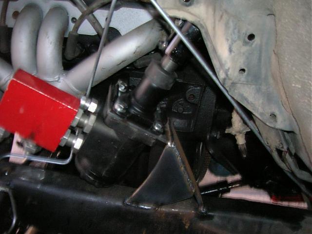

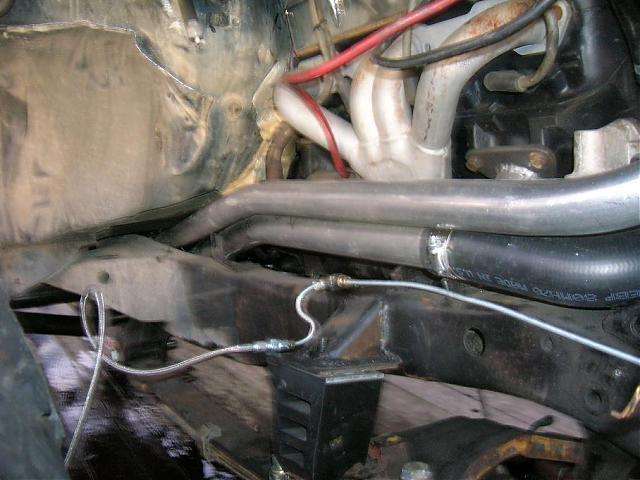

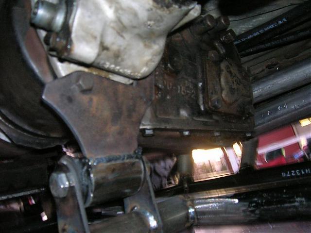

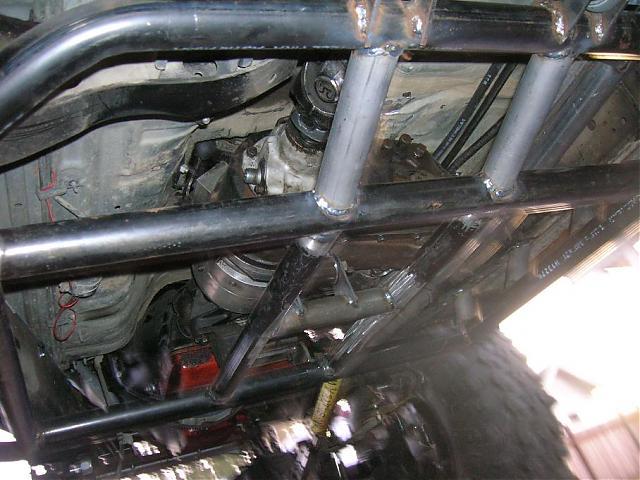

Its going to Pats on the third.I was going to take it to crash but Im running out of time and never got a set date.Pat is going to do drivelines...coolant lines ..... tranny lines.....brake lines.... fuel line and steering.

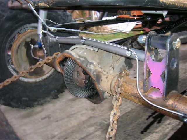

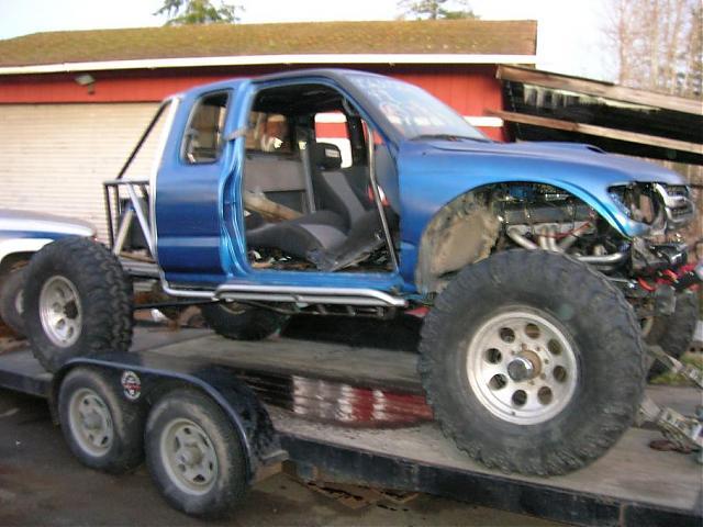

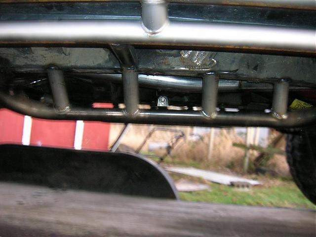

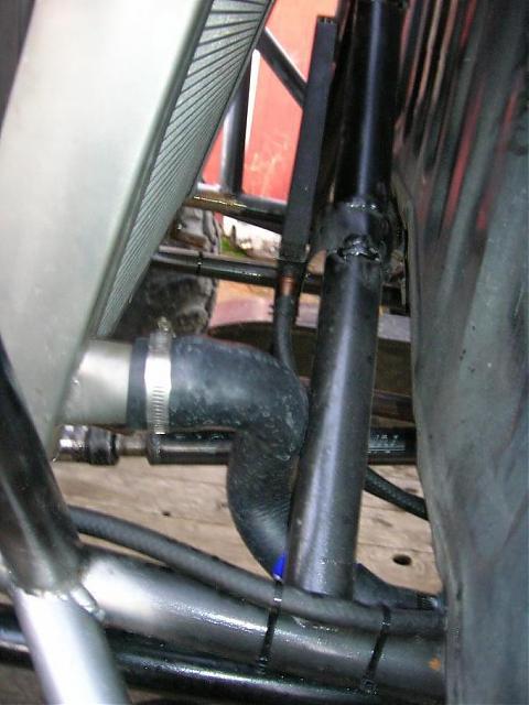

Well i got it back from Pats ( Those Guys Rod & Customs) . Pat ran brake lines...coolant lines...tranny lines...drivelines....welded the rear diff and reinstalled the ring gear and carrier...beefed up my belly pan...mounted my orbitral and ram....made a transfercase mount. I couldnt be happier. Thanks for dealing with my p.o.s and my shitty fab skills.:awesomework:

All the fluid on the trailer is because i didnt have a dipstick in the tranny and it spilled out when we drove in onto the trailer.
Im color blind so im afraid of wiring. So Im going to have Jp finish up the winch wiring...tempgauge and oil presure gauges. Then i need exhaust and need to put the front axle together . After that its ready to go i think. Bet most of thought i wouldnt finish ... :corn:
I would so something about yout rear link bracket capture plates, I see upper tower's peeling off in your future.
Looking good! :cool:
:awesomework: I ripped mine off when they were like your's, Brian. It took awhile.....but it did happen.
Simple fix though.
Looking good.....Am I missing something or do you need to take the transfer cases out thru the top or cut out the skidplate tubes? I do not see where the tubing unbolts:eeek:
It will come out the back.
