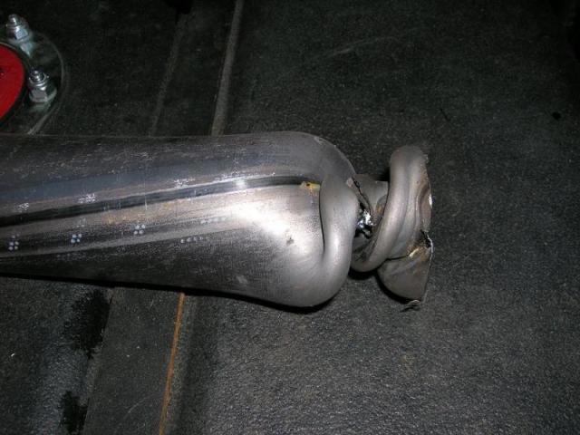

Still cracking away at it. I broke a driveline in the garage already. I also bought a bad transfer case off of craigslist so I have to replace the gears in that . It seems that i get a few steps forward and have to step a couple back. It WILL be done for KOH. Thanks for the comments guys.:awesomework:

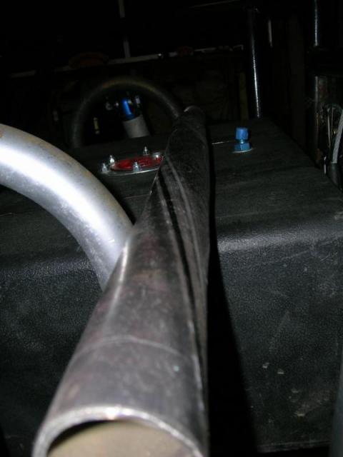

that looks like stock driveline material? what are you going to try next:corn:
It measured out to be some soft schedule 40 pipe. I built a none cv drive line this time with 2" schedule 80 .218 wall.
