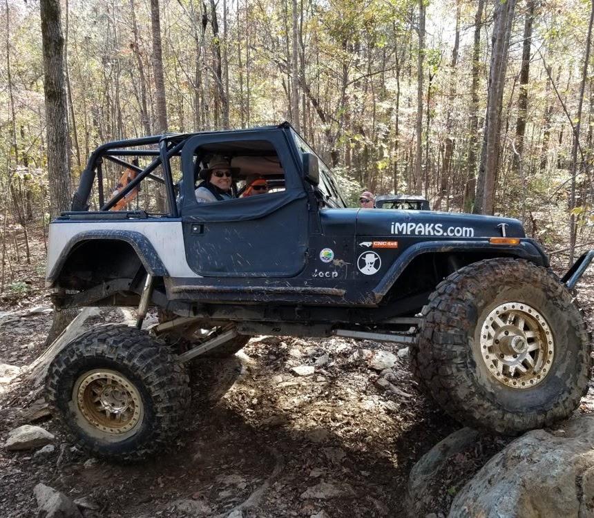

WOW what a weekend..
Thanks MotoBilt for a great 4 link kit

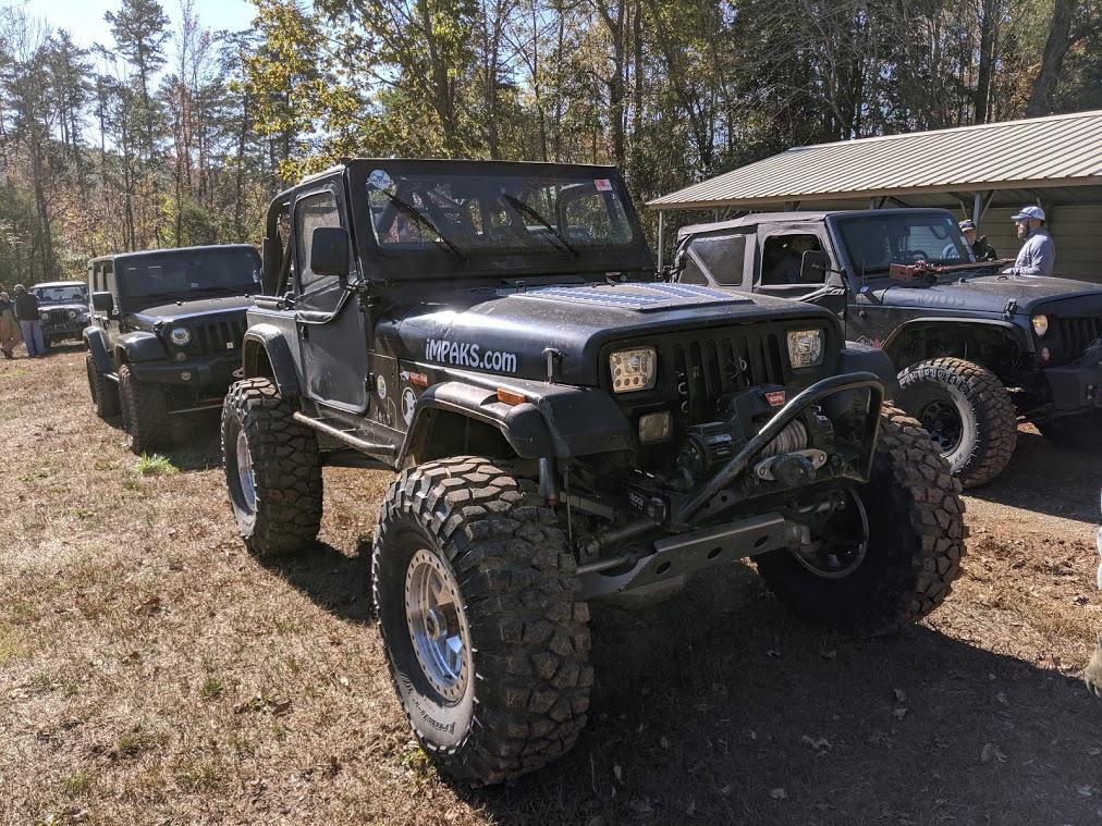

Took the kids and the jeep out to out clubs fall bash and had a blast..
The jeep did great with only issue the rear air shocks settled a little but nothing some nitrogen could not fix when we got back to camp.
here is the jeep at camp
here is our camp
I joined the "easy" group because I had the kids and did not want to push it to hard on the first trail ride. but I could have done the hard as it walked everything i tried with no issues..
My son enjoying the ride ( he kept saying this is AWESOME )
stopped for lunch
when we got back to camp we had some field games and I got a pic testing the flex on the rti ramp.. I ran out of rear shock or it could have kept going..so hopefully I will get some good pics of it really rock crawling on next trip out with just the guys
even won one of the field games with the jeep :)
