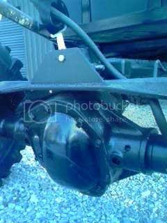

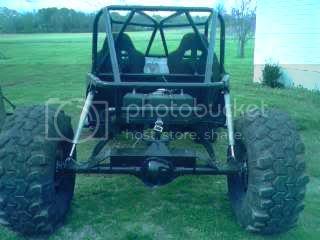

It turned out pretty good. I have to redo my rear truss and tie it into the rear diff cover and replace the lower link bushings... other than that, she is ready to go. :****:
and for those people wondering if the 2.0s would work good, i was very impressed and after washing it today, they look fine. :dblthumb:
fawked truss
wontwork said:
Box it in and lower it on the housing.
it was completely flat..
It was caused by dropping the clutch several times in a bad way..
It will be boxed in when all said and done.

I would mate it all the way across the the houseing due to the abuse you are gona place on it in the future.
why not tie it all the way down to the axle tube?
had a feeling that plate truss wouldnt last...build one similar about 6 years ago and it did the same thing...just warped up...

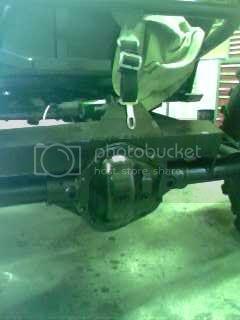

small boo boo that i figured out over the weekend. :flipoff1:
When i redid the rear truss, i cut the old top link tabs off ,then strapped the top link johnny joint up to the bottom of the cage.
Well, i never noticed that i let the jeep lean to one side. We welded the the top link straight back down to the top of the truss without checking center. turns out it was nearly 3 inches from center. :gtfo:
it is nearly fixed now , but caused me a major ****ing headache after tryn to figure out why my shocks were not matching anymore. >:(
