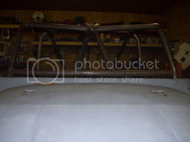

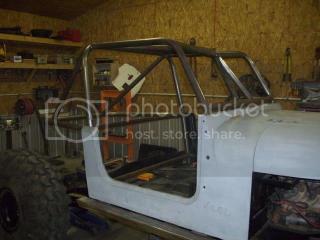

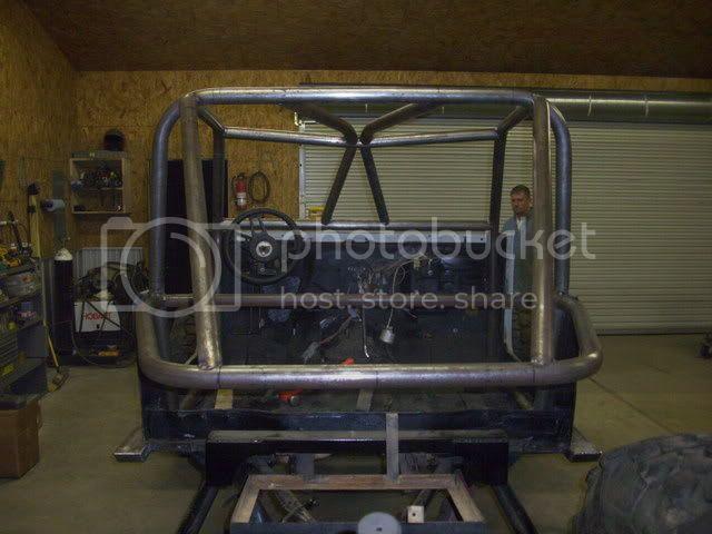

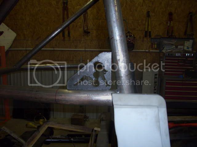

Can you get your cage done in time to make the Shamrock run at Morris Mountian with us?
dude, get rockin. gotta make it for st.pattys ride.!
my **** will be done. i'll be peelin the **** out and rockin out.
