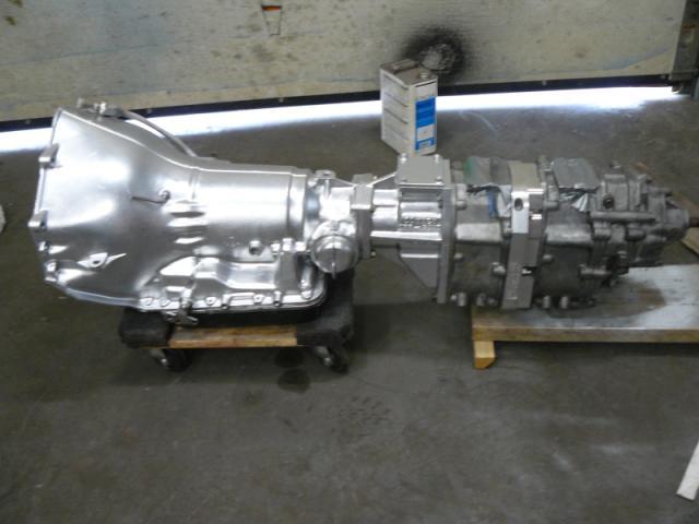

heres alittle pick for ya money. . . turbo 350 to dual yota cases seems pretty long. . .

Ya.....:eeek:
The point of having duals in a Yota is the weak 22RE, but also the manual tranny aspect. If my rig had an auto I'd only need the rear 4.7 case. I'd be driving a gutless pig in high range.......but what's the difference, really.
