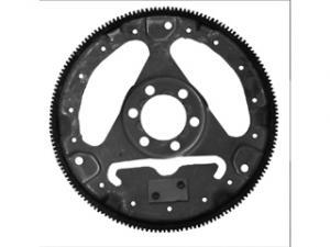

I can show you the balance weighted flexplates/flywheels and harmonic balancers. When AMC raised their V8 block height (made the 290 into 304, 343 into 360 and made a 390/401 casting which looks the same as the others but is internally different) they changed the offsets of the spinning weight of the engine. They just went to an external balance rather than re-balance the whole line (made sense at the time)
You can rebuild any of the AMC motors and have them internally balanced for @$350 extra per motor.
Went to Rockauto for part #s.
'72 304 with 727 or 999 auto: DORMAN Part # 04302
{Gear-Up! OE# 3232140, 3232139 Hollander # 409-503 Teeth 164 Pitch 12-14 O.D. 13.83" With Weight #3232140}
'72 360 with TH400: DORMAN Part # 04303
{Gear-Up! OE# 5351821 Hollander # 409-553 Teeth 164 Pitch 12-14 O.D. 13.83" Without Weight #5351821}
'72 401 with 727: DORMAN Part # 04036
{Gear-Up! OE# 3214090, 3232141 Teeth 164 Pitch 12-14 O.D. 13.83" With Weight #3214090}
'72 401 with 401: DORMAN Part # 04369
{Gear-Up! OE# 5351822 Hollander # 409-554 Teeth 164 Pitch 12-14 O.D. 13.83" With Weight #5351822}
The pic shows a TH400 flexplate for 360 (note the cutout in the bottom of the pic is nearly full. The 401 version is almost solid and 304 version has more cut away. 6 cyl is fully open) I found this out when I converted the 304 in my '73 J4000 from 727 to TH400 and I had a bad vibe when I revved the motor till I swapped it out (I tried using the 360 one because everyone said it was the same)
