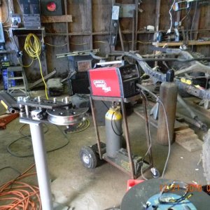

Very large difference in a hand operated torch and some stock wheels. Rotten apples vs Apple pie! :drinkers:
But if you eat them both comes out the same ****
BUG-E J said:
When people say prep work is more important than the actual welder you laughed in their face. Way to be a rebel! Rock on
:woot: molaugh molaugh molaugh molaugh molaugh molaugh molaugh molaugh molaugh
Rusty coat hangers work just fine for welding rods too!
