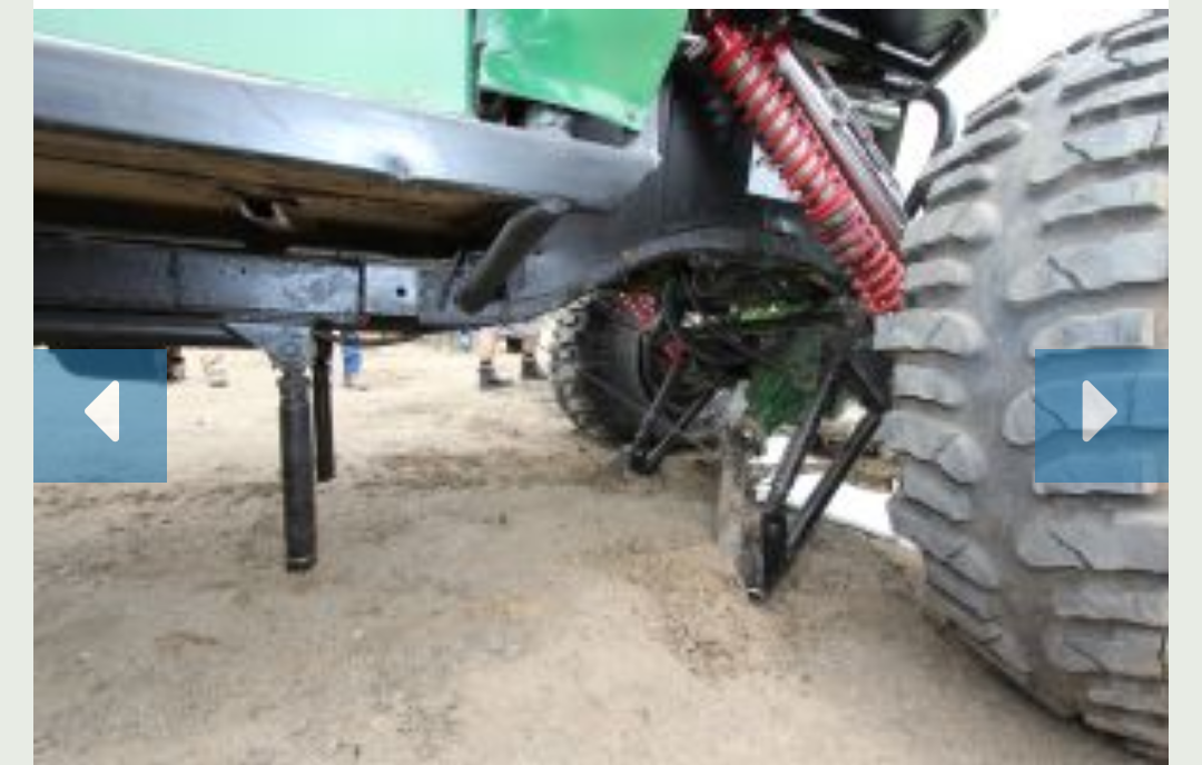

What are the specs on those link bars then, that's what I asked. They look tiny for your projected dumptruck style setup! You can have 1.25 heims all day long, but that don't stop tubing from bending, link mounts from ripping off, or worse. With a big block chassis and them big honkin' heavy ass axles, there will be a lot of force depending on those link bars from both ends!
Lowers are 2x.250 uppers are 1.75x.250
Example of big axles and weak links
Damn, must be the way the pics are, they don't look like 2" tubing! That should hold up alright long as it's DOM!
