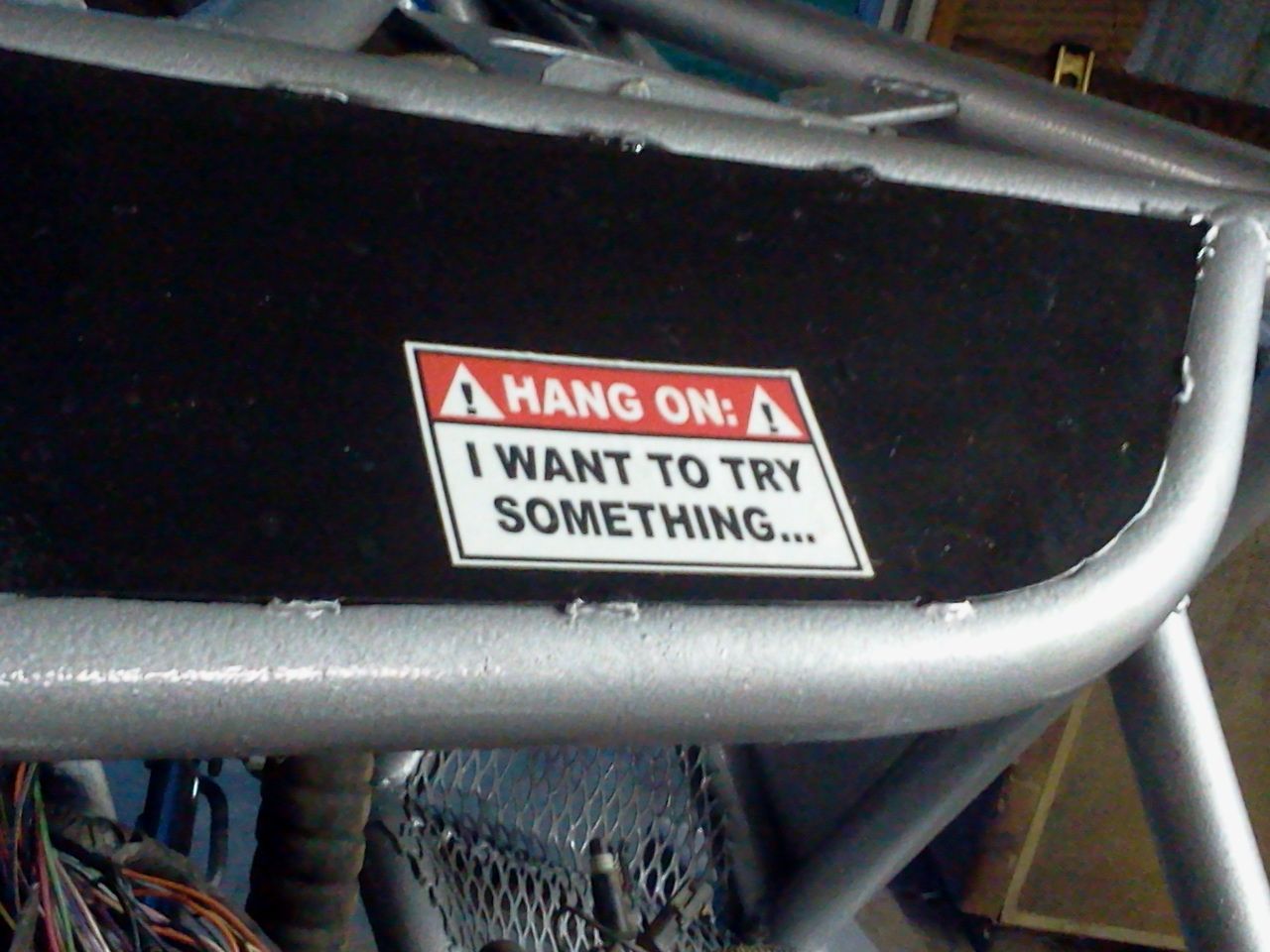

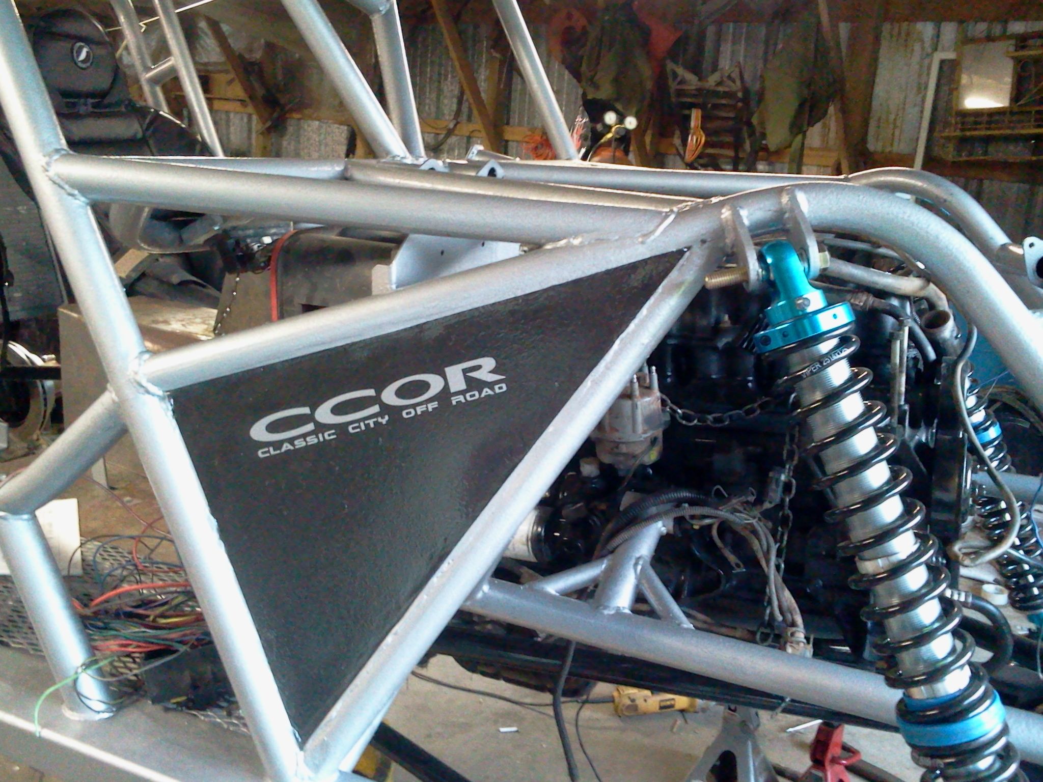

Added a few stickers

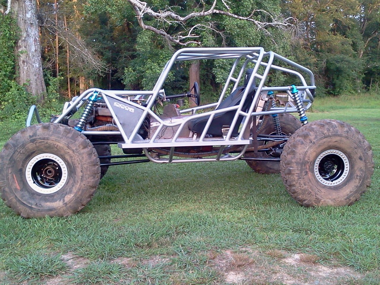

I see a tree getting wedged in between the double B pillar bars, looks like no separation tube between them in the bend at the top :dunno:
Yea that looks a little odd to me too. Nothing in line with roof bar over B pilar. Besides a weak point in it for possible collapse, leaning into a tree on an off camber hill side it will become an open catch gap. But hey, just my opinion.
