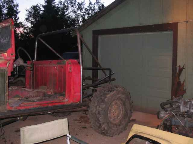

did some playing last night.....
think I like the way this is going to look on the bed....
