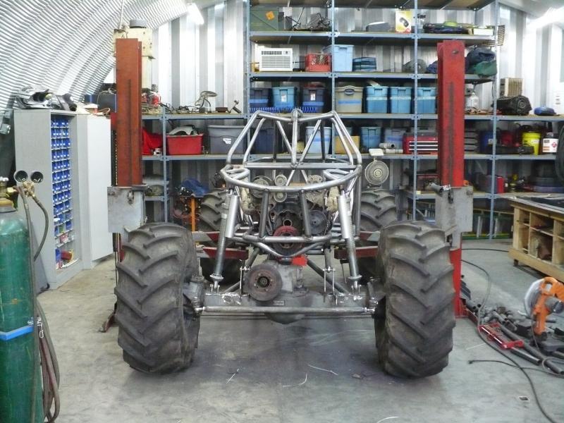

Today we finished the rear motor mounts, the main transmission/transfer case crossmember, mocked up and squared the axles and worked on some front driveline issues. The front driveshaft is going to be really tight but, I'm going to shave the oil pan a little more and gain some valuable real estate. We set the wheelbase at 107 inches, and the belly, at ride height will be about 30 inches. Not bad for 12 days work.

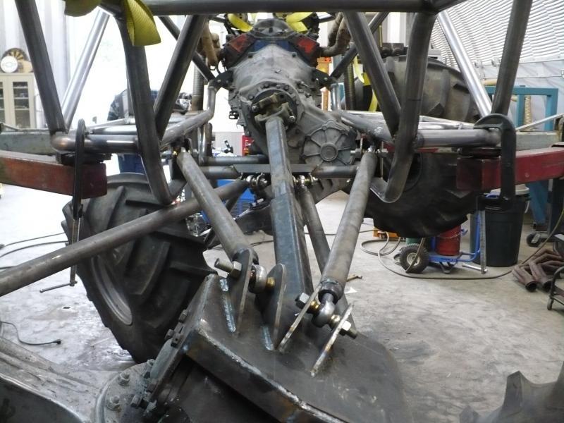

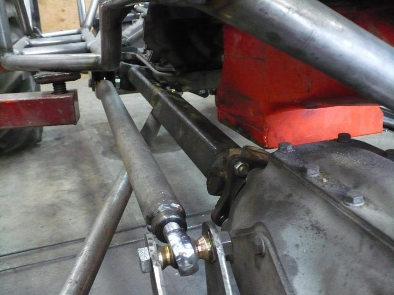

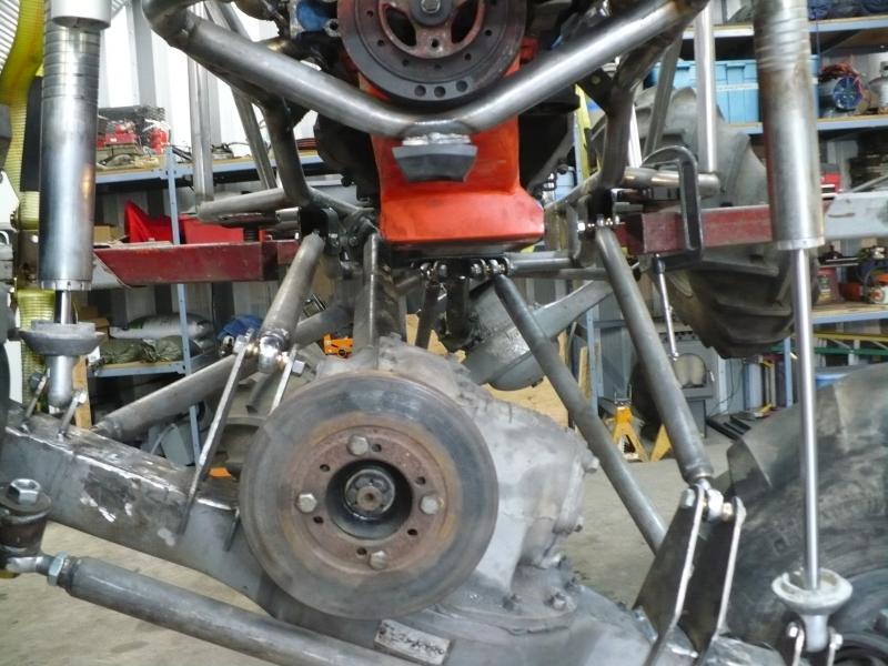

Got the front upper links mocked up and brackets built, still need to box and gusset them but they're in the right spot anyway. Next is the front lowers and a new tie rod.

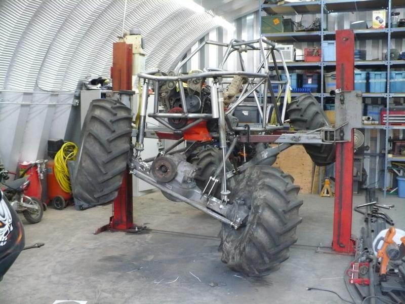

Just curious, is the axle located at the highest point of upward travel?
Looks like ride hieght to me. . . atleast I hope cause if thats full bump then that thing is gonna be ubber tall!!!
