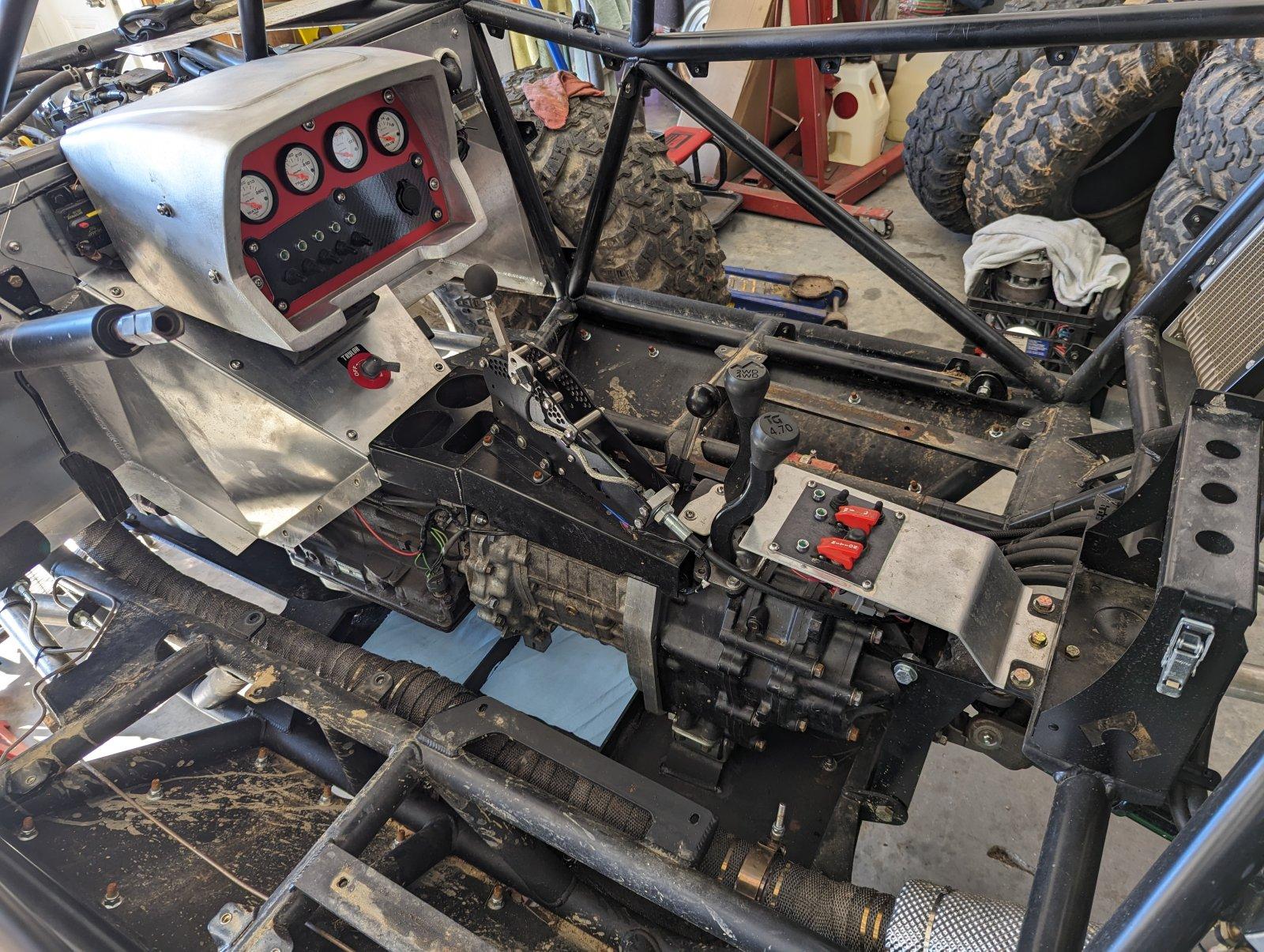

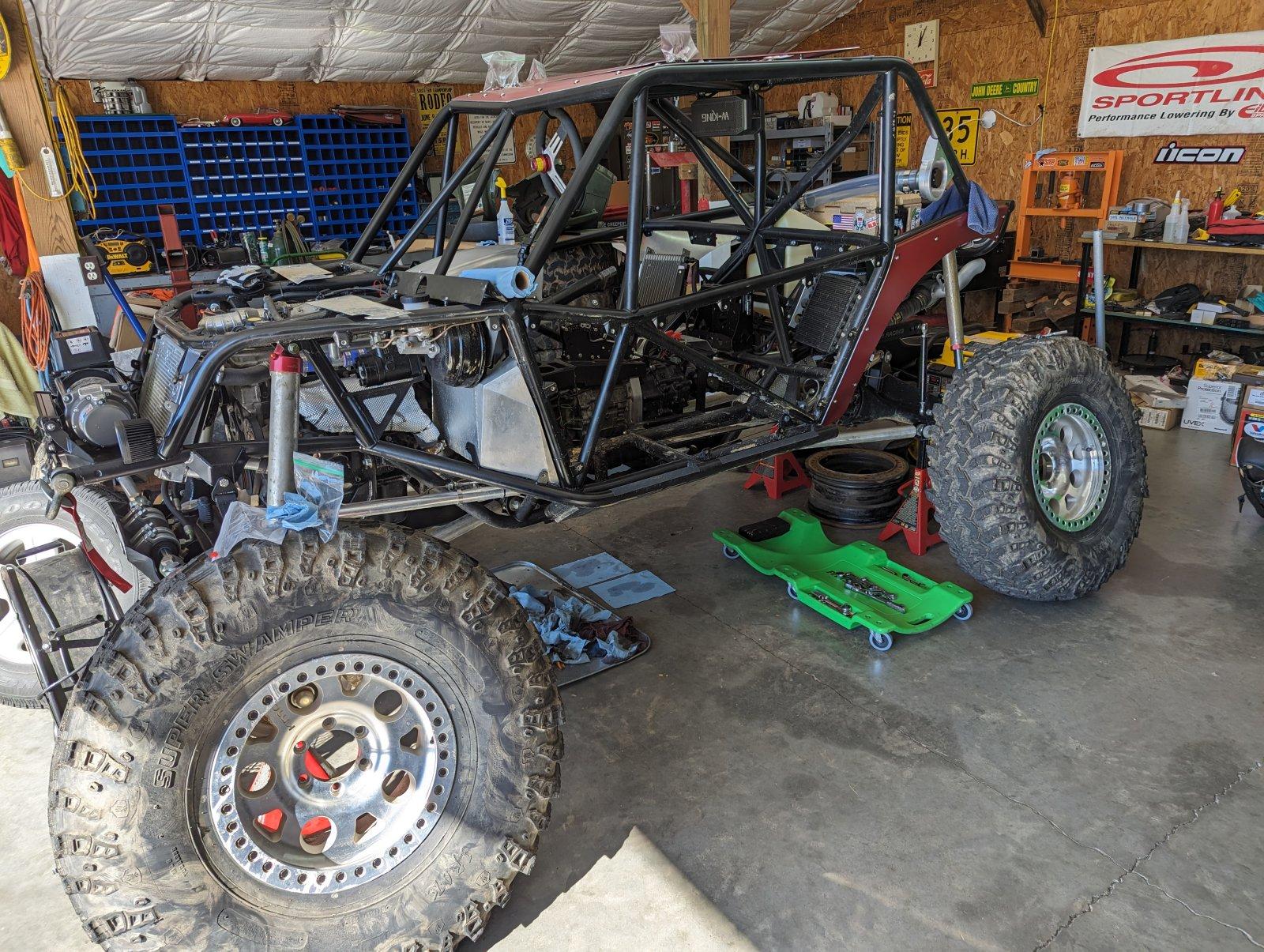

Pulled the interior out. Have a small leak between the transmission and the front t-case to fix. Gonna give it a good cleaning and a nut & bolt check so it will be ready for next year.
