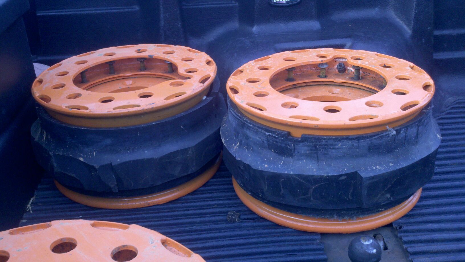

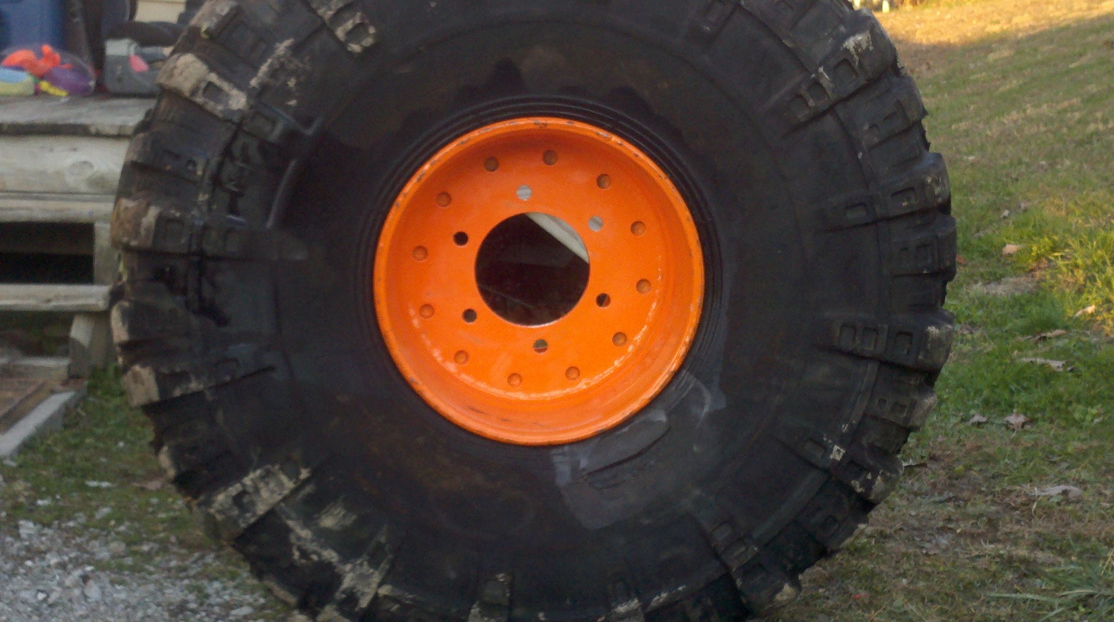

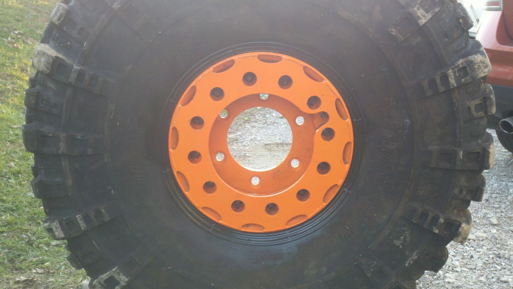

Here are my 8 bolt H1's. The rock rings are 1/4''. They are bowed in from leaning up on rocks. The tips of the studs are almost vulnerable now. If I were to do it over again, I would run some braces from the ring to the outer rim. Another option would be to use bolts instead of studs if they get fubared.
The ones i have and they are damn heavy.
