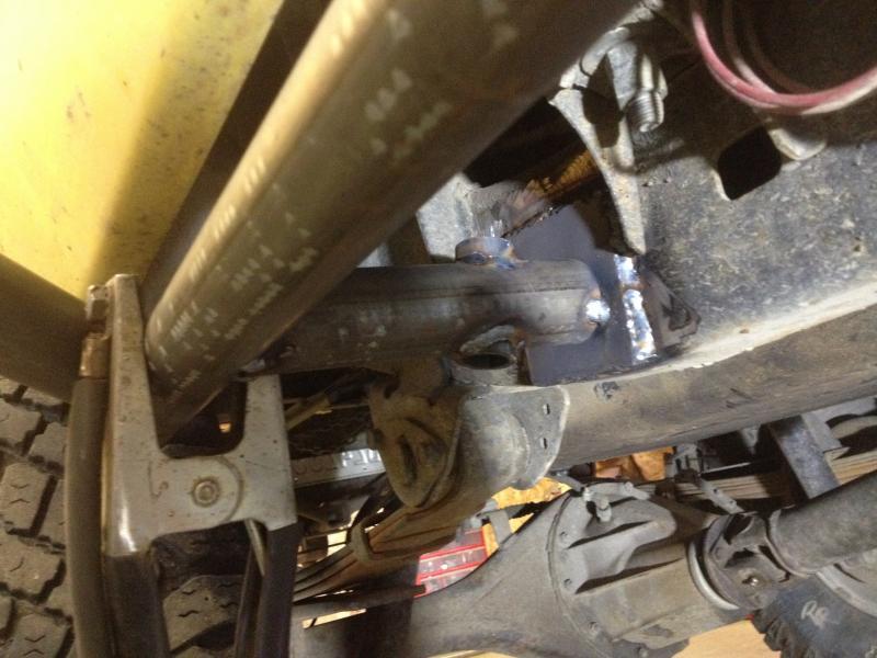

Pugging away on the sliders... I scrapped a few chunks of tube today so I had to do some redoing but all is good now. I bored into the 3 mounting tubes with some 1" DOM to mount the 3/4" LED lights for rock lights... should be handy for those night ops.

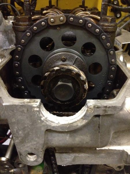

Im not sure what the link counting method is. I put the bright colored links at the bottom of the crank gear and the top one at the dimple in the cam gear. I had to advance the cam 1 tooth to do this. The key in the cam was pointing quite a bit to the passenger side when the crank was set at TDC.

Yes I know that, and it is now. Before it was ALOT left! The notch/keyway for the cam gear is at 12 o'clock now and the dimple and bright colored link is now at the 11:30 area. Ill snap some pics of it in the morning. I have checked DTC about 10 times, I have the number 1 plug removed to check piston since I have the pulley and cover removed now. With the cam 1 tooth off how would the truck act? It felt like it was a slug compared to the 22r I just removed.
Woodruff key on the crank at 12 o'clock straight up is TDC. That should put the cam pin slightly to the passenger side of the top. Roughly where the hour hand is at 11:45. I've never counted a link or paid attention to the bright links, ever without issue. :redneck:
A whole tooth retarded would absolutely kill your bottom end and depending on ignition timing it would likely cause the computer to retard the timing severely.

Ok so here is a pic on how the cam is sitting now that I have moved it one tooth. It is at TDC in this pic. I have not buttoned it back up yet so I could change it if it looks odd to more trained eyes.

Well I got it all back together yesterday and let the FIPG dry over night, filled it with fluids today and fired it up. No issues at all, got it all timed and topped off. I also did a valve adjust while I was in there. Damn thing runs great, way more power.
What I think the PO did was when he hacked at the timing chain and installed it a tooth off on the cam he also had the dizy a tooth off cause I marked it when I removed it. Me thinks this made it run "ok" but not the best. I could feel something was off for sure. No leaks, and runs like a pro now.
