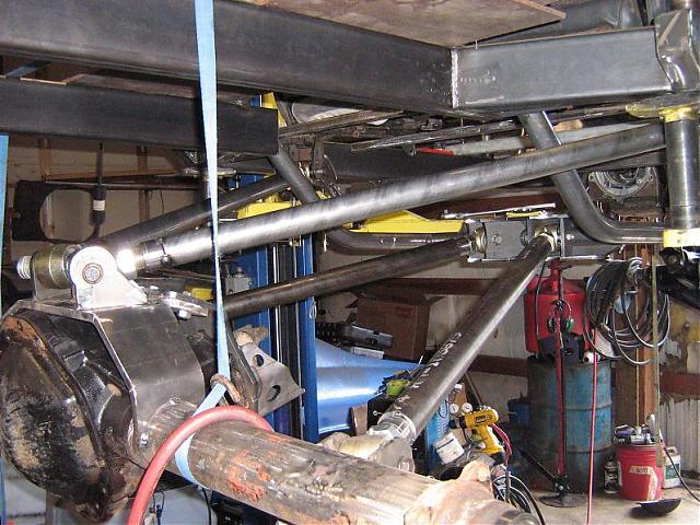

What ended up being the specs on your links...?
1. Vertical seperation at frame and at axle...
2. Length...of uppers and lowers...
Thanks...
Johnboy: I used BTF's 14 bolt truss kit BTF03033, and BTF03060 link mounts. One was in the "TRUSS SYSTEMS" and the other was in BRACKET SYSTEMS. The the lower axle and upper frame where from POLY PERF.
Mark. I got roughly 8.00 inches from the upper to the lower on both the frame and axle. The links are all 43.00" w/ joints. I never tried it out on the calculator. I should see what I get. Phil

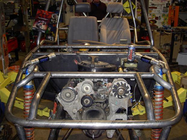

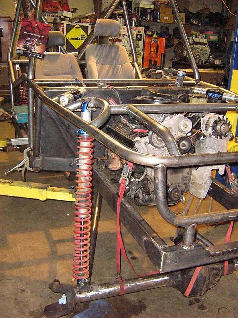

Well went over to toyolets, he's been busy scored on 4 coil over shocks from a good friend, and has been bending more tube!!!!:awesomework: :awesomework: :awesomework: got his coils all tacked in...

:awesomework: Lookin great!!!:awesomework: Alot of progress---I like the master cylinder cover retention device!!!!!!:redneck: :haha:
Yeah, the requirement is a 12 pack or more before I let anyone in the building....:haha: :beer: :beer:

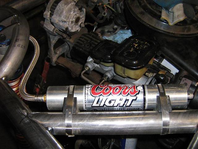

It's here! That cool, refreshing Coors Light TALL boy can with the fast feeding Schrader valve mouth for all your shot-gunning needs. Mmmm.....:alcoholic:
*Mount sold separately*
:D
