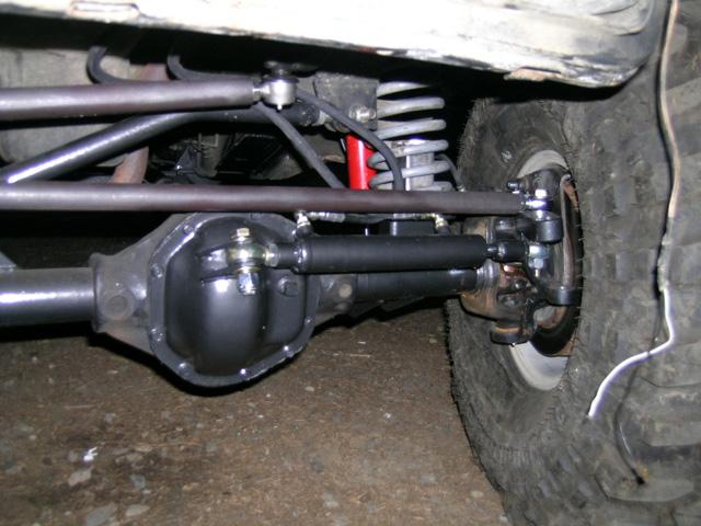

As for the ram---you would be ok to run the top one too...
maybe it's just worth the money to pay the extra $80 dollars and get the TG setup for the ram. it has dual heims, mounts and lines.
thanks!, i think i'll go that route, after upgrading the ends on the hyd ram and other parts i'd be getting close to the tg setup. but i'll be tapping my own box and doing the TC Saginaw pump mod. thanks for all this help guys!
I was wrong--I lopped both sides off....
would it be a large differance if i ran the top one? especially with the 1/4" rod size difference? i will be installing the modded saginaw steering pump, since mine is leaking real bad anyhow. i don't want to get something that is slow, and not too helpful, to and from the trail or in the large rocks, while i'm trying to turn 39.5 iroks... and i also want the ability to easily mount the ram, which is why i was looking at the top one of my choices, if so i'd be able to do it a lot cheaper. i just don't like how the bottom one would mount without heavy modification. still at a loss on SAE sizing for the fittings though. do they make 6sae to 1/4npt that i can install into the ram? probably just an adapter...
