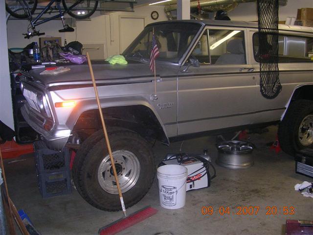

It is now a completle rolling chassis

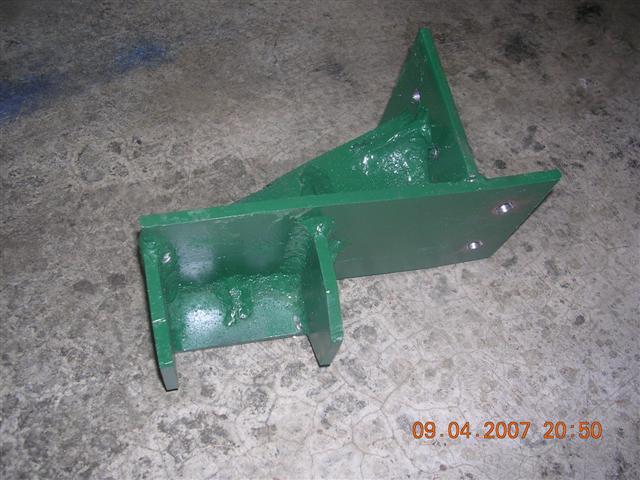

The front has a total of 6.in lift and the rear will net around 7
I finished up new rear shackle hangers to perform a shackle flip
I know i'm missing some small stuff but heres some pics:awesomework:
