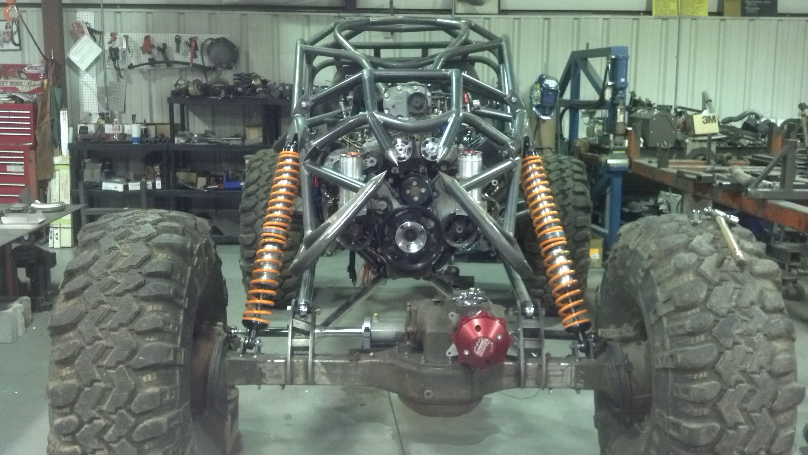

Got coilovers on and rear 7075 aluminum links on

Looks like the top link bars are behind the centerline of your axle. I have seen axles spin upside down when the shocks stretch out. I hope that makes sense hopefully you will be fine with a center limit strap.
I agree. Doesn't look like much link seperation at the axle either, that will be rough on links controlling all that weight.
You r looking at the rear it is in front on the axle center line and it is 9 1/2" between the two joins
