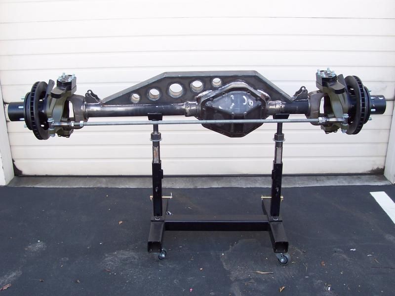

Keep browsing around at Bronco 2 builds and getting ideas on how I wanna do mine. Here is a few pics i've gathered and got some idea's from.
Re: Re: V8 Dana 60 bronco 2 build
Figured the front 14 bolt was a cheaper and stronger route. Still running a welded 60 in the rear tho.
