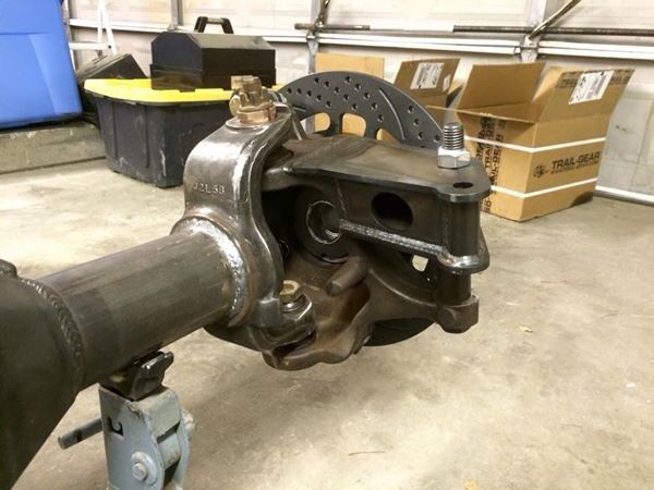

Jess Haines builds some nice **** for those SD knuckles
