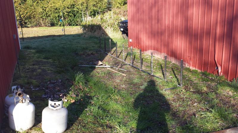

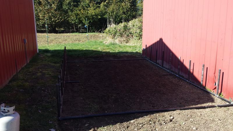

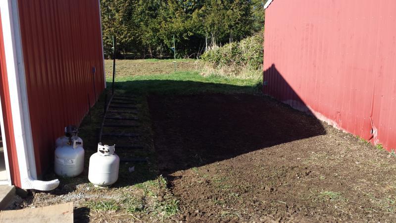

I started prepping the ground and after 5 mins of trying to do it by hand I grabbed the tractor and got it done allot quicker. It was already pretty flat but there were a few humps I was able to work out....
Got the bases layed in place and made connecting pieces that tie the 2 half's together.

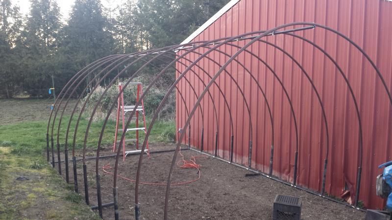

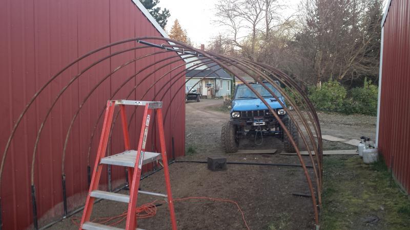

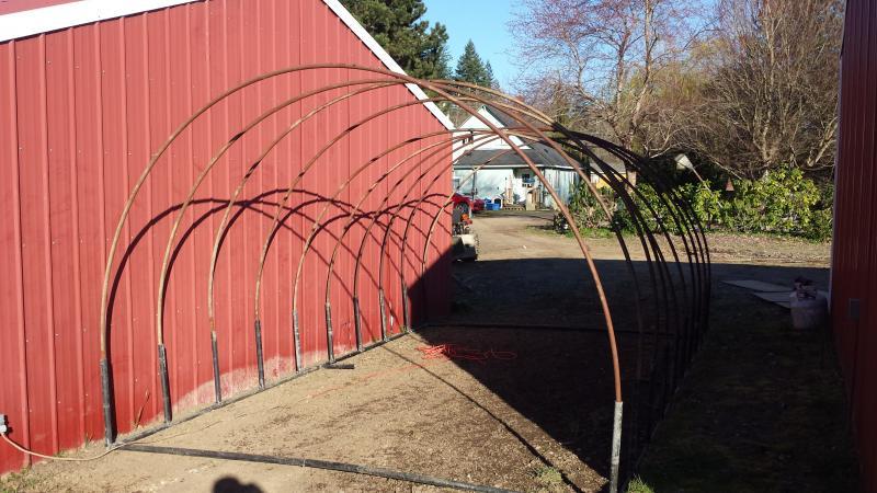

And got the hoops roughly set into place.. I need to adjust them to where I want them and get a 2x4 for the top support next. But its looking like something now..

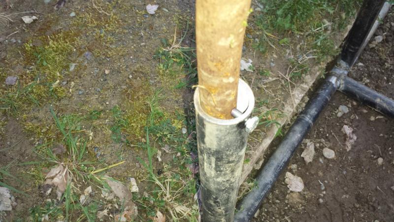

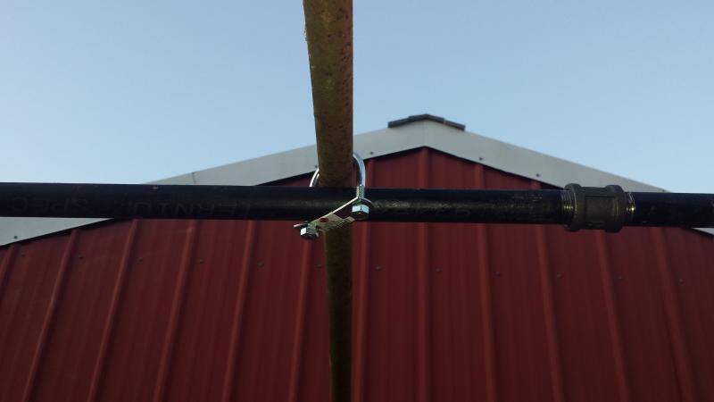

So I ended up getting some 3/4 water pipe since I didn't have anything laying around that would do what I wanted. I also grabbed some U bolts and up to $65 out of pocket.....
So To secure the hoops in the base I simply drilled and tapped the base tubes..

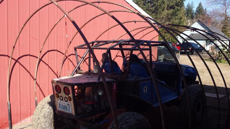

And the frame portion is now 100% done... Almost there...

If we ever get a good snow again it will be hard to clear it off the one side. Other than that it looks great!
I like the structure, but agree that snow is going to wreak havoc. You don't want the weight pinched there between yer buildings..
