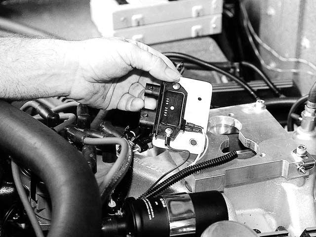

The ignition control module translates the distributor's pulses and alters the timing. You must use a magnetic pickup-type distributor with this system, and the advance must be locked down with the proper phasing. The instructions explain this in great detail, but if you ask, Turbo City can make the necessary adjustments to your distributor.
Does you distributor have a magnetic pickup? You only lock down the vacuum/mechanical advance if you do this magnetic pickup mod to the distributor.
Yeah, the factory '77 distributor is a mag pickup style exactly like what is pictured...

Guess I should have just asked if it has one of these?
Something I just noticed is that in the background of that last pick there are clearly two ECMs. I assume you only have one?
Yes, only one ECM. The article explains that used two cases on that install for better protection from the elements...
