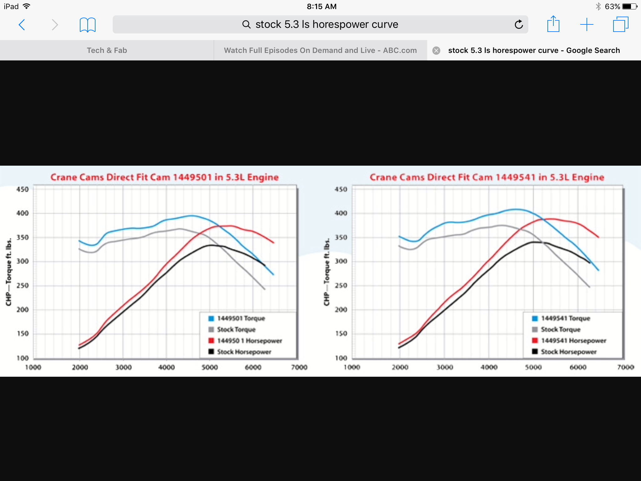

I was wondering how much power there was to be had on these engines close to 7k? I figured it dropped off significantly, in stockish form, after 6k.
