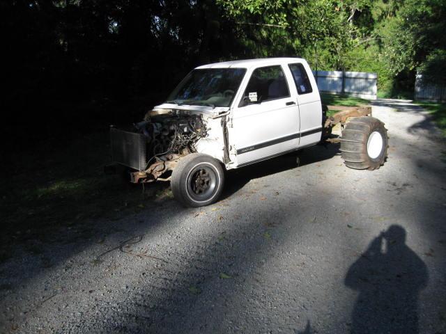

Fill the front coils full of tennis balls.Give ya some nice landings off jumps and the big woops.:redneck:**** works good!!
OK out with the 4.3!!
I have a few goodies to put in place of it.

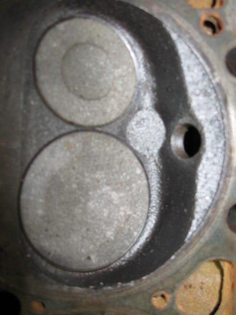

The heads are 2.02/1.60 64 cc chamber ol school camel hump chev muscle heads. They have had hardened seats put in them. They have guide plates and biggass studs. I am tossing a big cam in it too.

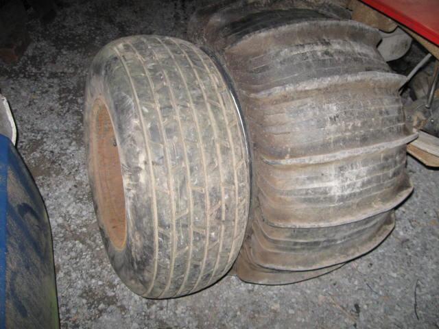

I got some new front tires. The guy I got them from says there off of an airplane??
They say "special purpose" 11.00X15 on the side.:cheer:
