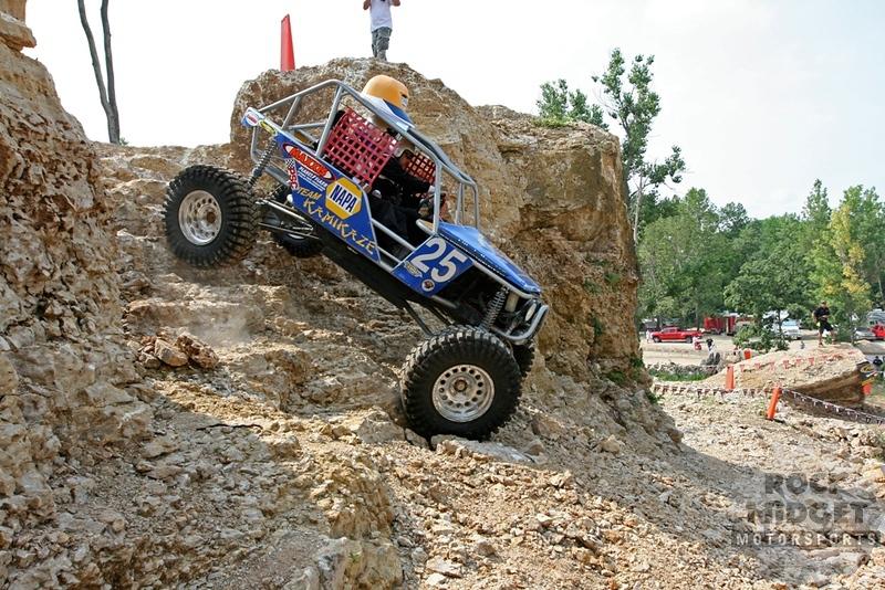

This is an example of a window net that I think is technically doing its job on paper and has passed tech to race, but if called on for use, it will fail, and you risk injury. This would not pass tech is on a stock car, roundy round, etc.
Here are mine. Maybe mine are overkill. But not only will my appendiges stay in the car, they will keep everything out. Like a big rock if you flopped onto it, and it wanted to protrude through the window. I tabbed the top bar and bolted it, the bottom is the Speedway latch mount kit.
You can kinda see mine is this pick of Bones that Nolen took. The tabs and bolts on top, and you can see a small hole at the base of my "B" pillar. That is were the bottom rod sticks into. On the front of the bottom rod is the latch mechanism.

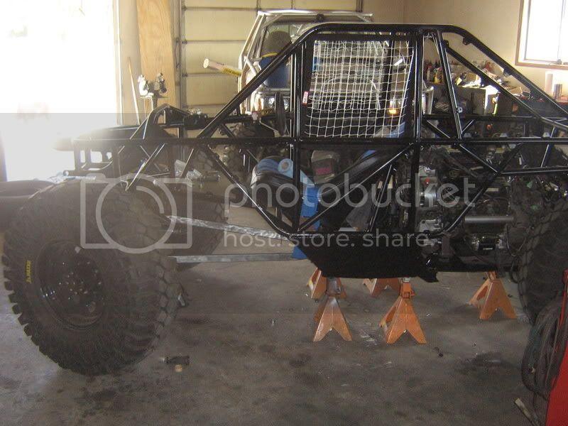

make sure to check mine out over labor day
lower tabs parrallel with tube and flush
upper ones are nice and round and tucked up in corners away from the noggin
