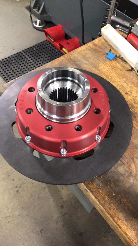

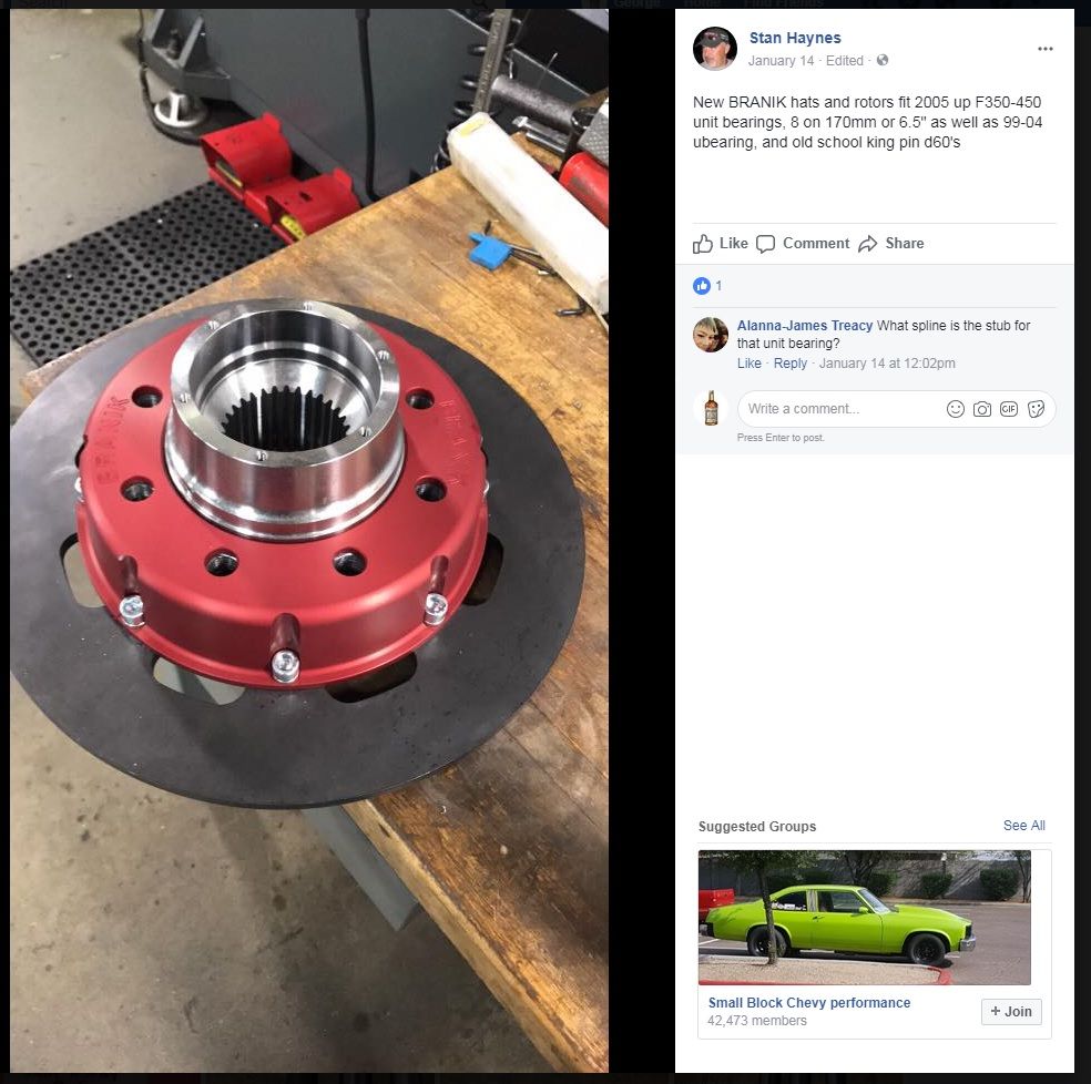

Might be worth working a deal with Branik depending on what the cost of these are. From Facebook...
New BRANIK hats and rotors fit 2005 up F350-450 unit bearings, 8 on 170mm or 6.5" as well as 99-04 ubearing, and old school king pin d60's
Those are sweet BUT then we're back to aftermarket calipers, etc. Just trying to stick with parts store stuff on this one if possible.
